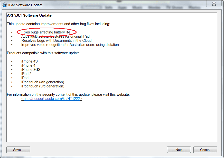

Old Frankie wasn't so dumb after all.:rolleyes::D lol. As Rocky indicated in the iPad owners thread there is an update concerning battery life. I wonder what prompted this update?
I have not been aware of battery issues with ios5 on the iPad; the complaints have been on the iPhone

The 5.0.1 OTA update to 5.0 is out for iPad as well, and it does a few things beyond battery issues on the iPhone. On the iPad is permits multi-touch gestures on the original iPad 1. Pretty small update - about 39MB. Took about 5 minutes to install.

Frank, my point was that even though they claim it is to resolve battery issues, I had NOT HEARD of any battery complaints on the iPad with iOS 5.0, nor had I experienced any. I know I explained in the posts what the stated reason from Apple in the release notes was for it, but I just have not heard any complaints from any of the usual suspects about iOS 5 draining the iPad. :)
