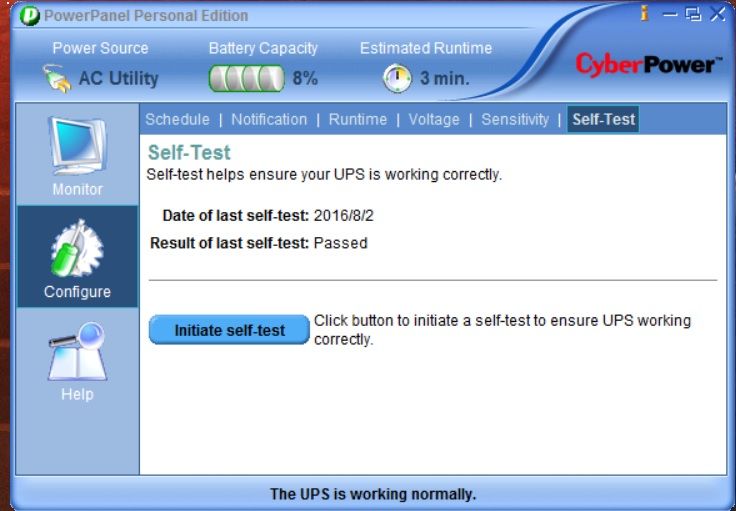

right now i have "Cyber Power" Brand, i keep the UPS plugin all the time, the front light only come when the power go off, and its shows low Batteries, the only thing it does right now my house alot of a little power problems, and it helps with them but if big power outage my computer goes completed off! i took a picture but i just ran an test that why the numbers are so low

8% is certainly low for a fully-charged battery. The test doesn't take much out of the battery as it only lasts for a few seconds.
