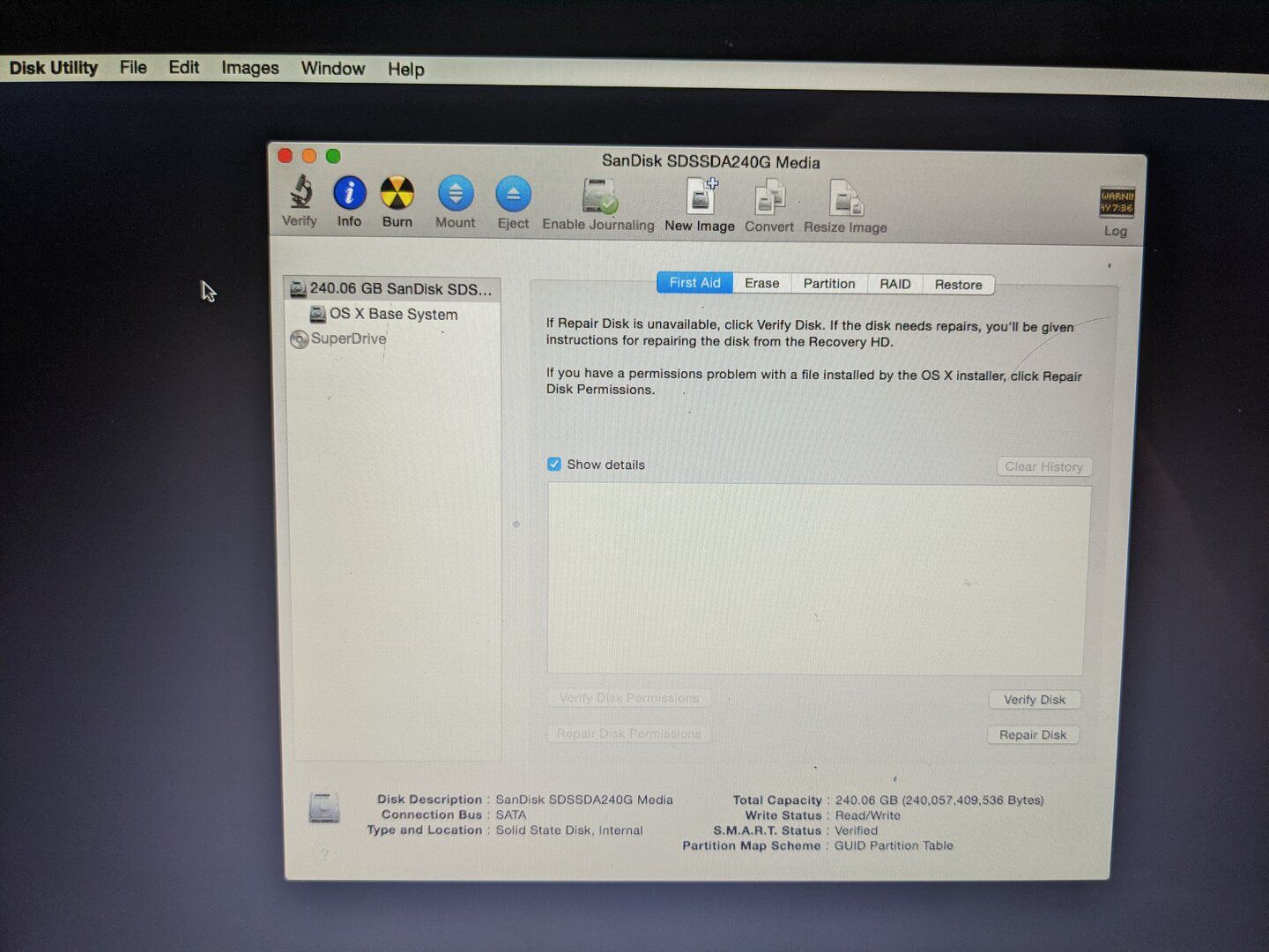

Hi friends . . . I am not an Apple person and have little to no knowledge about them. My friend's mother acquired an old MacBook (2010) and was hoping I could restore it. I searched and searched online, but most sites just led me down a dark hole lol I am in Disk Utility and tried restoring the OS but got a disk-locked message and cannot proceed. One site I found said I needed to create a Partition of the HDD, but all my options to do so are unavailable/greyed out. Any tips other than tossing it lol no seriously I like to try and figure this out :)

Click on OS X Base system, you should be able to do it from there. :)

Thanks for the quick reply . . . okay new issue . . . I was able to access the Install OS X and now it wants me to sign into the App Store. Obviously, I do not have an account, so . . .?

So create one. :) Might have to use a different computer. Been about 10 years since I signed up for the App store so I don't remember what I had to do to crate an app store account.

Sounded simple enough . . . I received the message "This item is temporarily unavailable" after I signed in. I am assuming OS X Yosemite is not available in their app store anymore, so what can I do now?
When doing archaeology digs, a web search is often your best bet. Apple is fairly dismissive about supporting ancient hardware.
You can download images here:

Thanks and I found that page as well during my archeological dig. The issue is how to get the OS onto the device.

A Macbook of that vintage should have a USB 2.0 port or two.
Specifically what model are we talking about?
