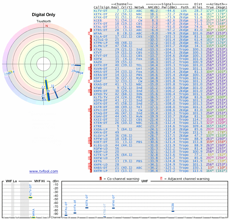

check your tvfool report and see what that says for distance away....
TV Fool
even at 40 miles a good antenna can get them fine....and you may get stations not available to you normally

Here ya go! These are the locals I would be most concerned with getting in HD OTA if possible. I really appreciate the help!!
TYLER ABC-KLTV
TYLER CBS-KYTX
TYLER FOX-KFXK
TYLER NBC-KETK
oh boy.....couple thoughts
-outdoor antenna would be the only option honestly...with the distances you need to go any obstacles will hinder the signal
-the good thing is the NBC & Fox are at the legal allowed power of 1 million watts. So that helps get the signal further
-CBS may be a lost cause.....73 miles is really pushing it....and 73 miles on a UHF station doesn't help either. I can get a VHF station 72 miles away really well (VHF signals go further than UHF)
For height did you put anything in there or just left it blank? At these distances the higher the antenna can go the better. As for what antenna to get I would ask in the OTA area. There are some folks who really know their stuff. Just post the tvfool in there and they can help.
Thanks Tony. I was a little shocked when I saw that the tower for CBS was 73 miles away. It's odd because I know where that station is at and that have both their uplink dish and antenna right in front of their building, and I know it's about 50 miles as the crow flies from my house.
