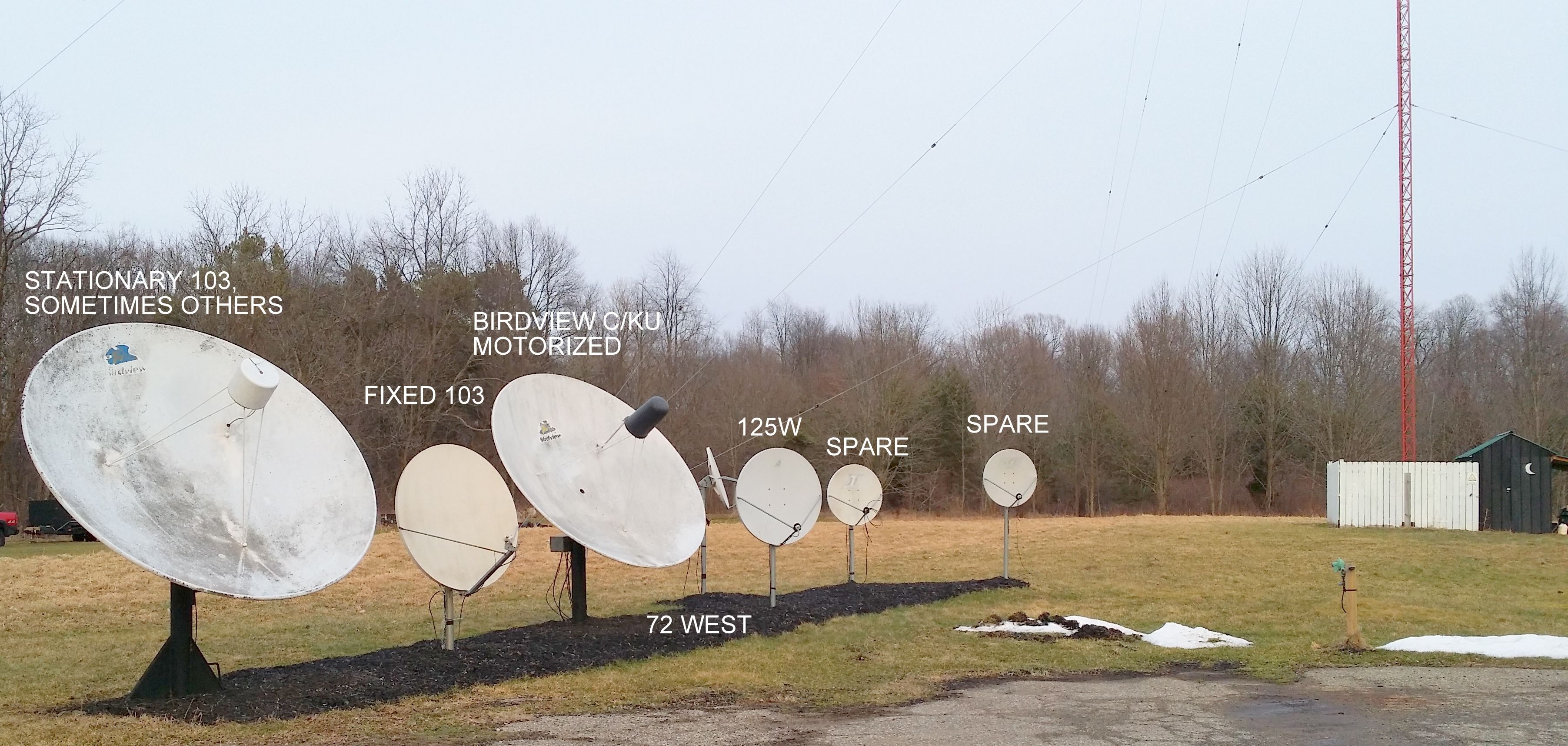

The dish farm at the radio station apartment for FTA contains quite a mix of dishes, see the picture attached.
For the LONGEST time, I've fought and fought trying to get the left stationary birdview to play nicely with the rest. I've got an 8-place Amiko diseqc selecting any of a possible 8 feeds. 1 and 2 from the c/ku on the movable Birdview; number 3 (the trouble child) being the stationary (left) Birdview, then 4 is the cozi dish between them, 5 is my 125 PBS, and 6-8 are reserved for 72w NBC, and a spare line.
I've written before about how a "ghost" of the very strong 101 appeared any time I tried to use the stationary Birdview dish. Never could get the actual left birdview signal through the diseqc. It was as if the #3 feed from the left dish didn't exist at all, but rather just played the strongest of the inputs from the movable one. Whatever it was parked-on at the time.

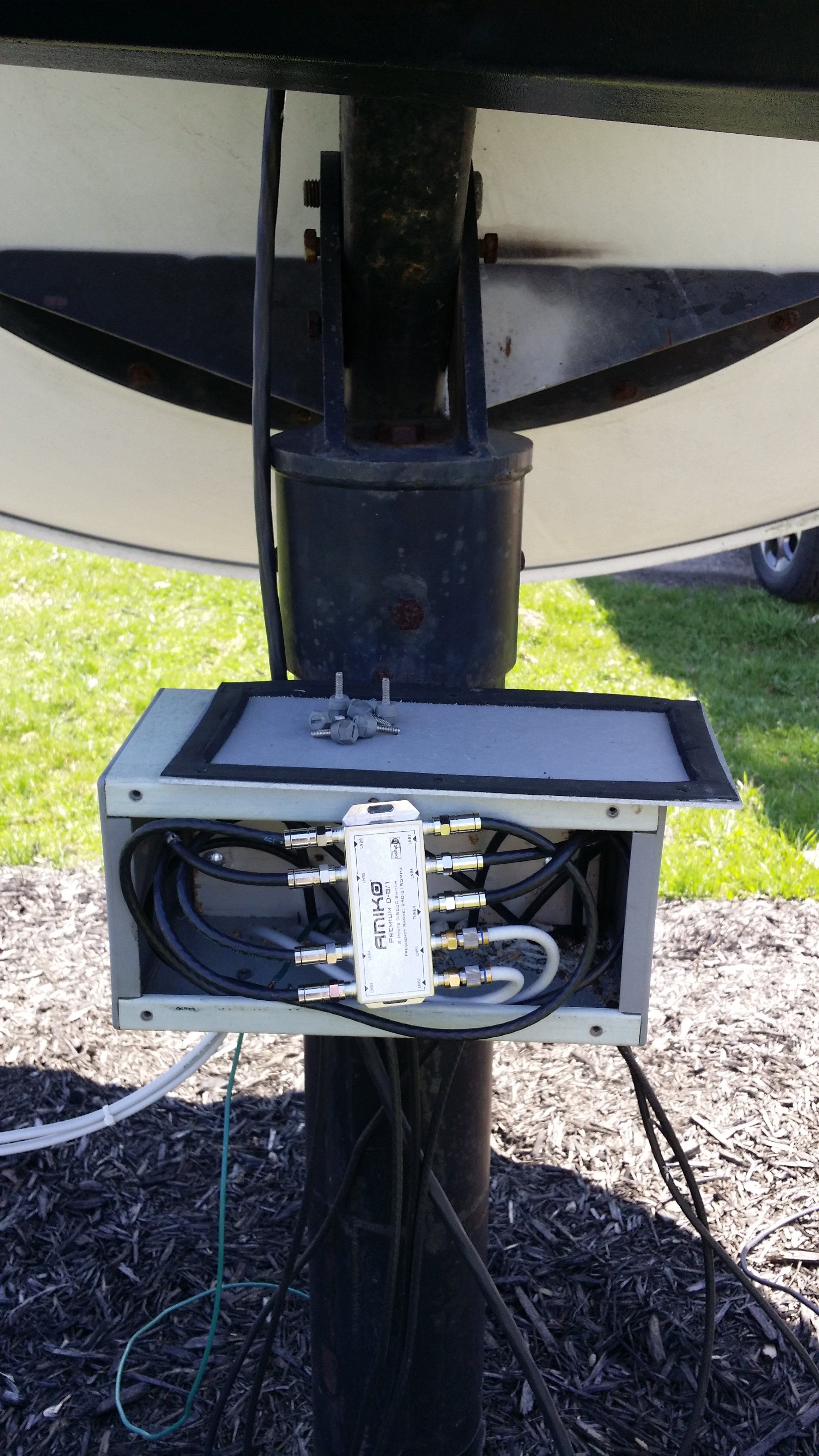

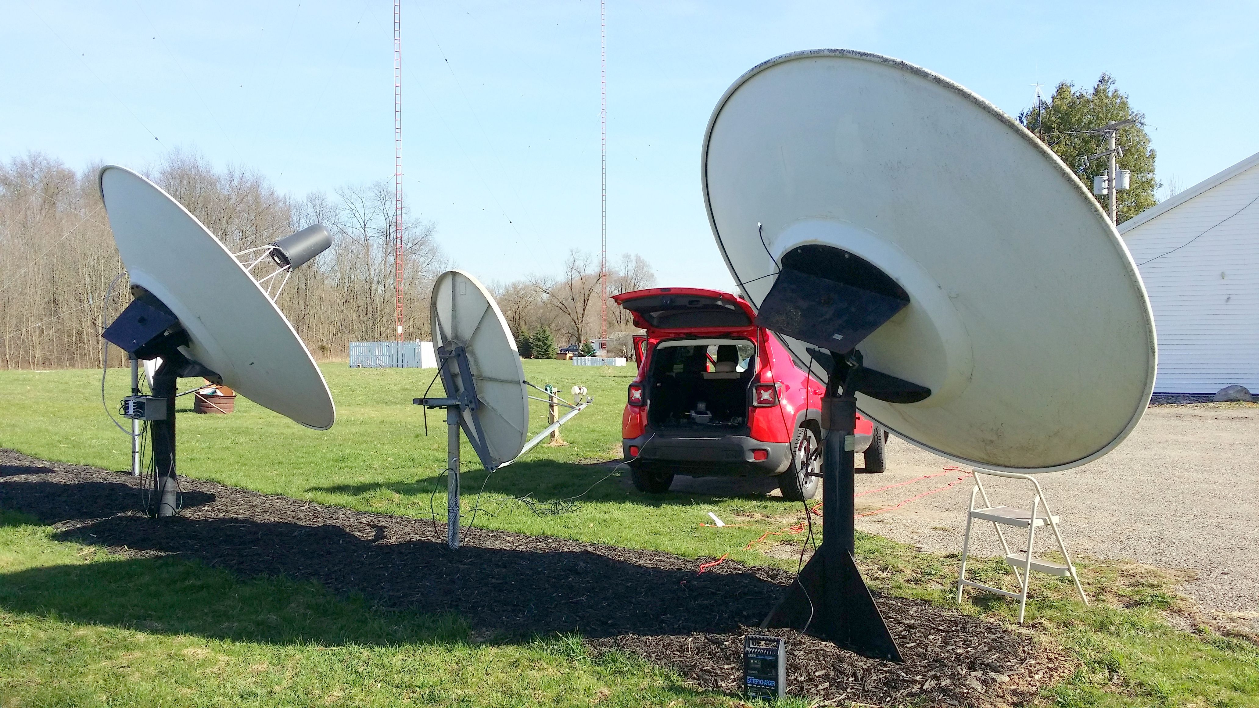

Today I solved that problem. I took a small monitor, and my spare microHD receiver out in the Renegade to directly connect to the stationary Birdview. With a 2-amp setting on an automotive jumpstart box, I was able to power the motor manually and hone in nicely on 103 west for networks, but upon hooking up to the diseqc which feeds to the apartment, issues arose including pixelation, or no signal at all. The same thing happened when I aimed the same dish it at the very strong 99 west. The odd thing was, this dish has new RG-6 last fall, new connectors, and obviously a known good LNB... and only about 25 feet to the main junction box with the diseqc, (mounted below the motorized birdview.)

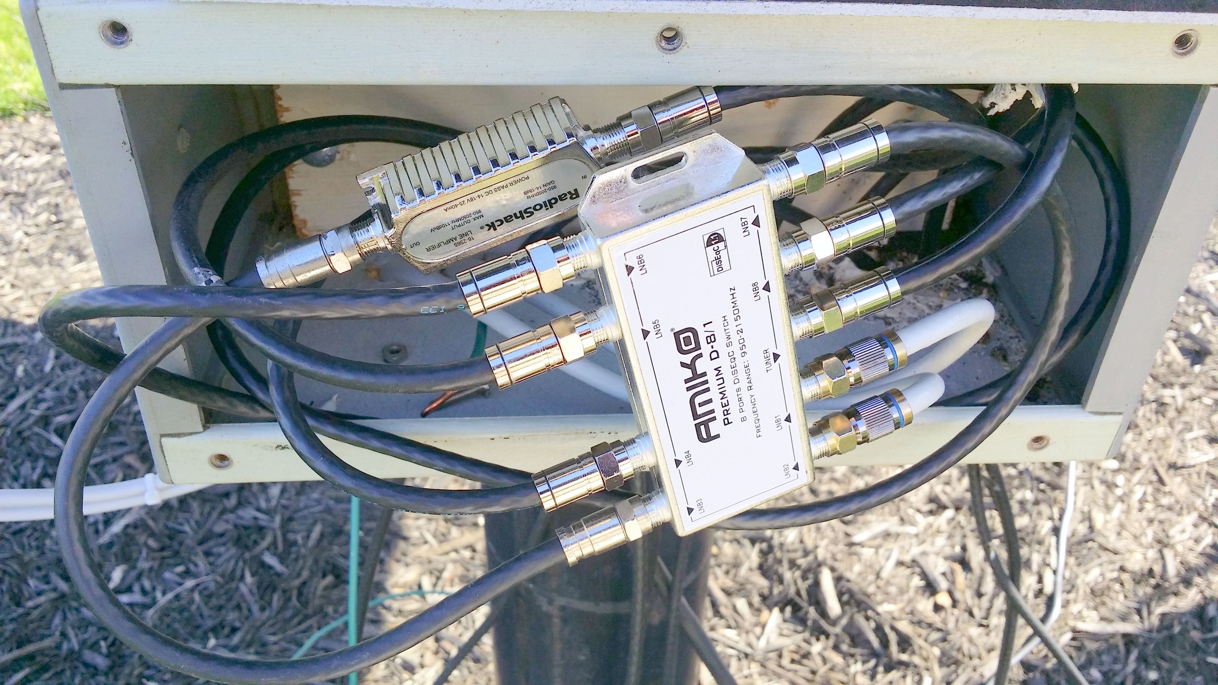

With signal very strong when directly connected to the test microHD, ...I did the unthinkable. I took the new in package 50 cent garage sale satellite inline signal amp, and put it on that line only, at the input to the diseqc. After that, signal became crystal from the stationary dish became clear in the apartment, no pixelation. Putting the amp on that line only means we're not amplifying every LNB's signal, just that troubled one. I also learned that that signal hunting is best done first without the amp, then add the amplifier it as needed. If the amp is inline during signal tweaking, adjustments make NO sense and are not easy to pinpoint.
So, now the movable Birdview Will do most of the heavy lifting (needs a new Titanium positioner unit...V-box stutters and stops then restarts frequently. ) and we have diseqcs doing their jobs on 5 inputs quite nicely from 4 dishes. Tomorrow, with good weather, I'll continue and try to align the remaining dedicated dishes....

I read many write-ups here about not using line amps before trying this today, then thought, "why not try!" Granted, it will pull a small bit of current, but it did solve the problem. Total cable run for me is around 100-150 feet depending on the particular dish, with the diseqc inline. Will dig deeper in to the cause of the signal loss later, but..at least the band aid is on the system.
Next weekend will be hopefully getting a Winegard dish from a friend, probably an 8 or 10 footer? with an edge bent from a forklift...I think it can be gently pulled back into shape, and will make a nice fixed dish for 99 or 101,and another house in town has a 6 foot dish on their junk pile with only minor panel repair needed I'm going to try to grab for the same purpose. I'd like my regular satellites which I use to be on fixed dishes, and the "occasional" ones to watch on the motorized birdview.
When I was playing with the left Birdview, for a time, I put a combination C/Ku in place and was able to pick up the beach cams, and some other channels with good quality, but on the MicroHD was unable to input or scan the Cozi signal properly, but there is hope...if I reinstall a combination LNB, I can free up that fixed Ku dish now aimed at Cozi for some more fun. Either the scanning on the MicroHD didn't work properly (frequencies didn't look right) or...even the new signal is rather elusive. I thought a 70 percent quality on both the C and Ku was pretty nice on 103! To do that, I had to use a 22khz switch, but it worked fine on the test box.

Could it be that the LNBF is weak output. Producing only 30db gain vs a 'normal' 60 - 65db or
the #3 DiSEqC port is lossy, at IF freq, but passes DC OK?
I suppose it could be! Never really thought about that...I'd vote for the LNB issue first, we've tried multiple diseqcs with the same result until today..
It might also be possible that the inline amp may be affecting the port input by filtering or isolating.
With a multiple dish system, also check for proper grounding and bonding. Switches often go crazy with voltage potentials.
Does the switch issue happen if the LNB is swapped?
If dishes are swapped between the switch ports, does the issue follow the port or the dish?

Jim, is each dish grounded separately with a ground rod? Is there a grounding counterpoise for your AM transmitter close to your dishes? Just thinking you might be close to one of them with one of your grounds... which might cause extra RF currents.
Interesting how this works so close to a high power transmitter, with potential RF at each connection. I have had fun here with transmitters at 1890, 3750KHz and 10.151MHz but these are relatively low power and only intermittent. Sometimes random switching components around, cables, etc (trial and error) can come up with results that eventually lead you to the right direction to go in the problem solving flow chart.
If you are ordering an ASC1 you'll have to get Brian to add a couple new LNBFs to the shipment so you have a different one to try and a spare. :)
Good points, and good practice on the grounding. We could, indeed ground each hookup, the poles are all "in ground" ....except...the trouble one...is an original Birdview tripod used on demo trailers, installed on a pad...hmm...never thought about that difference on that particular dish....it has no motor wires, only the RG-6, so that may take us back to "grounding" that line where the line amp is now...per Brian. I hope to order a new positioner as soon as I empty more "stuff" from my collection in the back room via Ebay, Craigslist, and on satguys, can't wait to have a positioner that really WILL drive a birdview without saying "oomph...I can't move all the way without stopping"....
