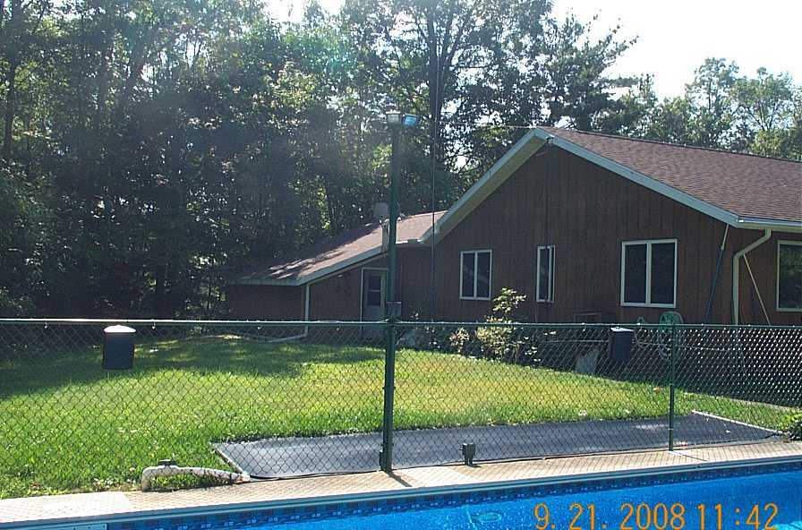

charper1, drumboy3317 (Welcome, BTW!) and others - I did receive and finally install the AP650 speakers. Note that these are 1 model above the ones charper1 originally linked. I went with them primarily because I wanted black and the 640s were sold out in black.
http://store.outdoorspeakerdepot.com/apprspp.html
The 650s have a small bass port (about the size of the tweeter) but otherwise seem to spec. out about the same. The cabinets have a swivel bracket mounting, most appropriate for mounting under an eave. But they also have two bolt holes on the rear that take the same knobs as the bracket mount, so I made a simple hook out of some matching coated fence wire, looped one end around that knob in the top hole (about 3" down on the back) and the other end over the horizontal fence rail, and...voila!...instant mount! I may come up with something more sophisticated, but this works fine and is very easy to take down. As a result of this mount, the speakers are in a vertical position which is probably the better way to use them. And as gravity would have it, the weight distribution causes them to lean slightly forward so they are tilting down toward the water maybe 15 deg., exactly as intended! The binding posts on the back take either the direct wire (as I did them Sat.) or a banana plug, which I will provide for "quick disconnect". I have them currently running out of the "B" speakers on my Sony 5300 receiver, through about 75' (!) of 18 ga. wire to each one (best I could do without a lot of contortions!) through conduit, to a pole mount, and from there along the fence rail to the speakers themselves. Inside the house there is a 3-amp fuse in series with each of the 4 wires.
I have yet to figure out all the setting possibilities on that receiver! The A/B/A+B speaker switch on the receiver essentially allows me to have 2 separate pairs of speakers for the fronts and choose accordingly. That means that in most configurations the other 4 speakers are live as well (center, sub, and surrounds). I configured the sound field to give me just 2 channel stereo, then by choosing "B" only I get sound through those outdoor speakers only. But I can't say yet if that is full range audio since I have the receiver configured to treat all the speakers except the sub as "small", and I am crossing at about 85Hz. So I may not be getting all the frequency range to these speakers in this configuration.
For my tests this weekend I played only the outdoor speakers (tho' I can have the sub in the house active as well, and that was very interesting!) I played a variety of sources but concentrated on my SACDs set for 2-channel only. Since that signal is coming from the multichannel inputs it might still be SACD, but downmixed. I have one SACD that is 2-channel only, so that will be a good comparison when I can get to it. But with speakers this size, CD vs. SACD might be moot.
First impressions are positive! They are bright, clean, and have a good "attack" even with that light gauge wire! My only disapointment is that they are volume limited. It is easy to crank them too high, and since they are out in the open (no walls to contain/reverberate the sound) then they are challenged to meet my max. level desires. But in fact that would be a level I would rarely want to use when I am anywhere near the speakers, so I am not that unhappy about that one characteristic. The bass is limited, but that could be a result of the crossover setting. I'll have to set the fronts to "large" and see what difference that makes. But I really don't expect much more from a speaker of this size. If I want more bass, then an obvious option is to run the house speakers at the same time, at least the sub, and leave the doors open! (No neighbors to complain!) One thing I was not happy with is that when I am in the A+B mode, the outside speakers are quite low in volume as compared with the indoor ones. That could simply be a result of their efficiency as compared with the Paradigms, and/or that vast length of light gauge wire. But there won't be too many occasions when I want both running at the same time. An obvious option there is to simply provide a separate amp for the outdoor speakers, and that would solve the crossover issue as well.
As luck would have it, it was raining a good bit on Sat. afternoon while I was conducting my listening tests. That didn't seem to matter to these speakers at all! The water rolled right off and there was no evidence that anything was entering through the grilles. I have some concern about the exposed banana jacks (they are in a recessed area, where the speaker line-level switch is also located), but that should be easy to fix when I contrive some type of all-weather covers for them, as mentioned in a post above.
So bottom line - for about $145 delivered these are a good speaker for my purpose and should serve me well. At this point I have no desire to look for something better. (For higher sustained volumes I would probably want something that can handle more power.)

UPDATE - They AP650s sound better in "Large" mode...
Well I finally got to tweaking some system parameters last weekend and set the front speakers to "large", which directs more bass to either the A or B pair, the outdoor speakers being the latter. (I don't know the crossover point or equalization yet - I didn't adjust either.) Immediately that had an impact on the sound from the AP650s and they sounded a good bit better. Surprisingly this did not hurt the max. volume level at all, if anything improving it. I have more playing around to do, but so far so good!. Here's a picture of them hanging on my fence. Other items of interest to SatGuys regulars appear in there as well, tho' harder to spot...! Have a great weekend all!
