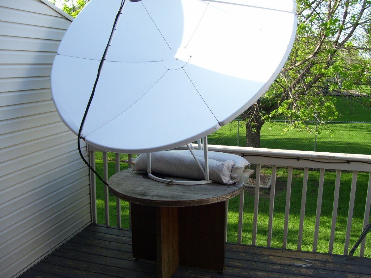

those poor 6' dishes live a rough life, Iceberg's fell off a table on his deck. Bent it pretty bad.
Those stands or 3 leg mounts are not very stable.
mine was bolted TO the table and it tipped the table over. Being so far north its very top heavy
Now its on a secure table (where the T90 dish was)
With the dish held down with weight it can be very stable. The stand needs to he held down, because with the reflector it is top heavy. I use cinder blocks, 5 of them, and it held it in place since last year. I have it on a wooden shipping palette, but it needs those cinder blocks to stay steady. It was on the wooden palette when it fell down the ravine, also!
With the Fortec 8 footer, I have the same setup, except instead of cinder blocks I have slate rocks. I used them to make a level platform for the wooden shipping palette as well as put them inside, to weigh it down, as well as put more slate rocks on top holding the dish down, like the cinder blocks are holding the 6 footer down.

here is a pic of the C-Band on the table....before all the snow
