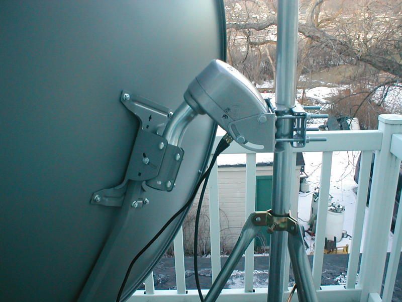

Thanks, my only problem is i have an HH90 stab motor and I'm wondering if this is ultimately my problem. If i can ask one more ? could you look at the pictures that i posted earlier and tell me if the brackets on the back of my dish connecting to the motor are the same as yours.
THANKS
:flag:
The principle of the arch correction should be the same process though. Look at what your path is , High east and west or low east high west etc. Pick which one fits your situation and correct accordingly to the examples under fine tuning. It's worth a try at least. Here is a pic of my mount. Later , Mark:up
