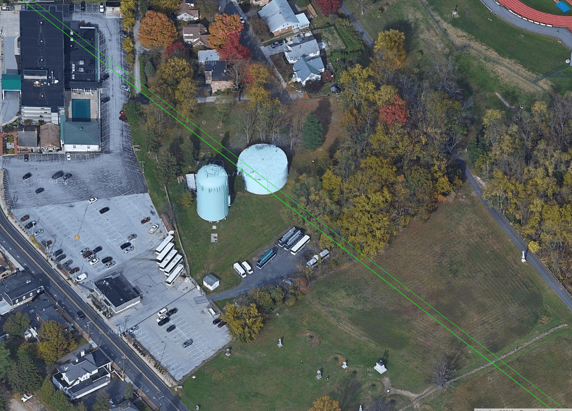

Here is what I have one mile from my house when I look at Baltimore. The taller water tower is loaded with cellular antennas. When they went active in 2013/2014 it destroyed WNUV(40), WBFF(46) and WDCW(50). WDCW looked like a scrambled porn cable channel form the 90's. The LTE filter fixed me up, originally from radio Shack, now Channel Master.
