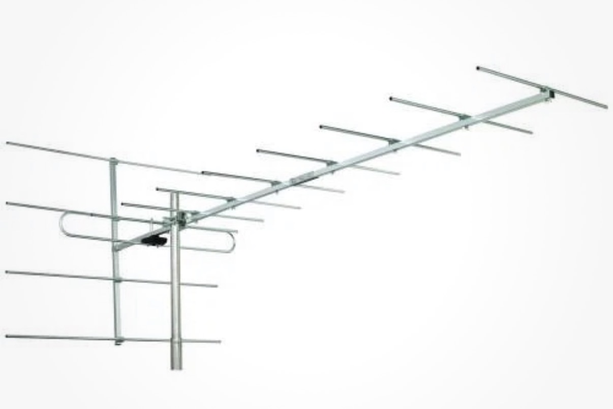

This is the original:

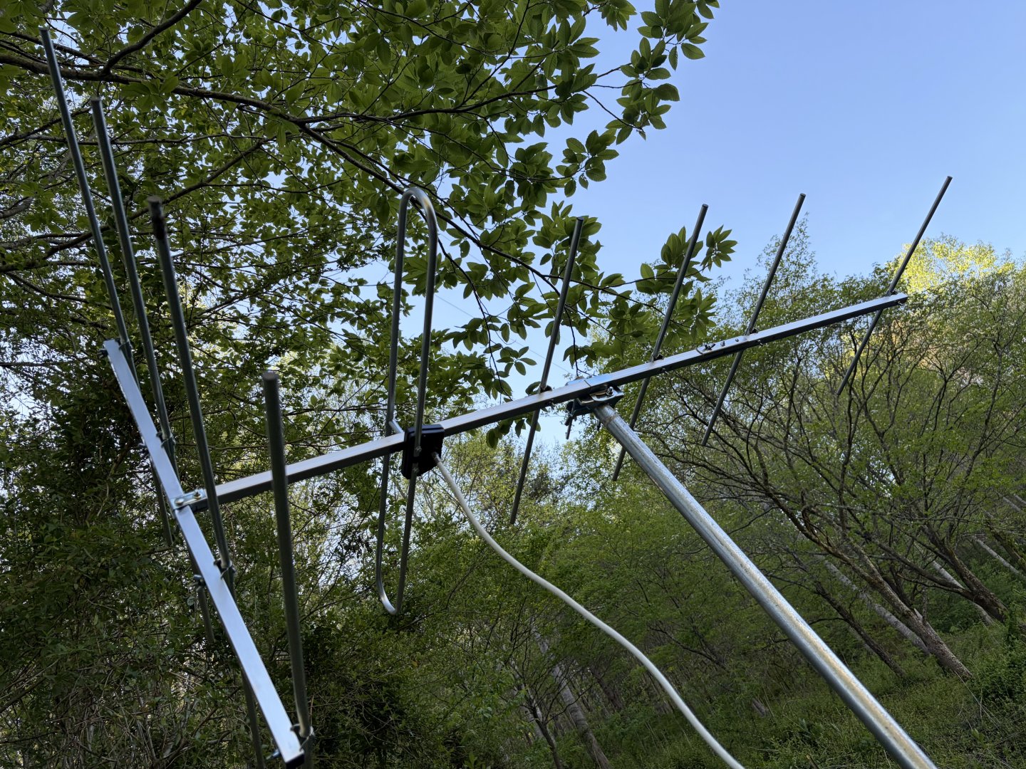

And this is the modified version:
Sorry, it's sideways, but it's the only picture I took.

Looks like you reduced the number of directors from 7 to 4. I would have thought that would reduce the gain. Maybe that is what helped. Sometimes too much gain can make the signal too hot and can also make it more prone to wind. Did you change the size of the folded dipole or the spacing of the 4 reflectors?
I didn't change the dipole. I did change the spacing on all the elements; driven and parasitic. I posted a list of all the components I scavenged on ChatGPT and it told me where to space them for channel 12. It must have worked since my signal strength and stability both increased.
