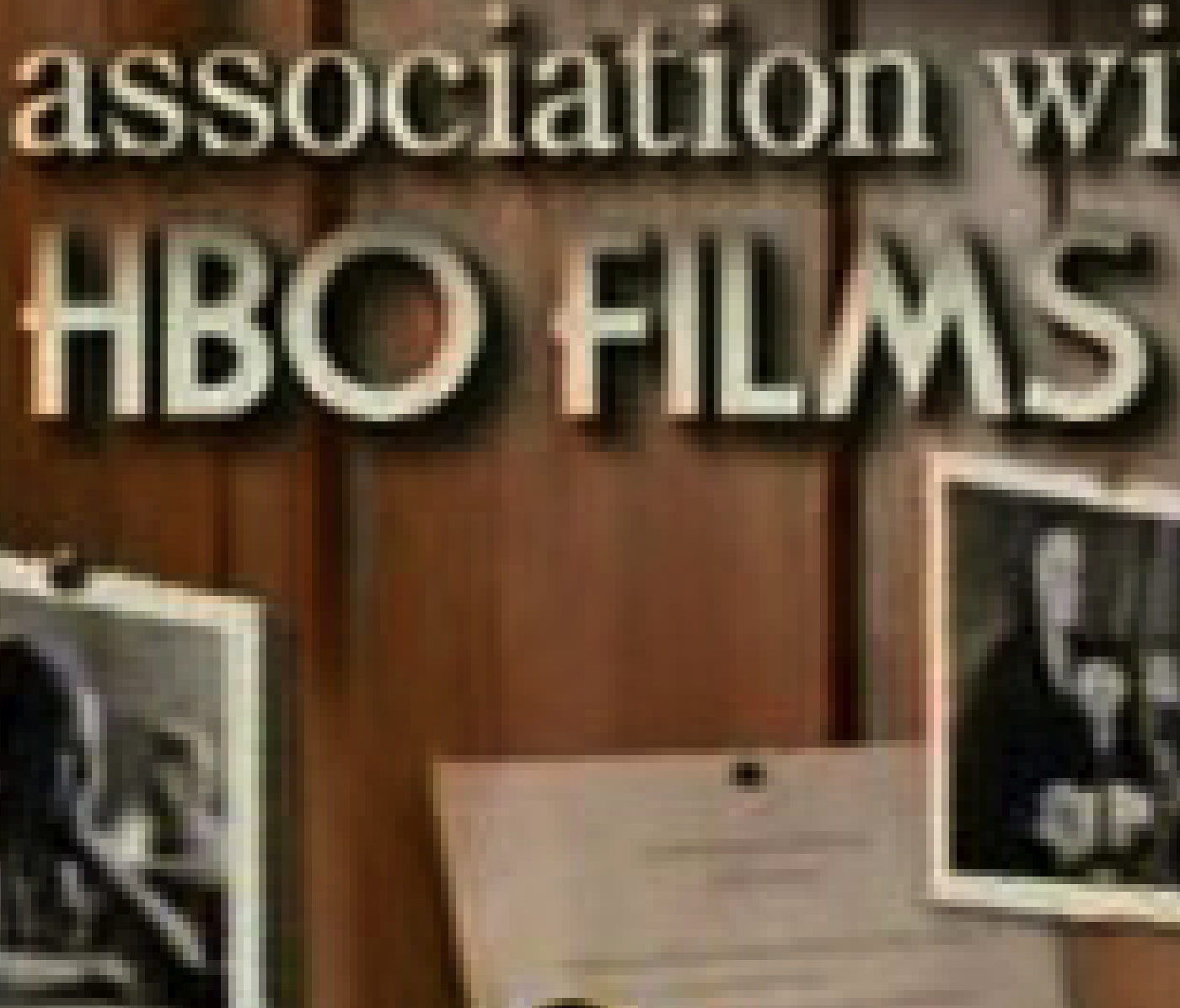

Now we get into the nitty-gritty. The camera was slowly panning across a static scene, so this is not quite as easy as the absolutely static shot in the first post in this thread. Nevertheless this is not particularly challenging except for the detail. I zoomed 300% on a portion of each HD image, and 900% on the SD images, which is the equivalent. The order is the same as in my immediately preceding post.
The DN HD isn't too bad, but one can certainly see more mosquito noise than in the master feed. There is also some detail loss overall, see for example the wood grain immediately to the right of FDR.
It was interesting to compare the simulated SD feed and the upscale. While the two have the same effective resolution, it may be a matter of personal preference which 'looks' better. The non-upscaled version may seem a bit sharper because of the more distinct edges, but the upscaled version is smoother. The bottom line is neither of these highly idealized images is at all competitive with the real-life DN HD-lite.
I won't spend a lot of time on the DN SD frame. The colors are washed out and the edges very ill-defined, but it's closer to the simulated SD 'master' than the simulated SD 'master is to DN HD-lite.

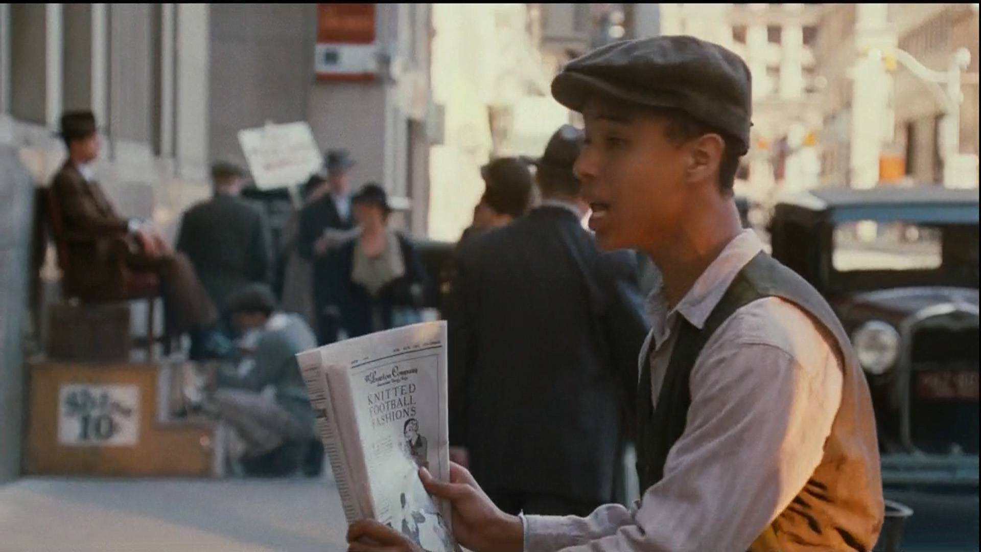

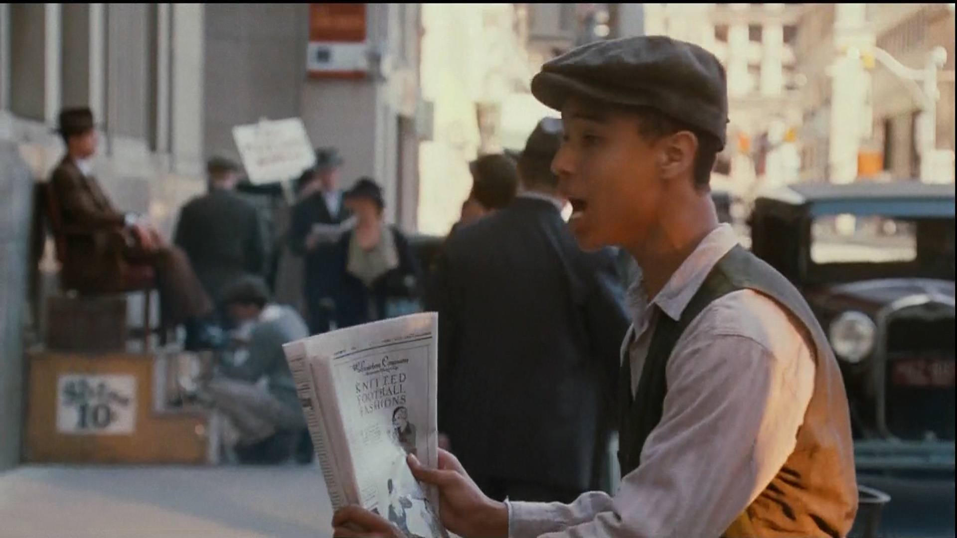

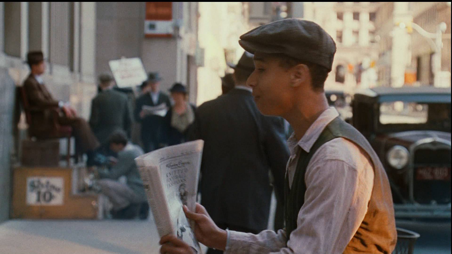

Motion comparisons

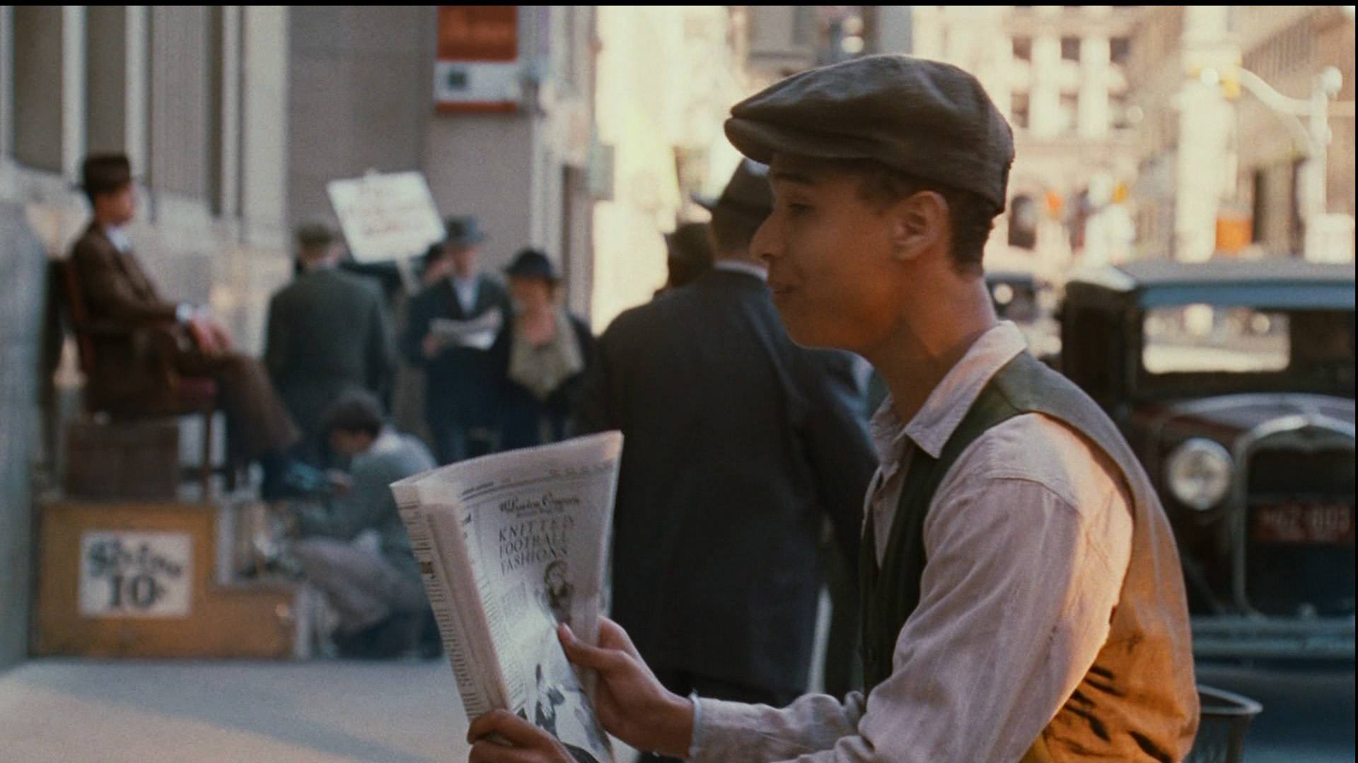

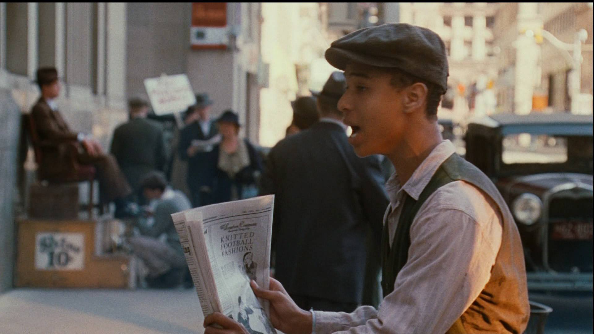

I'm going to perform one more comparison for the moment, this time with some motion. I suppose I could find a gross example, like basketball or football, where I could find and incredibly high rate backhaul and compare it to a DN uplink. In HD I'm sure the latter is often horrible, if not nauseating. But I don't find watching sports on a SD master any more involving.
So I found a short sequence where a newspaper hawker is waving around a paper, where the type is somewhat legible. This is the same movie where I have previously compared the title sequence frame. This example does not have a ton of motion, but it makes analyzing the detail very easy. I didn't bother with any SD, DN or simulated, partly because of the amount of frames that would be needed, and partly because there is no detail to compare in the first place.
In this post I only present a sequence of frames, alternating for each source, with the 4DTV HD master feed being the odd frames and the DN HD as the even. A few intervening frames were omitted that contributed nothing to what has already been shown.
With some motion, the DN frames are suffering more. Compare not only the type on the newspaper page, but also the detail in the hawker's face. I'll post some zooms to make the differences more obvious in a following post.

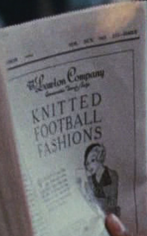

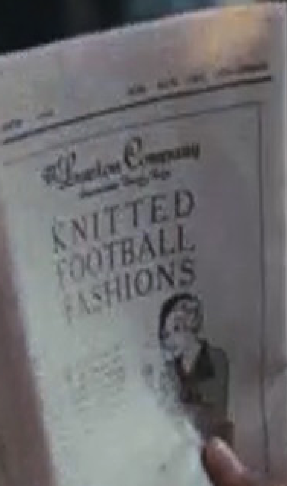

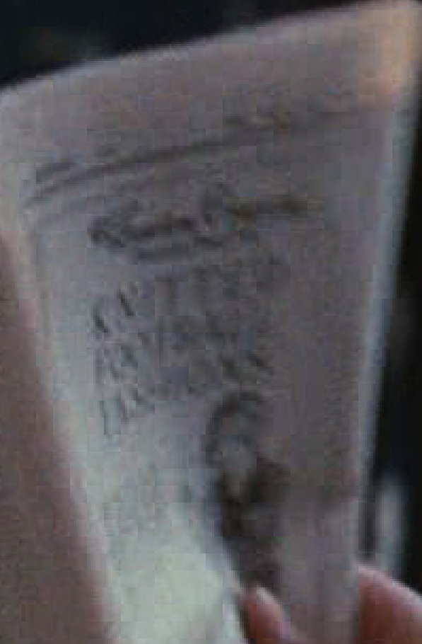

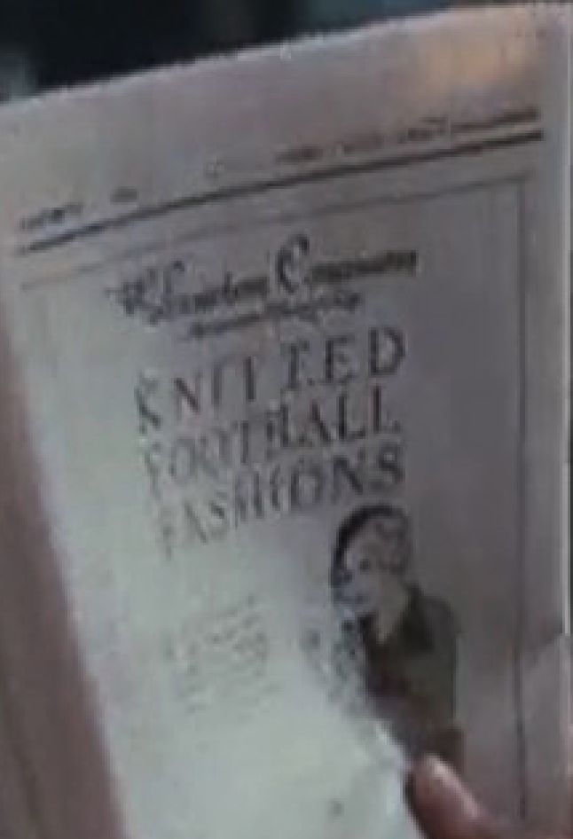

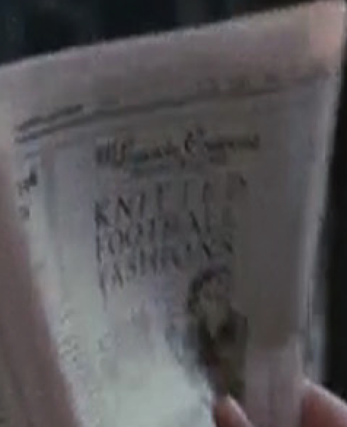

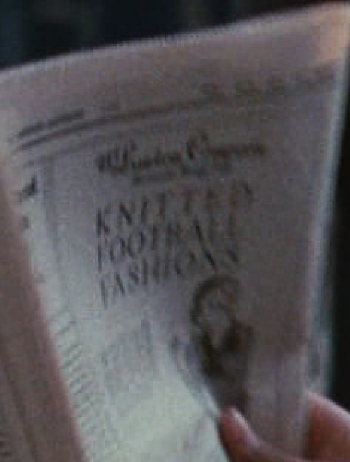

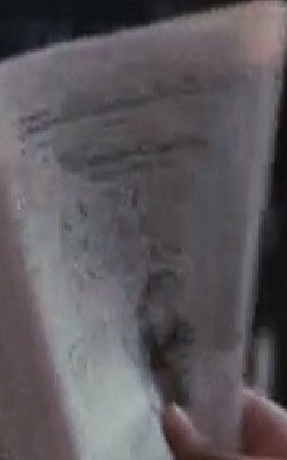

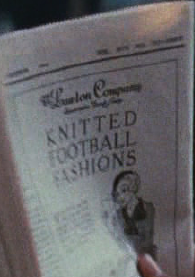

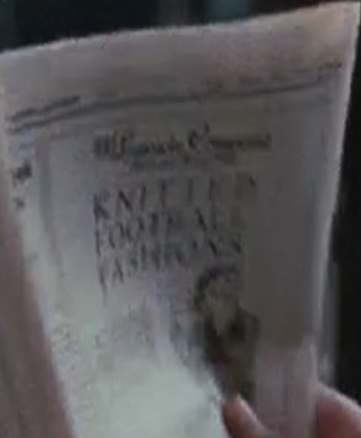

Here are the zoomed shots for each frame from my immediately previous post. The order should be the same. Across all the shots, it's apparent that even the master feed could use more bits. It's MPEG-2 macroblocking is obvious in the zoomed shots, but may not be so apparent in motion on a screen. The DN uplink shows much less detail, but it does demonstrate how H.264 tries to conceal the more obvious macroblocking artifacts of MPEG-2 (the sharply defined edges in MPEG-2 make this easy to spot).
The master is way ahead of the DN version in showing detail from the outset, while the paper is in motion. The early DN frames are simply blurred, while one can make out some of the type in the master. Both make errors tracking elements of the type, but this is much more severe in the DN images, causing far more distortion. By the final frames, the master is showing a lot of accurate detail, albeit with a little mosquito noise. The DN version is still far behind at the end, but the larger type is becoming legible.
In the interest of time and space, I haven't zoomed into other parts of the frame to compare. This is left as an exercise for the reader. The background is blurred, and there are differences in how each encoder handles this. Also as mentioned before, the hawker's face shows far more detail in the master feed.

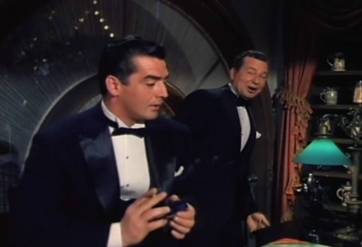

I found a test ts stream file on my PC that is from the FMC SD master. It's an old movie so not the greatest for comparison though I took a couple snapshots for you to look at. When I get time I will record some DVB SD master ts streams from the Visionsat and post some snaps of various stuff.

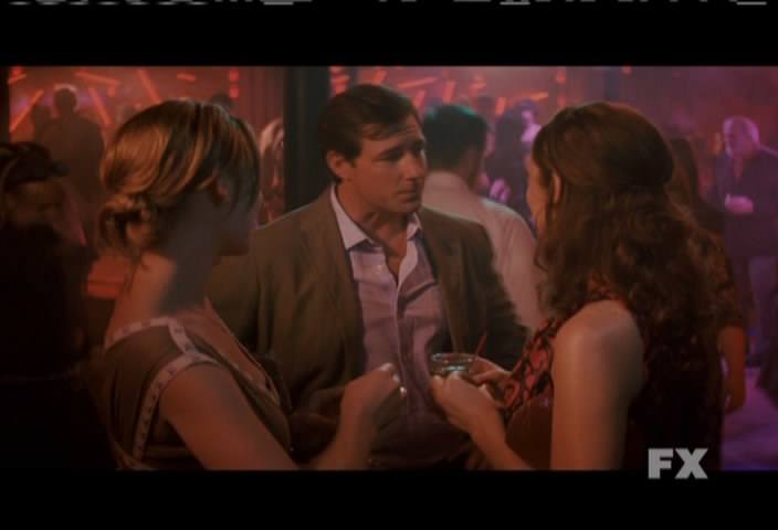

Here is a few quick snapshots from the CW and FX SD masters from the ts streams I just recorded.

There is nothing dreadfully wrong with your SD masters. But they're still SD and remind me of what I used to work with and watch 35 years ago. In fact I just put a few up on my 30-year-old, 25" CRT studio monitor and they look the same as on my HD screens. My studio monitor is limited by the NTSC standards set for B&W in 1941 and for color in 1953. I would shudder to use a 30-year-old computer, let alone one 57-years-old, when given the option of using the one on which I am typing. I believe video technology has also moved forward since that time.
Compared to true HD, these frames are extremely soft and carry very little detail. Compared to DBS HD-Lite, the same can be said. My thesis was that DBS HD-Lite is an adequate approximation of a HD master feed, and provides far more detail than a idealized SD master feed ever could. I have supplied examples that demonstrate this. I have also shown how motion can deteriorate the detail in a HD-Lite frame, but not necessarily with devastating results.
I am not sure of what point you are trying to make by only posting SD master frames. If you believe these look better than HD-Lite, you have not provided any evidence of this. You have only succeeded in convincing me that I was too kind in my methods of simulating SD masters. In real life SD master quality appears worse than my simulations.
I'm fine with people who want to keep watching the only game left on 4DTV. But just as we all rail at the DBS and cable providers for their faux-HD, I think it's only fair that the 4DTV SD crowd recognize the reality that a SD master is not a replacement for HD-lite for the rest of us. It's not that we are blind or ignorant. Some of us are very discriminating. There is simply more detail in HD-lite than you are willing to admit, and there has been considerable progress in compression techniques over the past few years.

...There is also some detail loss overall, see for example the wood grain immediately to the right of FDR.
My spatial relationships got confused here. While the wood grain is technically to the right of FDR, from his "perspective", it is actually to the viewer's left in the movie's frame. Thanks to the soul who pointed this out to me.
