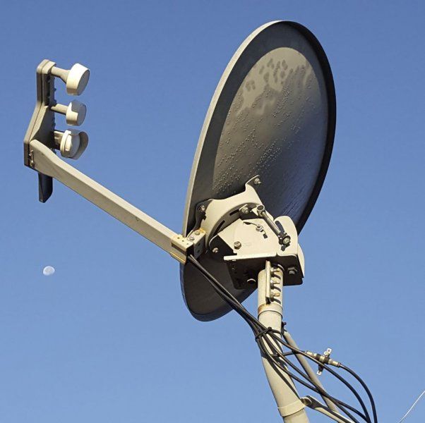

I guess I can't realign it myself? I live one mile down the beach from Mexico Beach Fl. Need I say more.

The east and west settings are probably off.
If you get a 1/2 wrench and loosen the 2 back bolts and swing the dish from east to west you will likely be able to find a signal.
It's unlikely the elevation changes
If debris hit it, it could be bent. If so - even by so little you can't see it - there's nothing to do but replace it.

Thanks guys I'll give it a try this am.
You want me to loosen the 3 bolts on the shaft and turn it right to left?

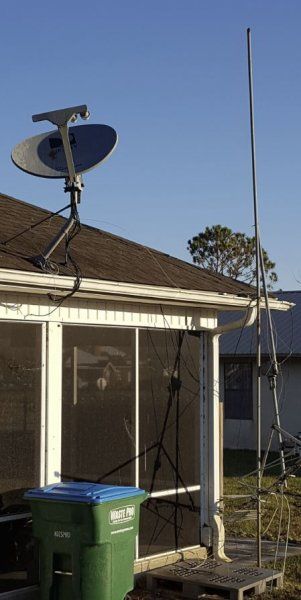

You can see the damage it did to my CM 3020 Antenna and Mast. By the way is there any way I can watch ESPN on line from D*?
