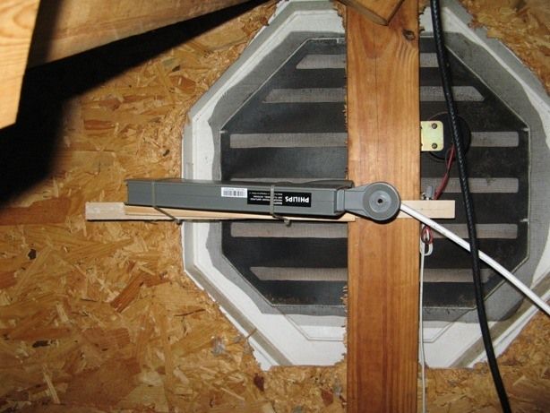

So, I decided to set up the Philips antenna in the attic for temporary use.
I kwe that the signal was going to be degraded inside the attic. On that account I looked and found the octogonal gable vent on the side of the attic facing the direction of the majority of my signals. So, I fastened a 1x2 crossbar to the vertical 2x4 that always runs vertical everywhere these vents are installed. Using two long wire ties, the antenna is now permanently attached. Since the screen is fiberglass and the vents are made of thin vacuumformed vinyl sheeting, I kwew that the material was transparent to TV signals.
To my amazement, this little gem received every channel I got with the big amplified behemouth that was outside on the roof and two more from Charlotte, NC, some 60 miles or more away. I even got a very strong good signal on my local CBS affiliate which went back to its original Channel 7 VHF actual frequency. This is supposed to be a UHF only antenna.
Now, I am impressed. In the attic, I'll not have to install masts, grounding wires or worry about weather damage. Customers would be thrilled with these, since they work almost as good as the outdoor ones.
Today, I spent a couple of hours taking down the ground wire and other remnants of the outside install. I'm sold on these NEW "Micro" amplified antennas.
Maybe it's not for multidirectional locations, but this appears to be an easy to install inexpensive option.

Surprised it works at all since TV signals are horizontally polarized. I would have thought that mounting the antenna on it's side as shown in your picture would place whatever loops or elements inside on a signal null.

oh and the Phillips was about 2 feet higher than the regular antenna was. ALso noticed that it worked better horizontal than vertical (as shown in the OP)
