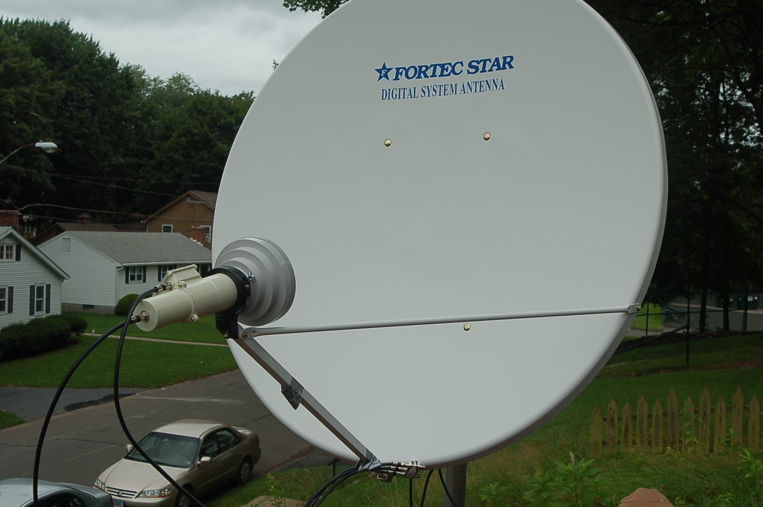

Ok folks for over two hours I have been screwing around with my Microbud. In the last 10 minutes I have succeeded in getting C Band Signals! (Yippie!)
Fix something for you guys to laugh at the first two hours I worked and wored to get a C Band signal... I was getting KU fine but not a peep out of the C Band LNB. After awhile I got mad and sat down and went through my settings... 5.150 for the LNB Diseq port 2 on the switch.... WHat could be wrong...
I then went and looked at the switch. Dummy me had the C Band LNB plugged into port 4 of the switch not port 2... Corrected that and I was getting signal on G11! :)

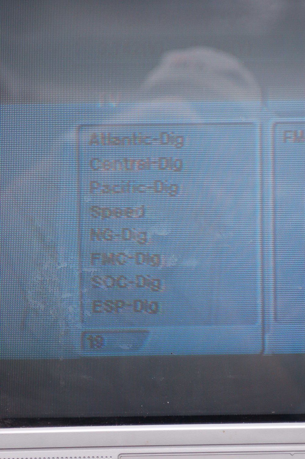

So far just EWTN which is coming up at 65% from Galaxy 11. (I am also getting a bunch of scrambled Fox Sports Channels, Fuel and Speed, plus EWTN Radio Channels and another interesting channel CRN (Cable Radio Network)
So far my highest signal quality is 67%

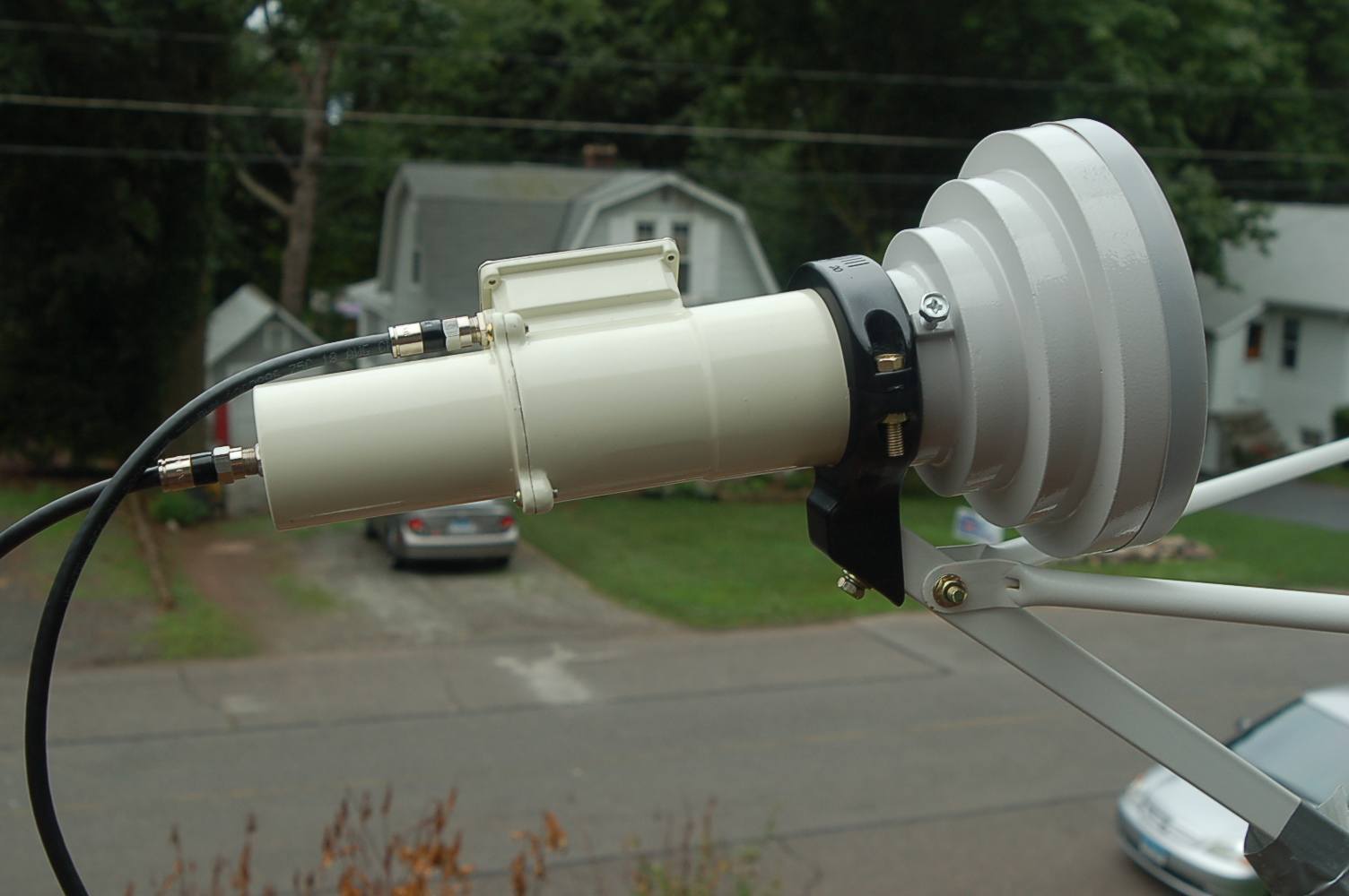

For those of you with Microbud setups what transponders satellites and channels are working best for you? Any tips to improve cband quality? I have done nothing with the scaler yet its on where I put it on the other night which is flush to the first ring.

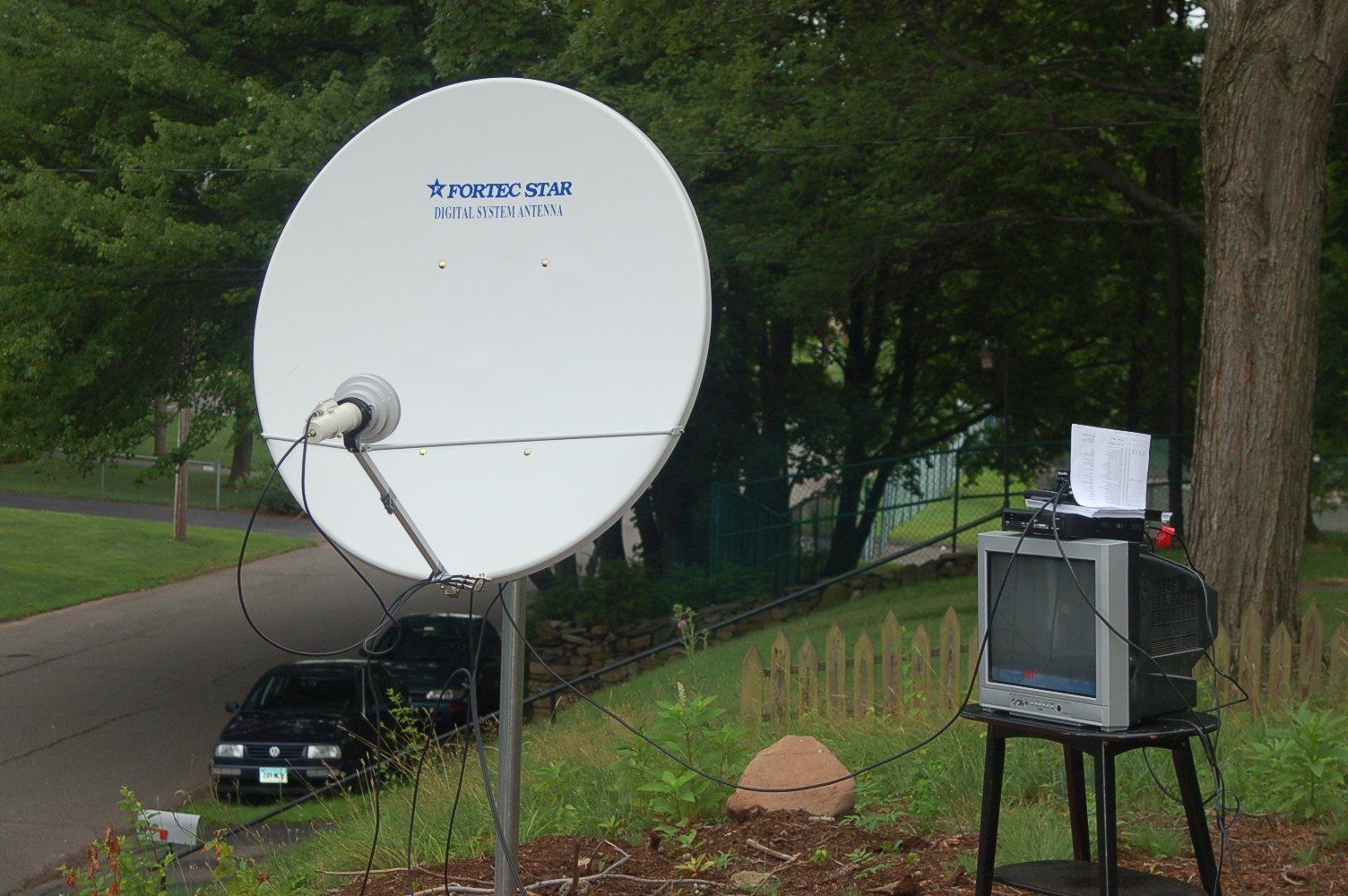

Here are some pics. I took screen shots but with it being so bright out you only see me taking the picture of the TV. :)

I would leave the scalar ring where it is and try to move the LNB closer or further away from the dish while watching signal quality.
Try removing the LNB cover for now while fine tuning. I would consentrate on the KU signal and C-band should fall into place.
Nice strong signal on the ASN channel (C-Band)

No further luck, it looks like it is going to rain here soon.
The scaler ring is strange, if I push it in so that the LNB is more in the ring I actually get signals that I cant get if the lnb and the inside of the scaler ring are even.

the lnb you have is not as sensitive as the ones from dmsi
also on mine the lnbf sits just barely in the scalar ring enough to screw it on
then loosen up the holder ,slowly moving the lnbf front or back to the optimum position.
a strong satellite is 805 lots of channels, you can try 806 also very strong signals
but you have to use the dielectic plate(a nice suprise is there actually someone listed it on lyngsat of course they wouldn't miss on the chance ,i hope it stays there for awhile)
AMC 12 comes very strong
use your coolsat which i think is more sensitive with low signals .
There seems to be a triangular mark on the opposite side off the switch that I believe is for the scew.

Yes the mount has scew marks on it, however I don't see any marks on the LNB itself (I may just be missing it)
