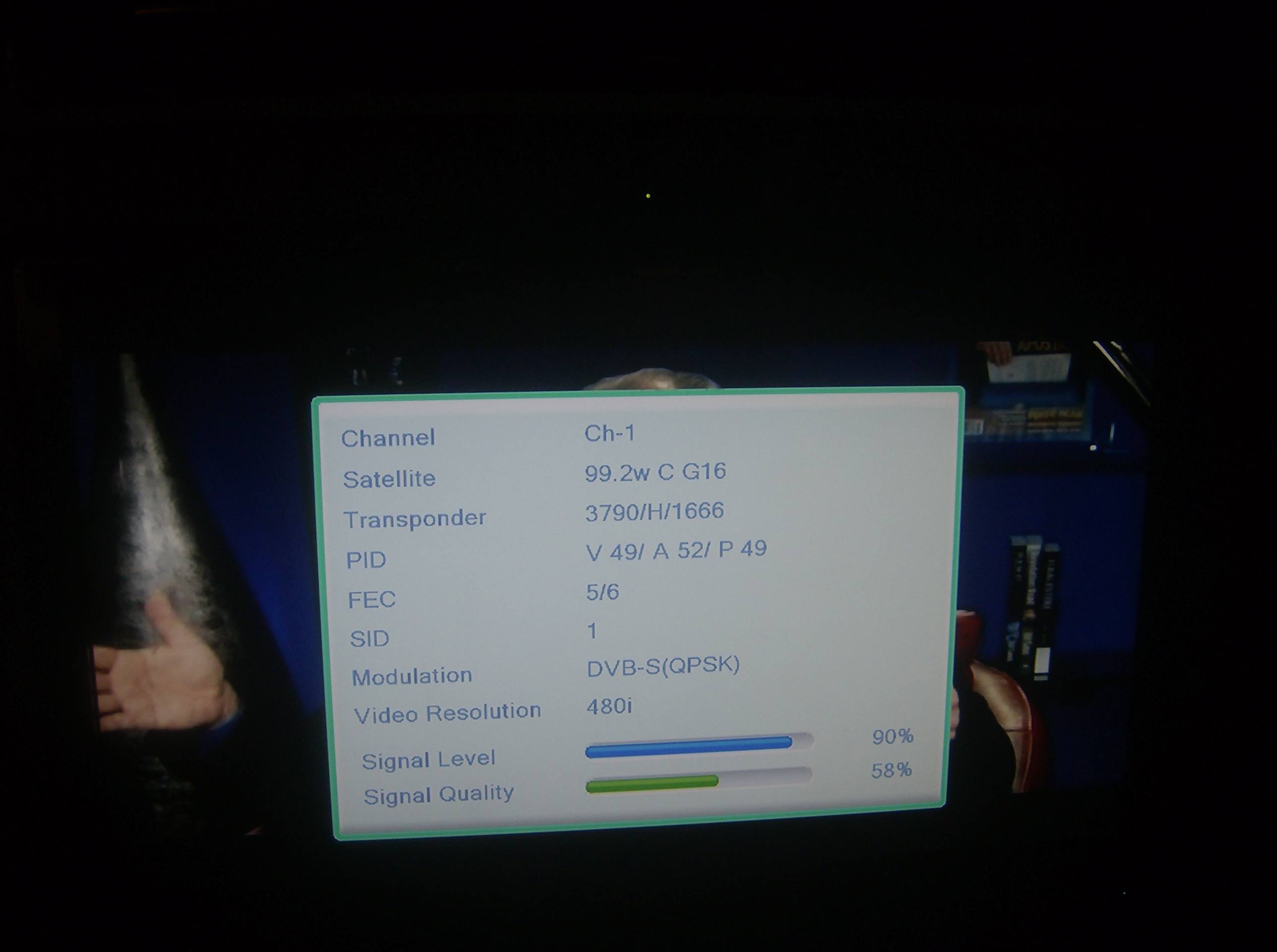

Scanned it OK on my microHD. Maybe weather related?View attachment 91155
What firmware are you running? I'll try again later when I'm not recording something else. The only difference I see, is on mine, it says SID 3, yours says SID 1.
Did you already have channels scanned in on this sat, or was this a new scan?
Ok, I rescanned and now it comes up as Channel 1, and is showing a church service. Sid 1 now shows. I think maybe they are doing some tests here, and changing from time to time.
