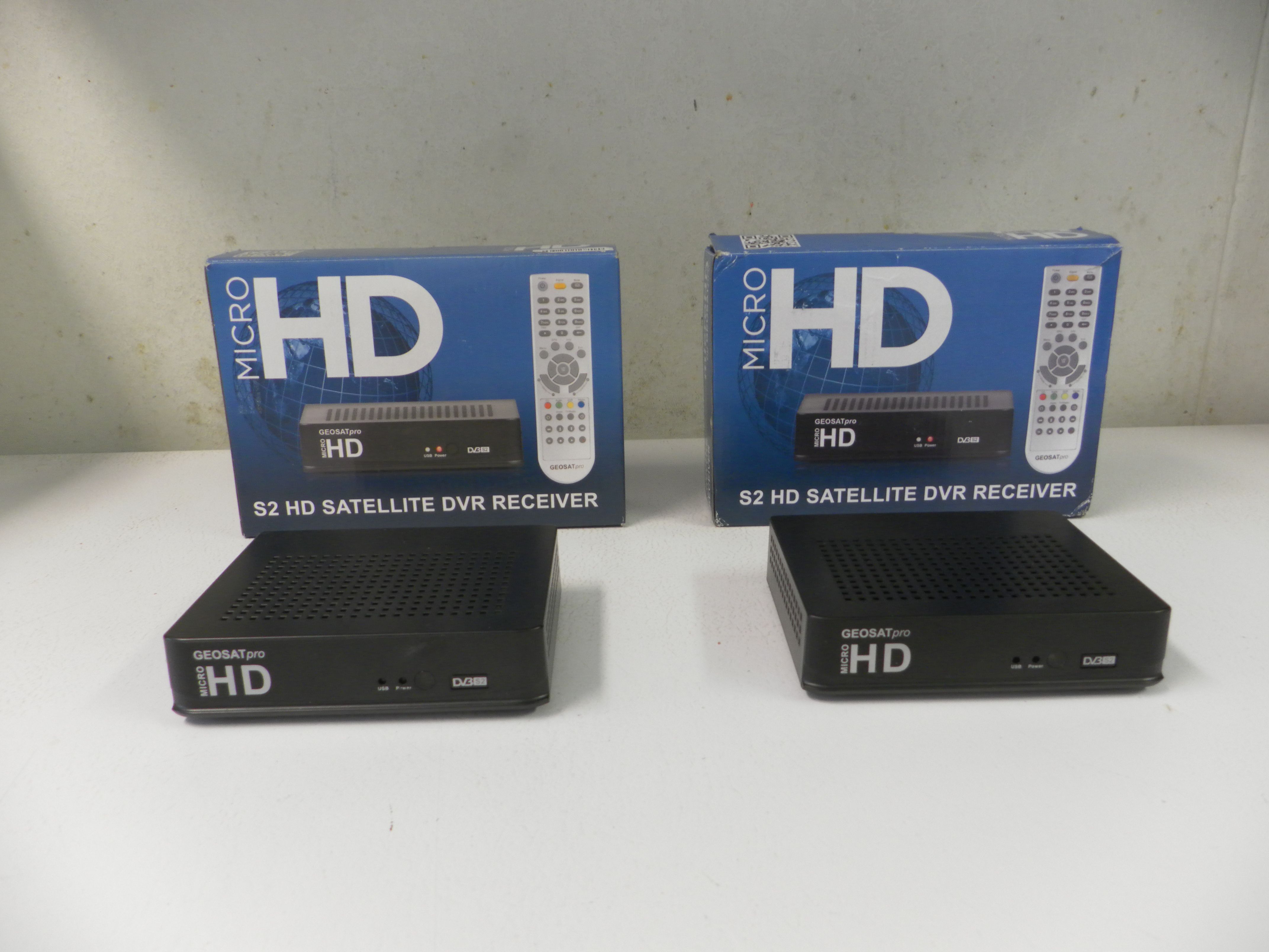

Up front they look the same, but let's get behind them and see what goes.
I wonder what differences we don't see?

Well I know one difference. The one on the left has worked flawlessly since day one. The one on the right does not :(

The one on the left is from the first batch of microHDs. The one on the right was purchased recently. But I don't think I would call it a clone just yet. The dealer who sold it has nothing to do with the questions that face us currently and I'm not pointing fingers at anyone. But there should be some discussion about this I think.

There are tiny differences in some of the components that I can see, but both have the ALI chip

The circuit boards appear identical. Looks like some minor differences in the solder quality between the two. Have you tried swapping their power supplies?

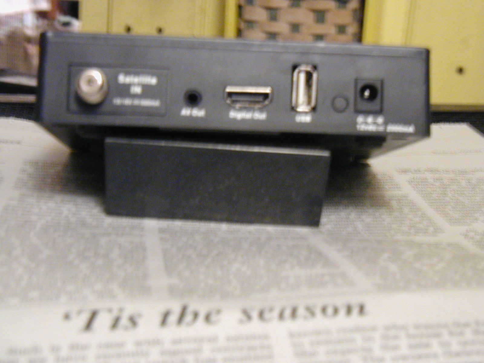

I notice the one on the left has "HDMI" and the Dolby Digital marks printed on it. Along with USB 2.0 indicated.
The one on the right just Digital and USB. No HDMI or Dolby Digital.
Think there's a licensing requirement for HDMI and Dolby Digital, possibly USB 2.0 also. [Smells like a clone.]
What's the firmware version indicted?

The new units have a firmware version which is later than what we all use and it stinks. We have been reflashing with the earlier version. It looks to me that the quality is been lost out of these things. :(

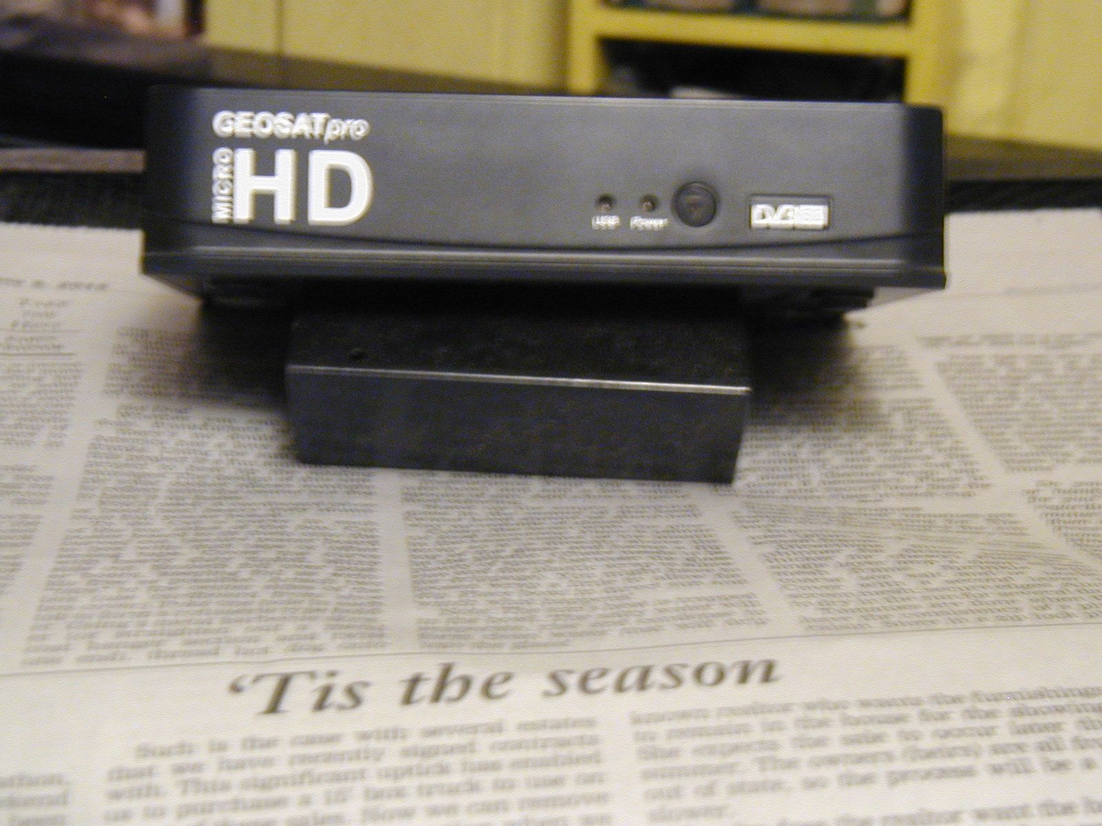

Mine is like the one on the right and I've never had any major problems with it. I boot looped it once, when I first got it and it had a issue with a few transponders that updating the firmware fixed, but other than that, it's been great.
The pictures are fuzzy, think my camera is on its way out, buy you can see it well enough to tell which one it is. I bought it used, probably a year and a half ago, maybe? , so it's not a real new one. I'm using the 2013-6-26 firmware. It's on 24/7 and used every day.
Just thought of another very annoying issue that I did have with it, if I scrolled through the menus too fast with the IR remote, it would shut off. I use a RF extender with it now and that issue is no longer a problem, but with IR, sometimes I felt like throwing it out the window!
