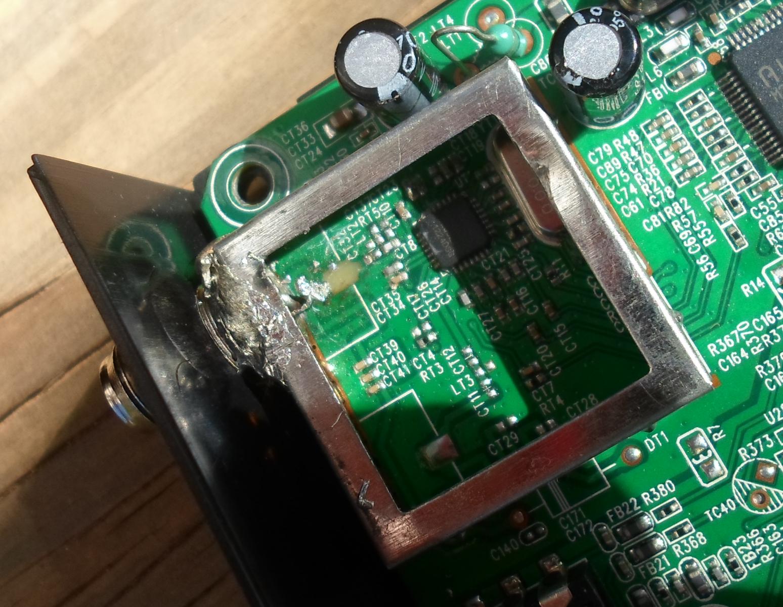

The connector was a bit loose the first time I hooked it up.I tried to be easy with it but it spun and broke the center stinger wire inside the 4th or 5th time I tried to unscrew the coax.The connector didn't seem to have any solder attaching it to the chassis.In hindsight,I should have epoxied it or soldered it lightly before ever using it.But I was anxious to get the system up and running. :sobstory
I soldered it to the chassis strong enough to last a lifetime.Possibly melted the center insulator,IDK. The problem came when I tried to solder the broken stinger.Darn tiny wire wouldn't take solder on both pieces.(About like trying to solder a goat hair.lol) I kept getting a cold solder joint that wouldn't carry the signal.The ball of solder grew each attempt until it dripped down. At which point I gave up.Eyes and hand dexterity ain't what it used to be. :(
The box still powers on and cycles thru the menu fine...so hopefully nothing else was hurt.
micro_bright.jpg Yellow spot is where the solder fell and removed the green layer on the board.The ugly blob of solder you see is on the stinger wire.

View attachment 117226 Yellow spot is where the solder fell and removed the green layer on the board.The ugly blob of solder you see is on the stinger wire.
You're welcome. That definitely looks fixable, you should be good!
Where the trace was lifted off of the board can be jumped. Those broken stinger wire connectors are a pain to try and reconnect the original broken one, I usually solder in a new F connector and remove the broken piece from the circuit board, then take a resistor and wrap one leg around the solder tab on the new connector, other end through the board, solder it and then cut off the rest of the resistor, much, much easier.
Those crimped in connectors do come loose real easy, but they're made that way on board mounted tuners, blocks, etc, so if the F connector gets pulled, it will pull out, rather than pull on the board and crack the circuit board. With something as light as the MicroHD though, you wont have to worry about it being soldered solid, the cable gets yanked, it's just going to move the whole box.
You didn't mess up that board bad at all. I'd say that there's going to be a working MicroHD for you after Ke4est works on it! :)
