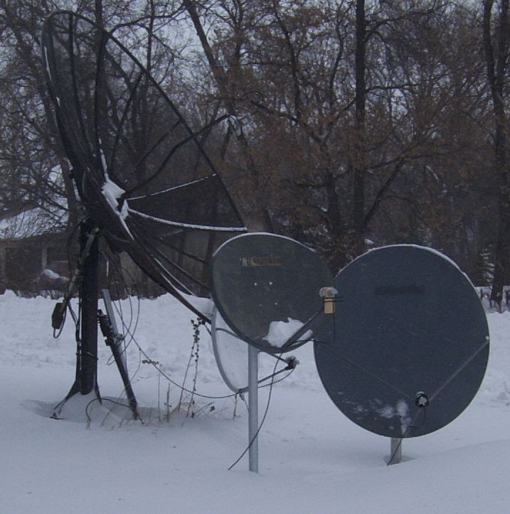

Put the Ku in front of the BUD and spacing requirement would be less as the Ku dish is a lot "less tall" than the BUD. I've got my fixed Ku's in front of the BUD. Even the 30 inch mounted to the lower lip of the BUD is looking over the 84e and 1.2m.

bingo !
Yea, this is potentially a much better idea! - :up
Just as long as you weren't putting the BUD up against and looking over a fence.
