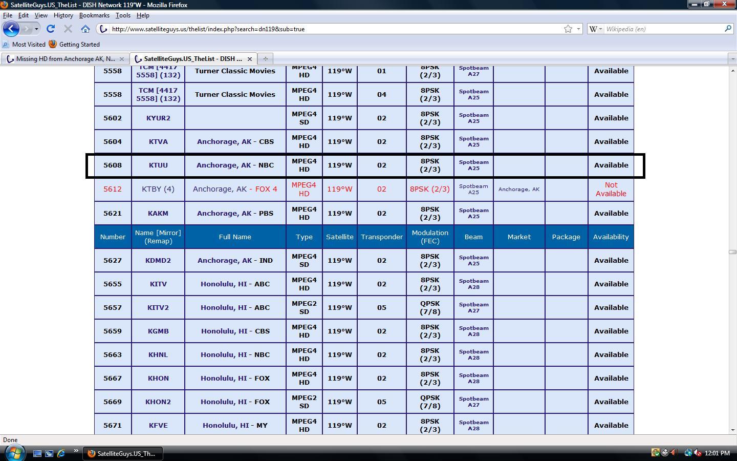

Proof Anchorage HD is on 119
62394d1299953222-missing-hd-anchorage-ak-nbc-untitled-jpgg
