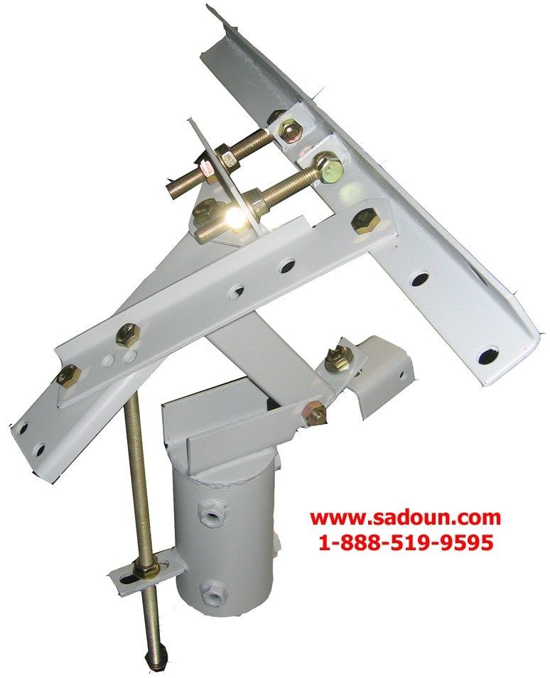

To save you some time and efforts, we may have a polar mount available for you. Call us on Monday to check. Ask them to check the warehouse and get back with you. This item is not listed on our website separately.

I have talked to Mike before, I am sure he would know about Alaska FTA. I will send an Email. Footprint maps should help a lot too. That Sadoun mount looks like it could be adapted for the Andersen, would need to build in quite an offset, something like 30 degrees including declination.

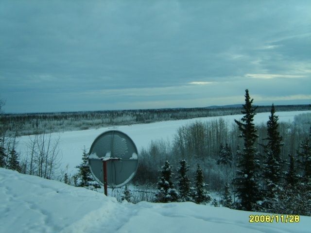

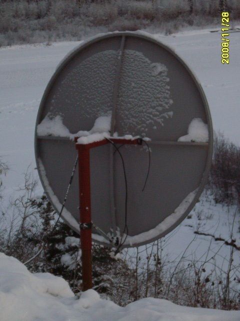

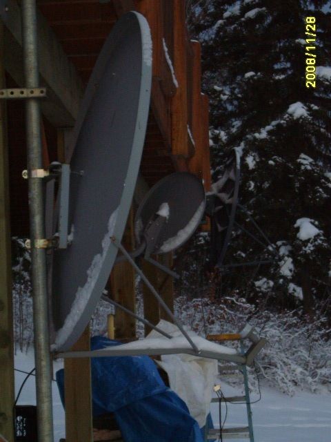

Here is a picture of the homemade mount currently on the Andersen. Another shot shows the excellent location I have, unobstructed negative angle to the horizon all the way across the arc. The last one is the rest of the (current) dish farm minus the BUD. 48", 18", and 40". Don' tell my wife, but a good view of the arc was one of the things I was looking for when I bought the lot.
