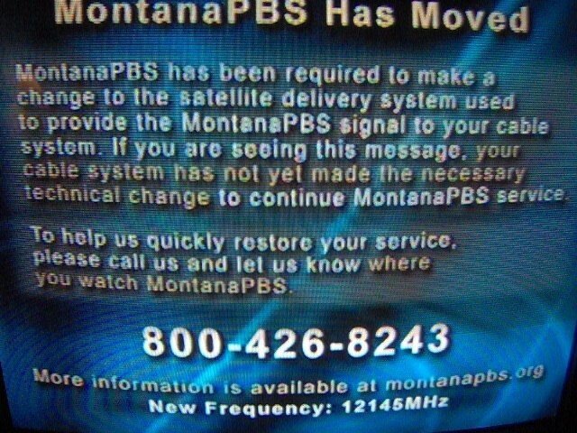

by the way...here is what you get if you go to the old TP (DONT CALL THE NUMBER...that is for cable subs whose cable company hasnt changed the info in their box)

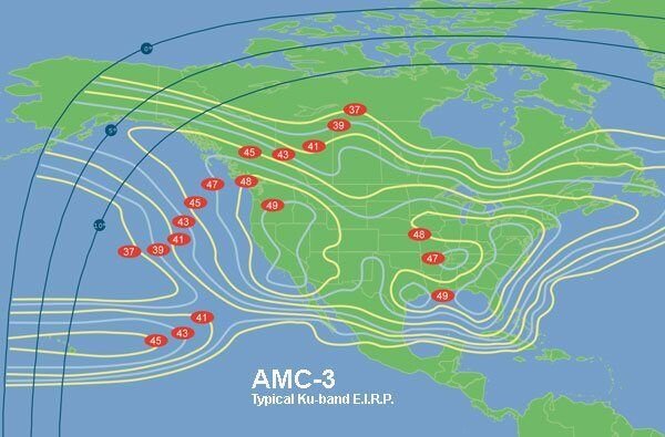

What am I doing wrong. I don't even get a blip of a signal here in Winnipeg. Maybe I need to enter the entire information. Is the station on the air 24 hours a day?
I'm getting AMC 3 no problem. TIP TV and The Patient Channel are coming in at the 70's for signal and quality. But I don't get so much as a blip for 12145 H. I'm frustrated as the guy in Toronto is getting it.
tim
Look at the footprint. Mpls & Toronto have a better EIRP level than Winnipeg. But if you have a larger dish that should have helped
