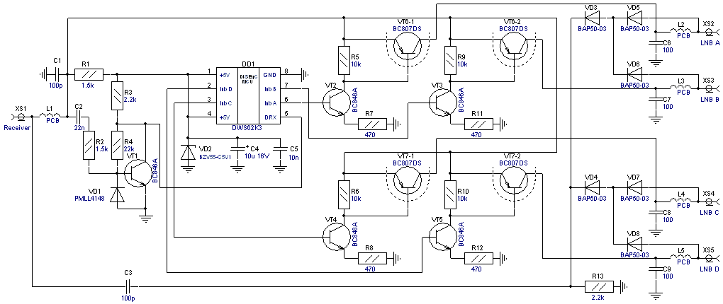

I realize your problem is fixed, but...from a purely "informational" standpoint, is it possible to lose signal pass-through on a switch and still have it passing power? If so, your info may have helped me with one seldom-used port on my setup!
I'll have to defer the definitive answer to that question to the more knowledgeable members here... but to me, it seems unlikely. I still had power going out to the dish motor from the GBOX, but it was carried on separate wires - not the coax.
Yes it is possible. If one of the diodes fails on that port. Look at the below schematic, and you will see what I mean.
Btw that is a schematic for a simple diseqc 4x1 switch.
Thanks! I've got some work to do now! Will substitute a port for the one I suspect and see!
(I'm lazy. Why do that if there's no chance of a failure as described??) Thanks so much for the info! That's why I love this place!
I would say sure,the power is DC so as long as the path isn't completely broken it will pass.Signal is RF,so the right combination of defects and you get a trap,no signal.
