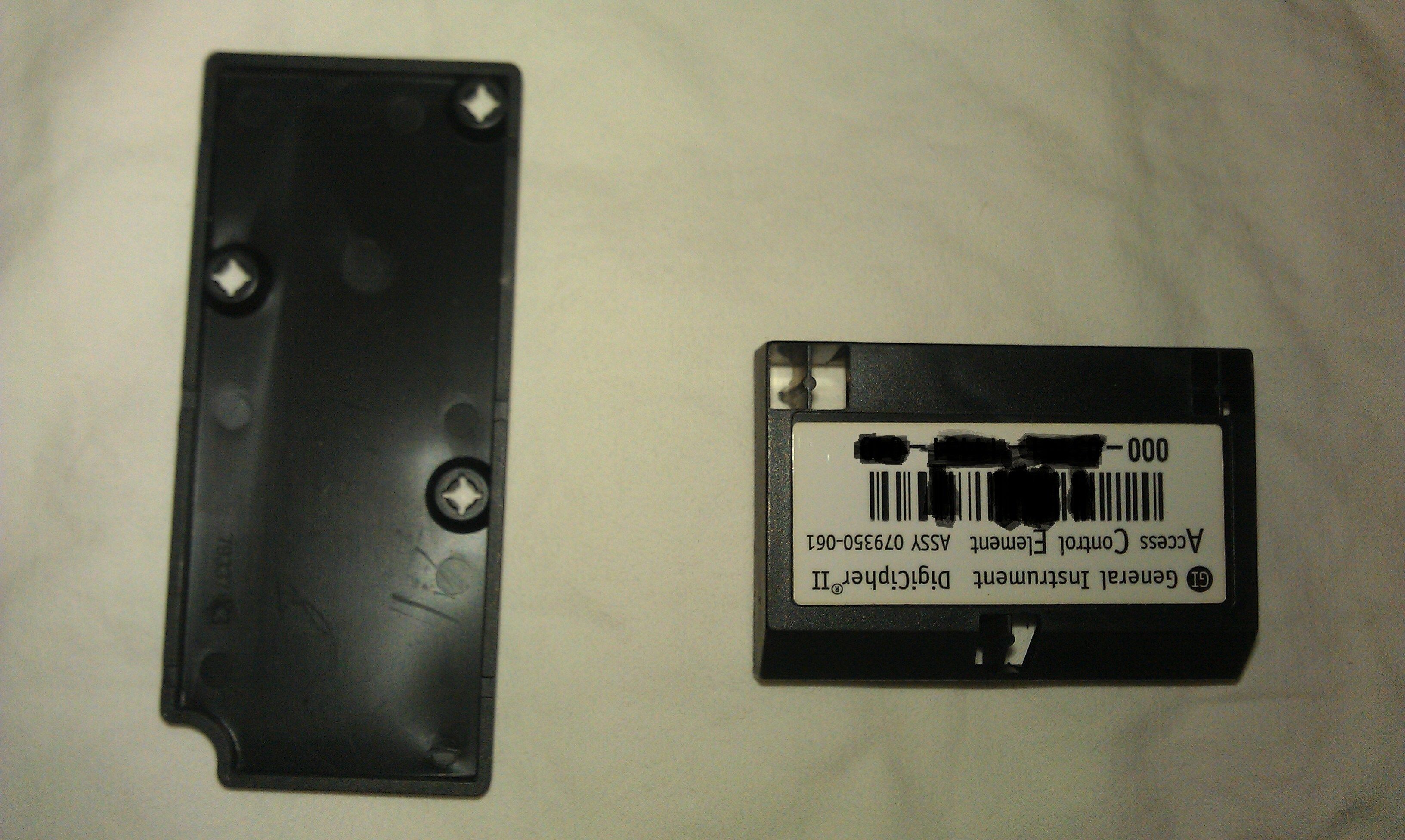

Once you remove the ACE, the plastic cover can be taken off from underneath by prying gently on some tabs.
The battery was a BR2335.

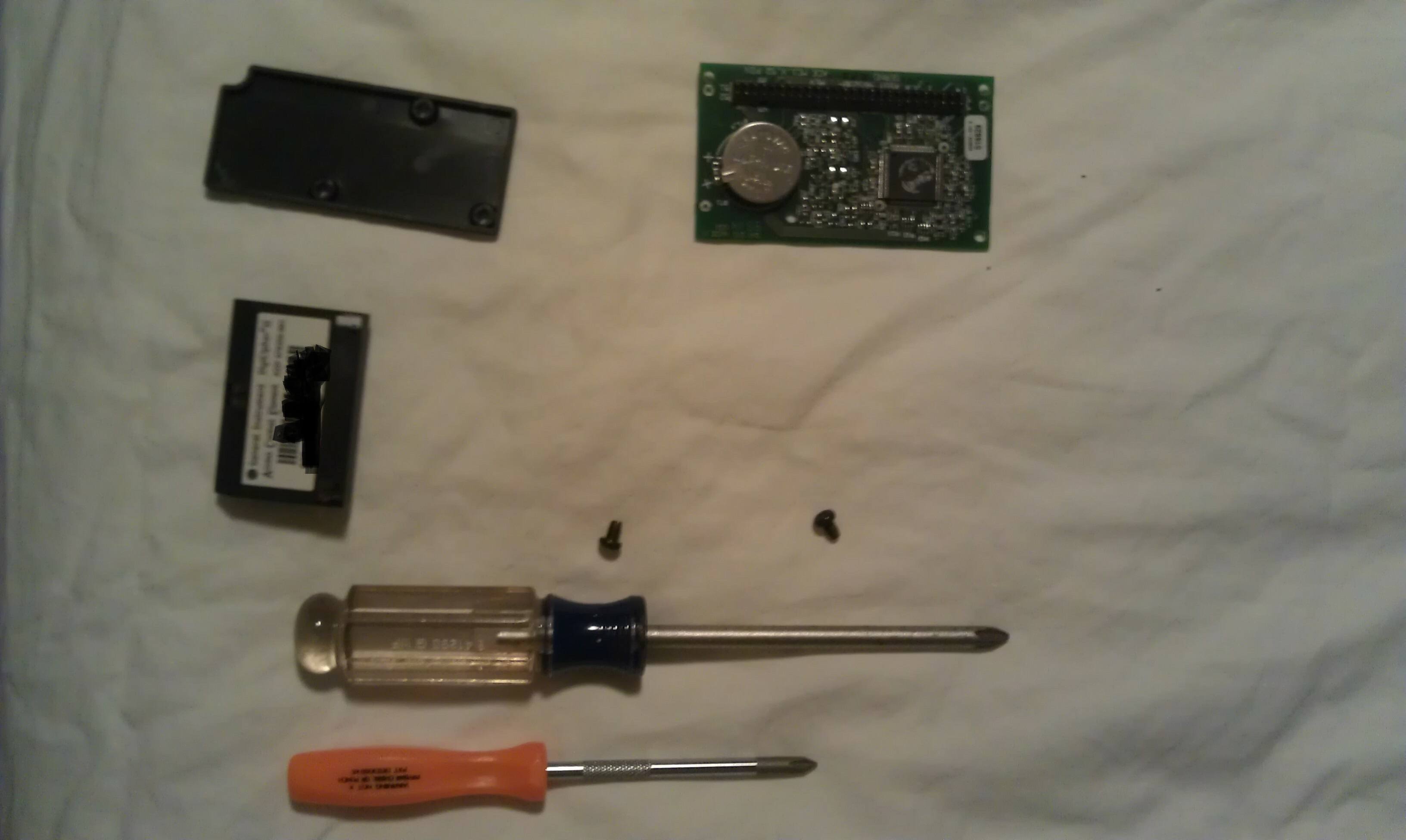

So it sounds like you can separate the ACE from the receiver without killing the unit. Sounds like a decent solution. I think I will do this in the next couple of weeks and take photos. This way I can document where I did right, or...gulp....wrong.

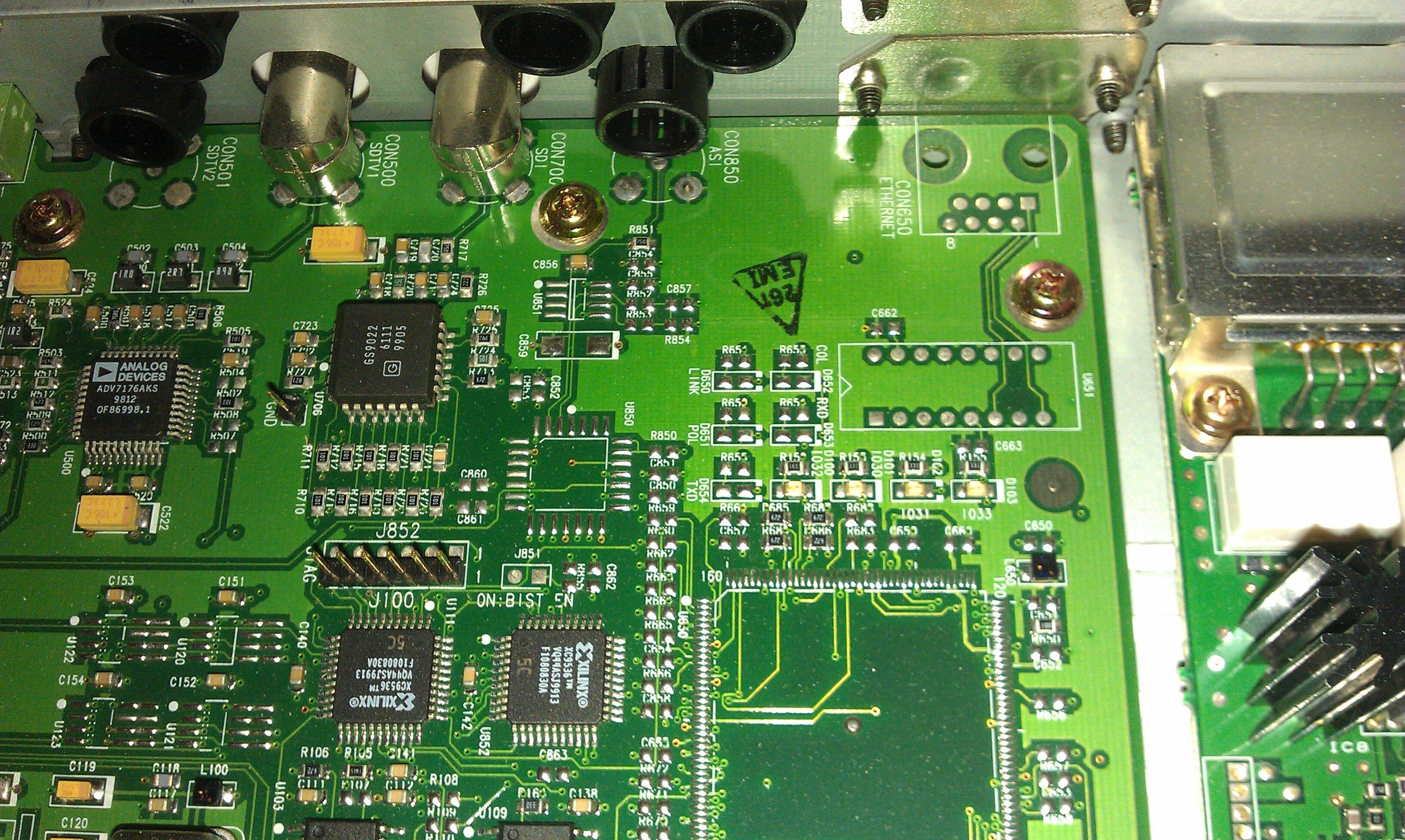

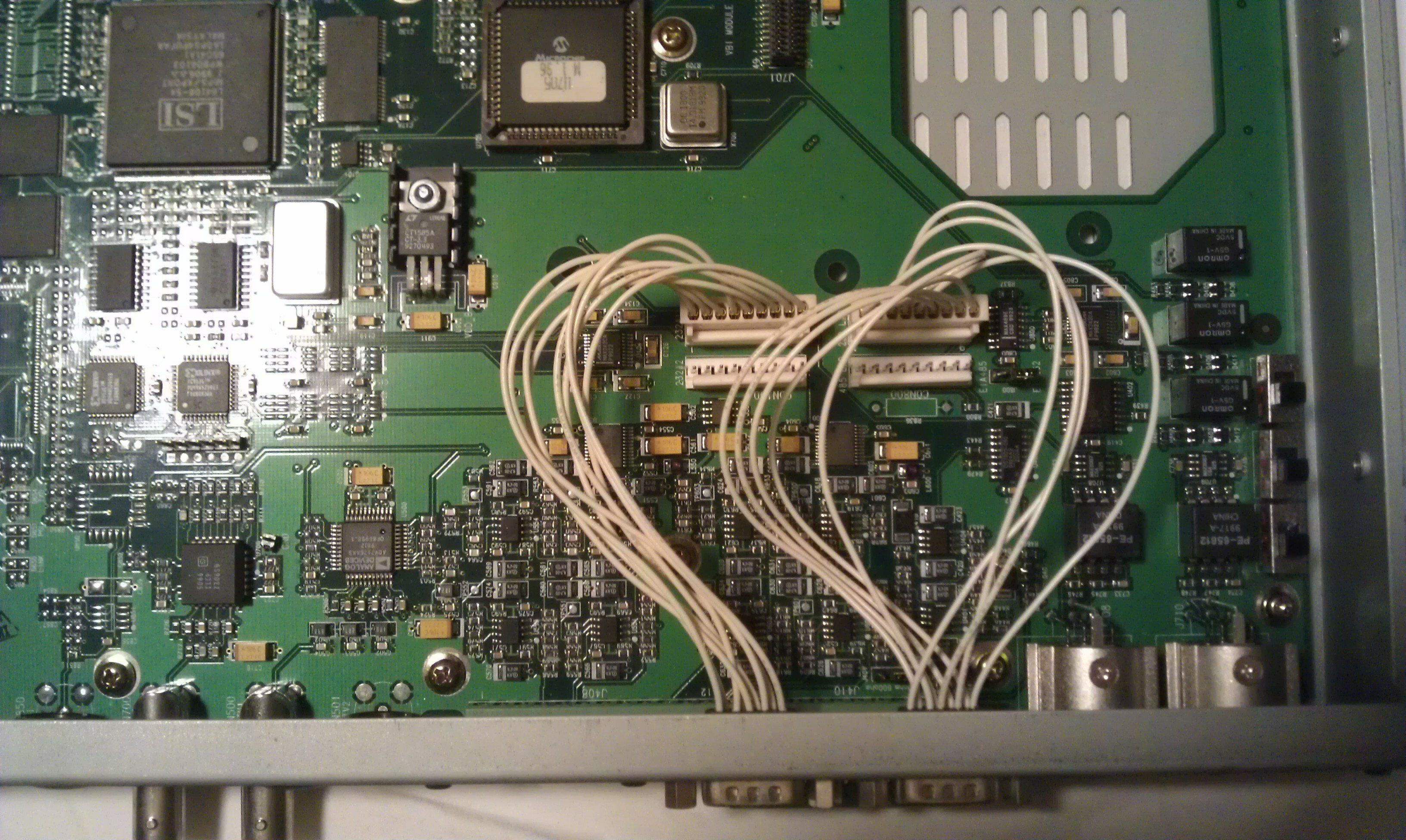

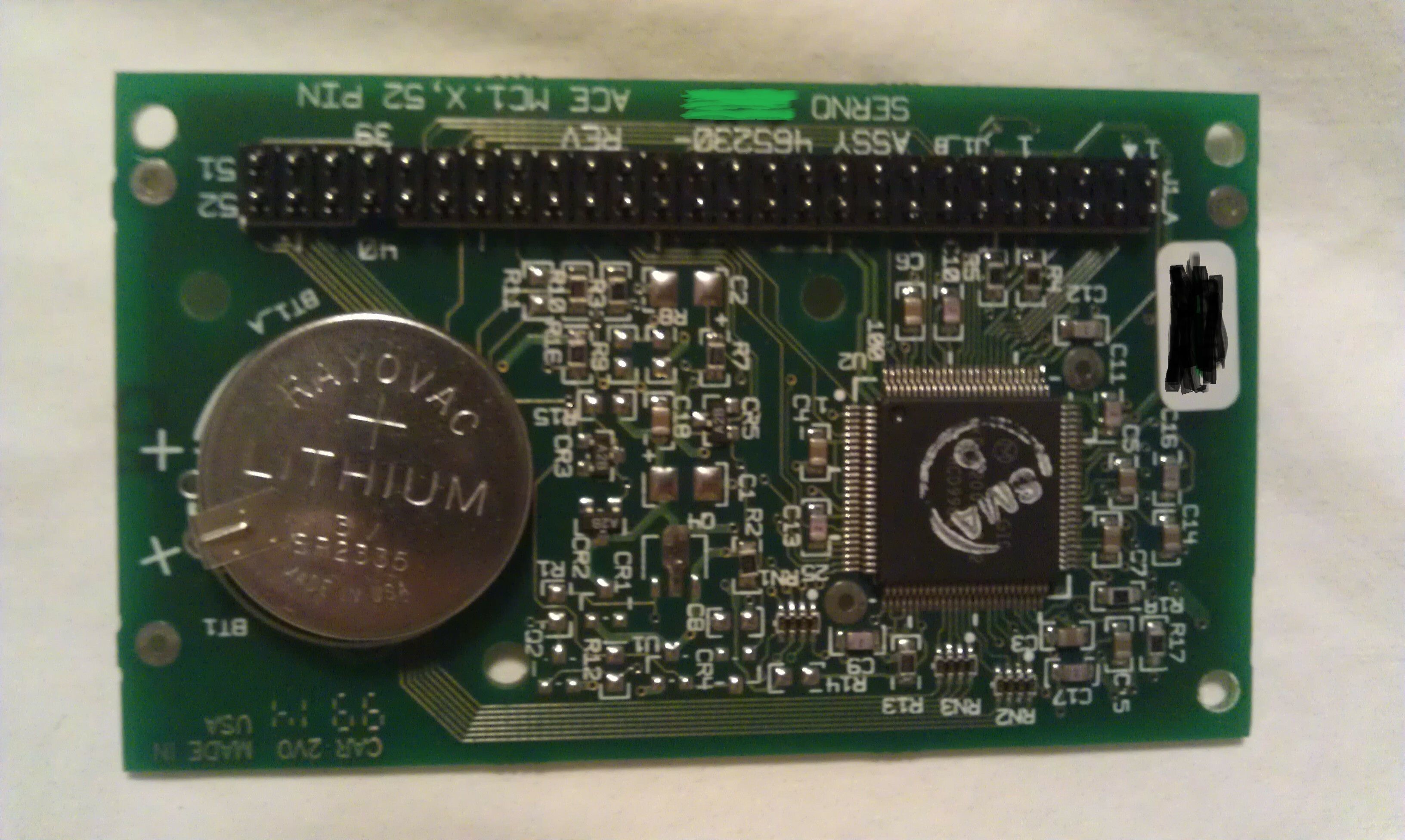

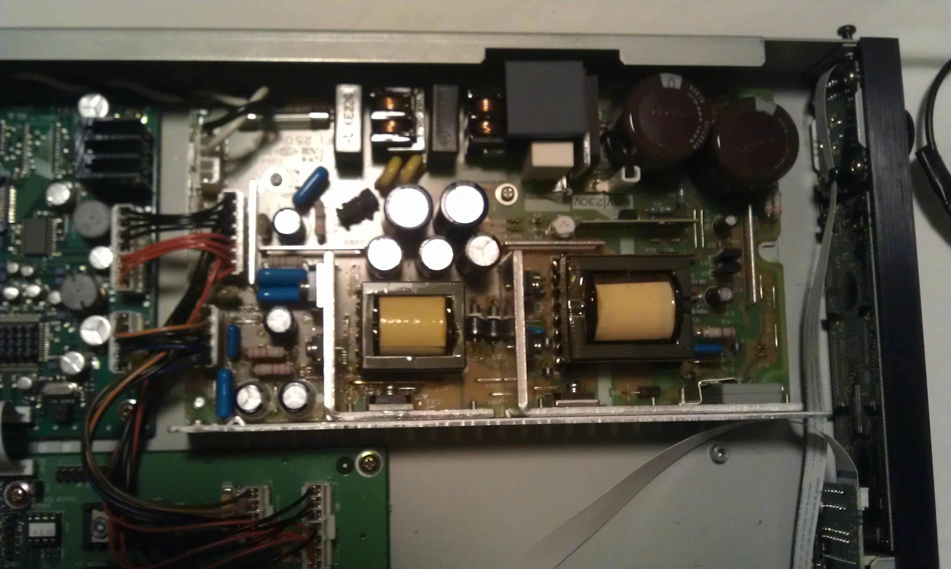

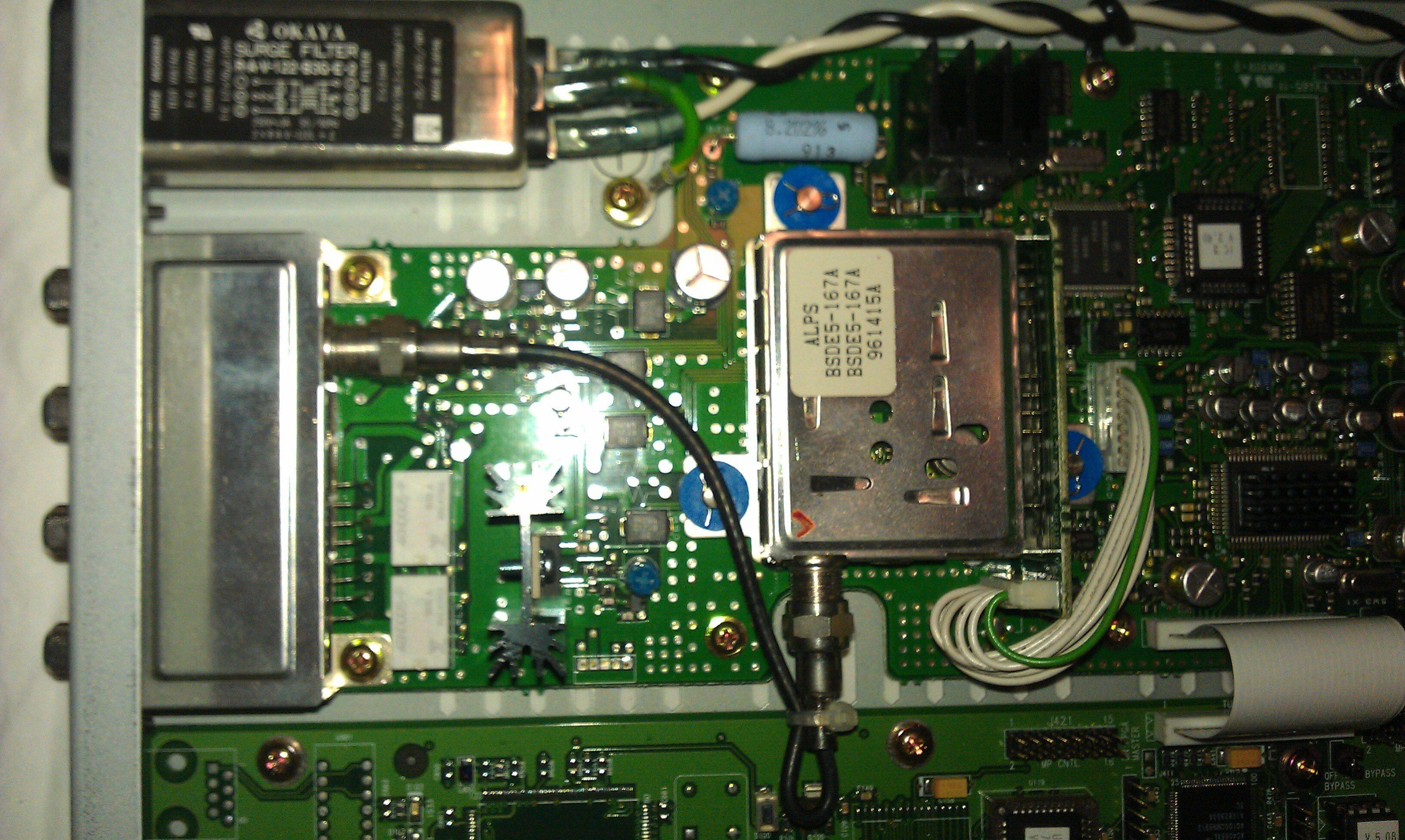

Well, here are the photos I took removing the ACE module from my DTE-7150. It was not rocket science and I will have to wait until tomorrow to power it back up. ACE disassembly and tools.jpgACE module and battery BR2335.jpgACE module covers.jpgASI Connector Possibility.jpgDTE-7150 Power Supply.jpgDTE-7150 Tuner Section.jpgSerial connections RS-232 currently.jpg
Does this appear to be an easy one to add the ASI connection to? Are there any components I need to install?

Thanks very much for posting these pictures. Helped me figure out the resistor value on my broken unit (see here). As for installing ASI, you are missing a few components for sure. Could you take more pictures near the ASI any place where there are empty solder pads? I'll do the same and post the results, then you would be able to come up with a parts list.
So how are you able to maintain battery voltage while replacing the coin cell? The pictures are great. I don't see a way to keep the voltage present.
There is actually a second set of holes for the battery. One extra for the + and - connections. I will replace with an AA style lithium rated at the 3.0v that has leads on it. The plastic ACE covers will be taped up inside the unit.
As far as adding ASI, my main worry is the missing IC has code on it. If so, them I would need a dump so I can jtag the chip.

After zooming in on Bongu's pic of the ACE, I see there is an empty "+" hole right beside the one in use. Considering the design of the battery & board, it would seem to be impossible to replace the battery using the unused + hole in the PBC without loosing contact with the negative side of the battery. UNLESS, the other side of the board has provisions for a battery also.
If the other side of the board did have provisions for a battery, then it would be easy. All you'd have to do is mount a new battery on the other side, solder the new battery's + tab into the unused hole, and then clip the old battery's + tab & remove it.
Unfortunately, Bongu didn't include a pic of the other side of the board, and I'm not at home right now to check it. So I can't tell if that's how it is. But the thickness of the ACE covers, and the fact that they are on both sides of the ACE's PCB, and the position of the empty + hole, all add up to at least a little hope that it may be that way.
Cheers
I can confirm that there is a second empty hole that could be used for the negative contact on the underside of the board.
Does it look like there's a "solder in" negative tab as well? Solder in would certainly make more sense than spring pressure for the nature of this application.
The problem I can see is battery availability. BR2335 batteries are available all over the web. But it looks to me like what we really need is a BR2335SM. The "non SM" is just a regular coin with no solder tabs. The SM version has a tab for both + & -. I'm having a hard time finding anyone selling the SM version.

Thus far I had only found limited coin cells for this:
Panasonic - BR2330A/HD - Batteries - Battery - Allied Electronics
So I opted to go this route & leave the cover off:
Tadiran - TL-5101/P - Batteries - Battery - Allied Electronics
That is the battery I recommend Brex. This type can be easily added in parallel multiple times with no real issues.
