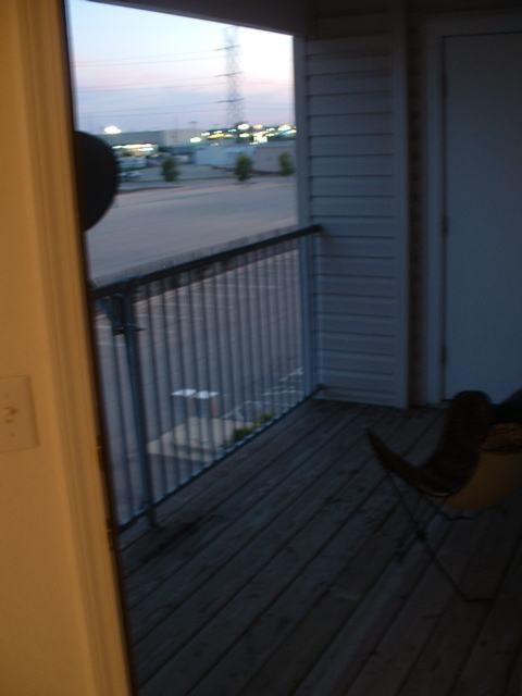

I live in an apartment so filling up my balcony with a bunch of dishes pointed at various birds is not an option. plus i have about $400-$500 to spend on a system so a motor is definitely in the cards. here is the system I am looking to set up:
motorized 30" dish w/single lnb
pansat 2500a
now on the railing of the balcony i already have my directv dish and i am planning on keeping that for the wife (fta while cool, is just not wife friendly)
My question is... is the concrete filled bucket with pole sticking out of it a viable option for a 30" dish? I am hoping so. We rarely go out there and there is a lot of room there so it will not get physically moved by us. the balcony is pretty well shielded from wind and weather as well, and i have a VERY awesome view of the entire southern sky (i am in central illinois)
I am planning on decorating the bucket with plants or something to keep the apartment complex off my back, but there is not much they can really say, I am allowed to have as many dishes as i want as long as they are in my area and not protruding into any areas not controlled by myself.
If you can get a 95cm or 1 meter dish as you will regret it later and its only an inch or so bigger all round, it looks like the bucket mount is your only choice, if its a big enough bucket with enough cement it should not be a problem, the soil and plants are a great touch, you could also paint the dish matt black or what ever suits best to help make it disappear. The problem with a bucket is that the dish tilts as it turns so you want the dish as low as you can but you will have to motor east and west to make sure it does not hit the bucket, on the SG2100 there is a button on it so you can motor the dish from the mount, this is handy when setting it up, if the dish did move in the wind all you would need to do is motor round to your true south satellite re-peak and away you go again. Its not an ideal situation but it would not hold me back from FTA satellite, the problem with balconies is the elevation angle, sometimes overhangs are a problem, hope it works out.
what would be the difference between a 30" dish and a 1 meter dish?
i was thinking of putting the dish at the top of a 5 foot pole. i have a good 10 feet of vertical area to work with, so the dish touching the bucket should not be an issue.
also overhangs shouldn't be a problem either, since i have a lot of area to work with as well. I attached a photo so you can see how things are arranged. also another question about the noise generated by a dish motor... are they very loud? right behond where the dish would be is a large sliding glass door that leads into the bedroom.

There is a buzz when the dish moves but nothing that you can hear from inside and I cant imagine it bothering anyone, the bigger the dish the more signal thats about it, the more signal the less rain fade.... But after seeing your picture maybe a 30" would work as one things for sure the dish will not be getting too wet, the over hang does still seem a problem, I still think you will need to get the dish as low and snug to the bucket as you can, at the same time the signal has to clear the railing. I would suggest a satellite finder tool, or even better cut out a bit of cardboard to the highest and lowest elevation you will be looking at in the ark and check out for a clear line of sight, the over hang will be in the way the higher the dish, you are looking for a clear line of sight at the top and bottom of you dish not just the LNB. Hope this helps.

As you probably noticed in the photo the directv installer ignored the permission letter from the landlord and has the dish hanging outside the balcony. i got a note from the landlord and he is coming back out tomorrow to fix it. Is it a good idea to ask him about where to get cheap dishes and motors, or would he think i am trying to switch away from D* and not just compliment it?
The DirecTV installer may be able to help you but most really are limited to DBS installation, as for the satellite finder I was really meaning a site survey tool, to check out all the angles before you buy, as for finding the satellite the receiver and the TV in the room would work, if you check my web site there is a link to DMSI and you can pick any of the dish and LNB from there. As for the Dish the 30" Hotdish would work for you in this sheltered area or the Wineguard if you would rather the dish was a bit more sturdy, I use the SG2100 motor works great and easy to install one angle to set and you are good to go, it has a button on it so you can also motorize from the dish when setting up this is more for setting the limits in case it hits the bucket in your case.
Wonder where the DirecTV dish is going to go if they take it off the railing? I would wait and see how your signal is if he has to move it inside the balony, I would also get the cardboard out and check all you elevation angles before you buy anything.
the directv guy is still going to mount the dish to the railing but he is going to turn the pole around so it is on the inside of the balcony not outside. it is ok with the apartments if the lnb hangs over the railing, justn ot the entire dish. Since I'm pretty new at this, are there any diagrams of the arc? or a website i can enter my zip code in to that can roughly tell me the angles of the higest birds so i can check it out?
