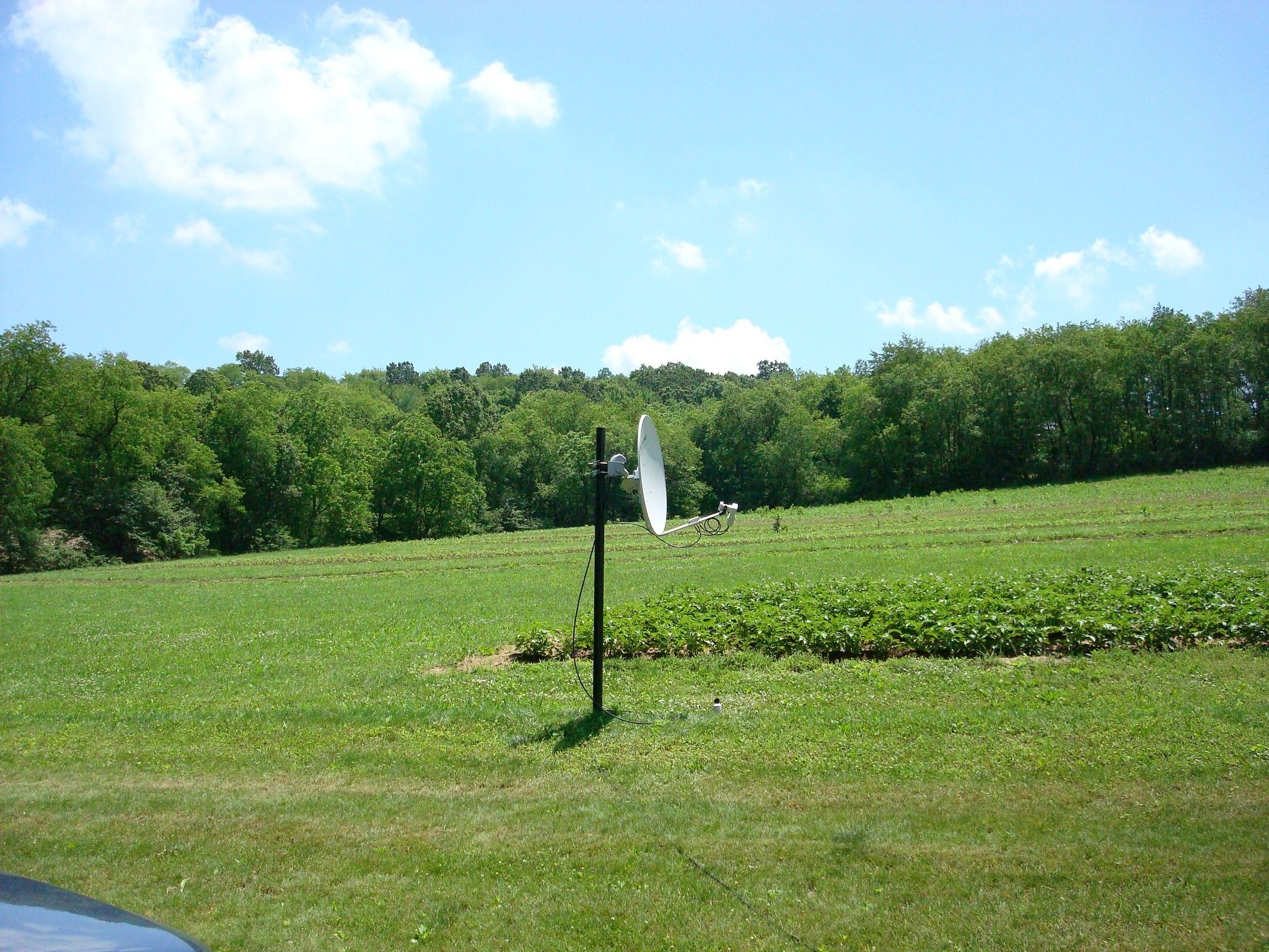

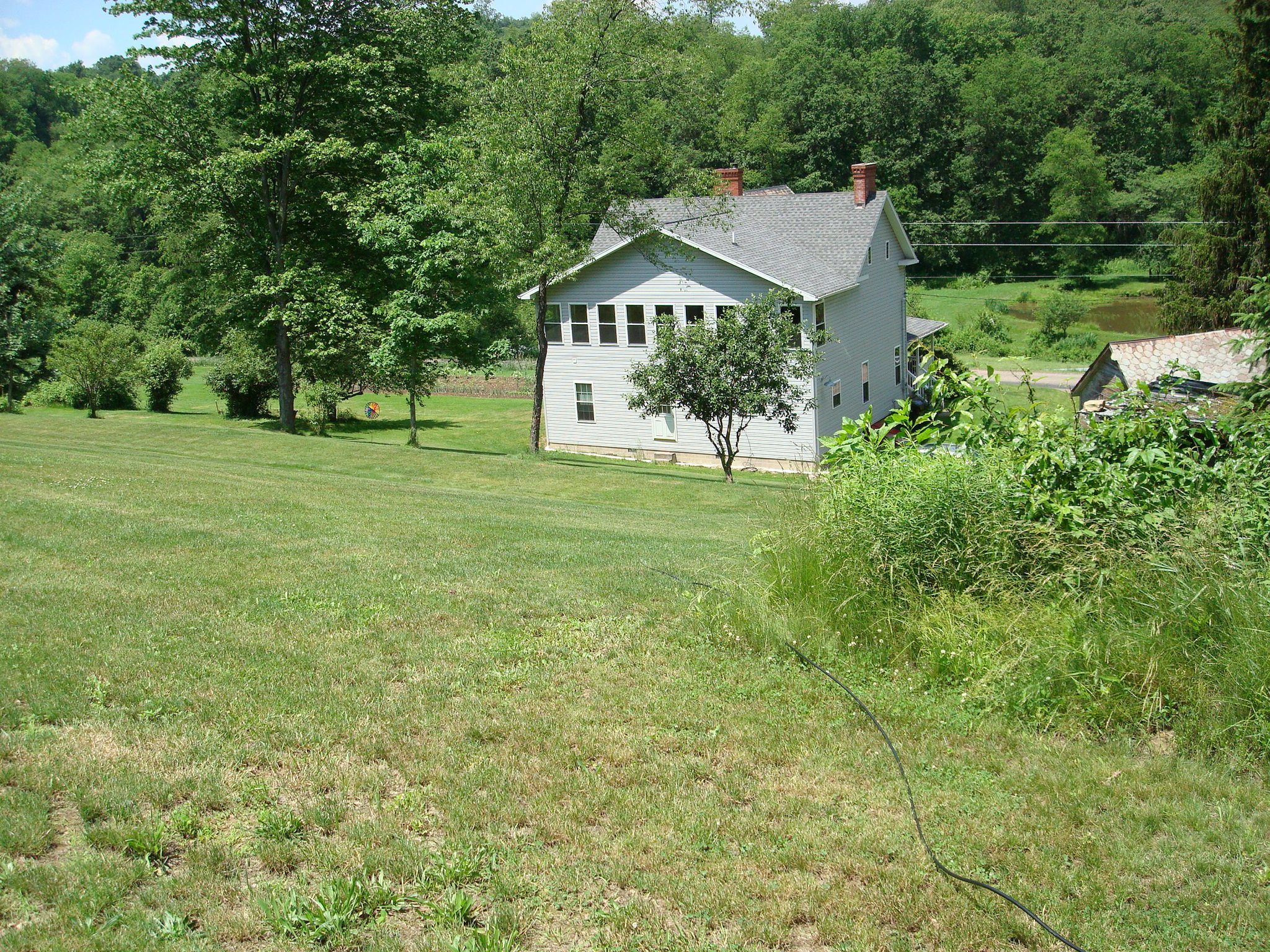

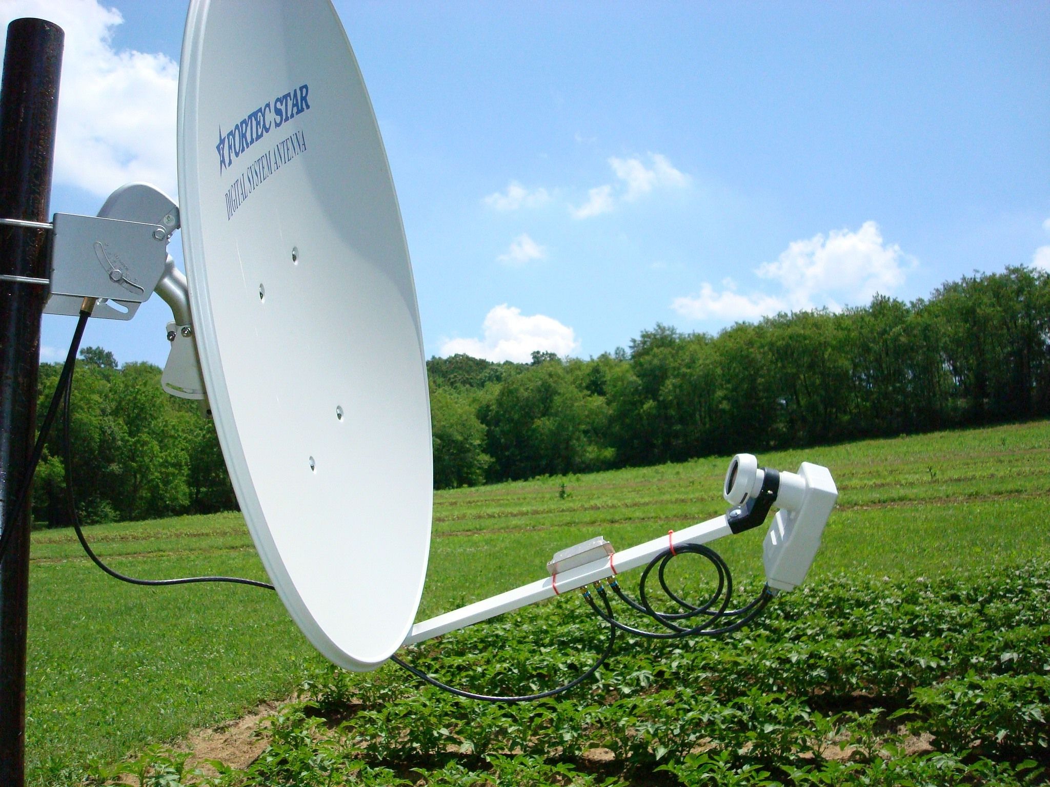

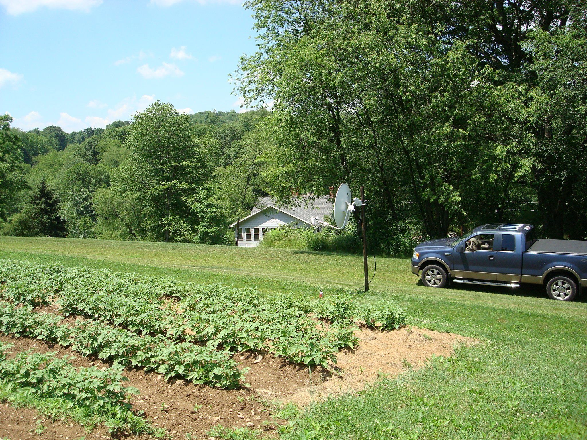

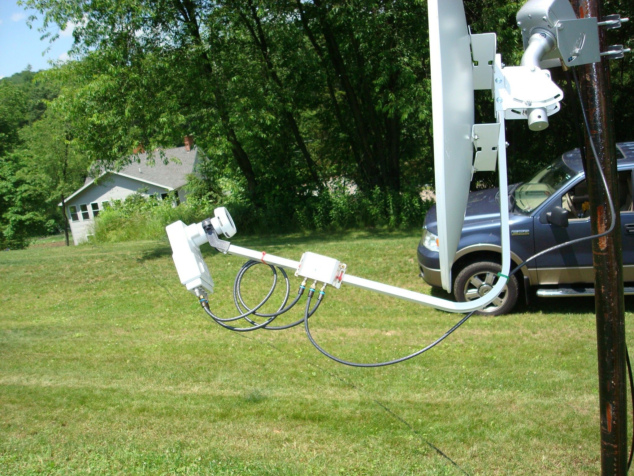

The dish has once again stopped moving. It seemed to work for about 3 hours then after a bit of a break (about 1hour) I went back and no movement. I have attached a few pics, just in case anyone sees anything strange.

On one of the sites I read that if you site from the bottom edge of the dish over the top of the LNBF from behind the dish you are looking at the satellite position. This for an offset dish like yours. It seems from your photos that you could move the dish much closer to your house and shorten that cable.
Satcom1,
I thought of moving a bit closer to the house, but what the pictures don't really show is the large line of trees that might cause me a line of site issue. The dish in the pictures is pointing at G10 and directly in front of the dish about 150-200' away are a line of trees on my property that are about 50-75 feet tall. If I moved closer to the house I would lose about 15-20' of elevation and might not be able to hit the sats on the west end of the arc. Anyway I'm waiting for my new motor (DG280) which should arrive tomorrow and I will see what that does.

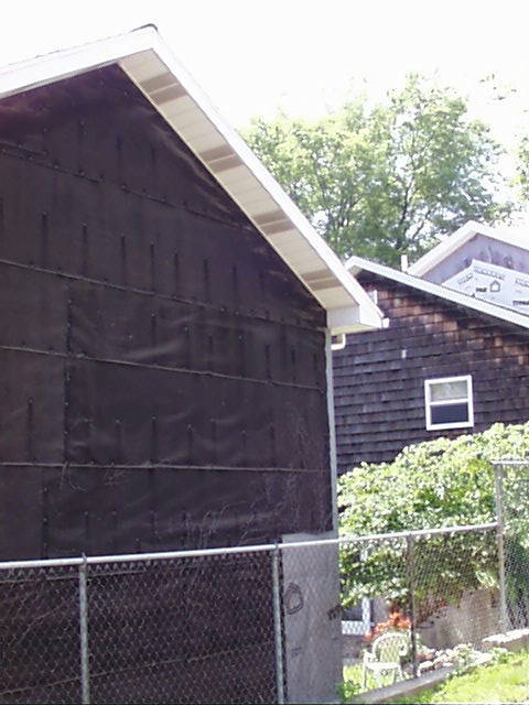

Well. Check the reading on the dish motor to make sure it is at the correct westerly angle. I'm at -89 degrees and 42 degrees and my motor reads about 35 degrees for G18. If you are looking at the dish remember that you have an offset dish and the center of the dish does not point at the satellite. My dish has a 24 degree offset and so the signal comes in from way above where the dish is pointig. I want to upload some pictures of tools I use with my dish and will do that in the FTA DVB-S PCI card area of forum.

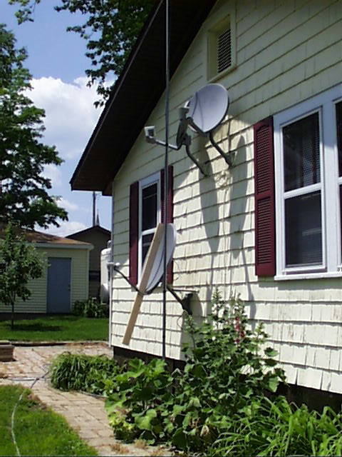

My dish obstructions
This is what my dish looks over.
