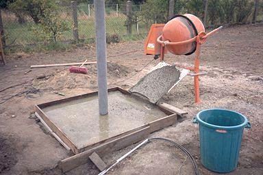

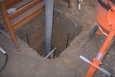

Is just the upper part of the pole wobbling or is it the whole pole including the bucket?
In case of the upper part... your 3 wires may fix the problem.
In case of the whole construction... it might be better to re-do the complete part. The lower part of your pole could use some horizontal steel bars attached to it for some extra stability.

Mr.Arizona, thanks for your quick reply. It seems to be from around a the 3 1/2 feet mark above ground. How about my pouring more cement down the open end of the pipe? How deep/high and what diameter is the pole in your picture?
Yes, poring the pole with cement should do the trick.
The pole on the picture has a diameter of ~8 inches and is 4 inches deep.
Edit: 4 foot deep in the ground, with a steel stud welded horizontal to the pole to prevent twisting/turning. The whole pole is about 12 foot long. The hole in the ground ~ 3x3 foot by 4 foot deep. the top part is 4x4 foot and 3-4 inches high to give some extra stability.
If you are using the light duty fence pole, you will find that filling it will take the vibration out of the pole and the dish clamps will hold better as the pole will not deform when they are tightened.
