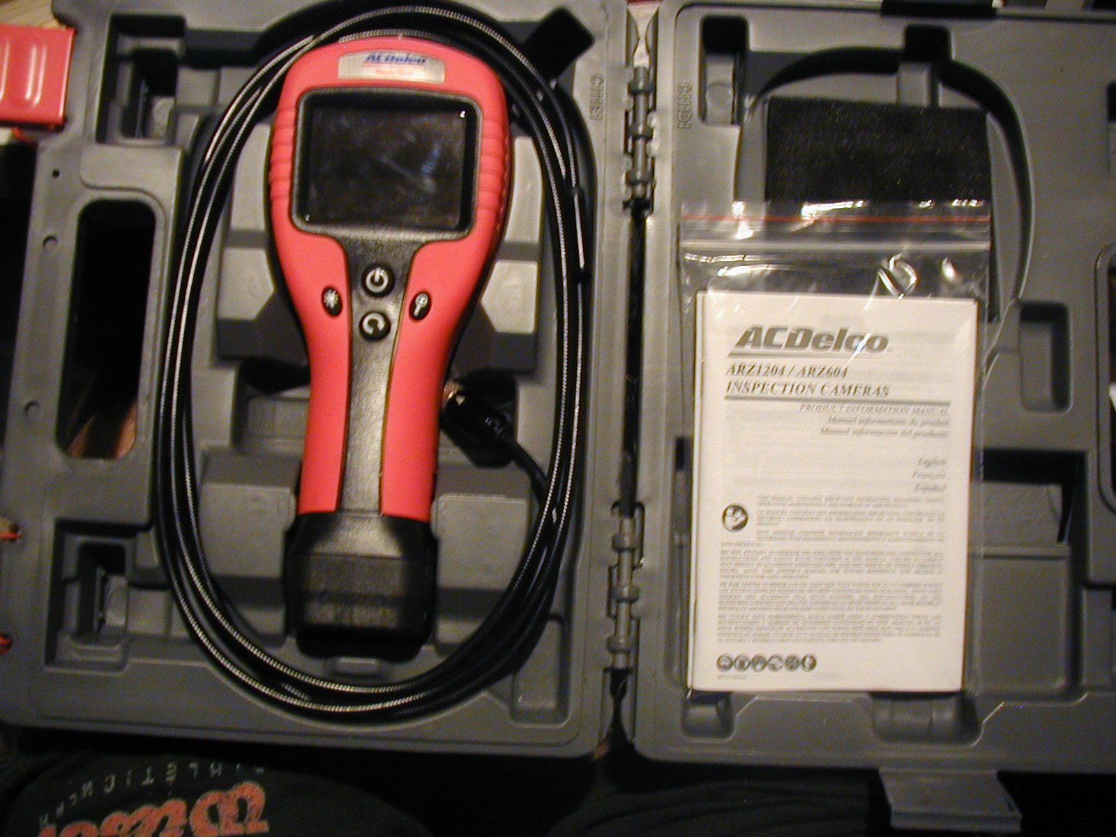

This is what you need, in the picture. If you have a friend who is a mechanic, or technician of some sort, maybe you could borrow one? it's called a bore scope, or inspection camera. The line with the camera can go about 3' into a wall or whatever and is lighted. This one's not the greatest but it's pulled me out of some jams. P1010064.JPG
