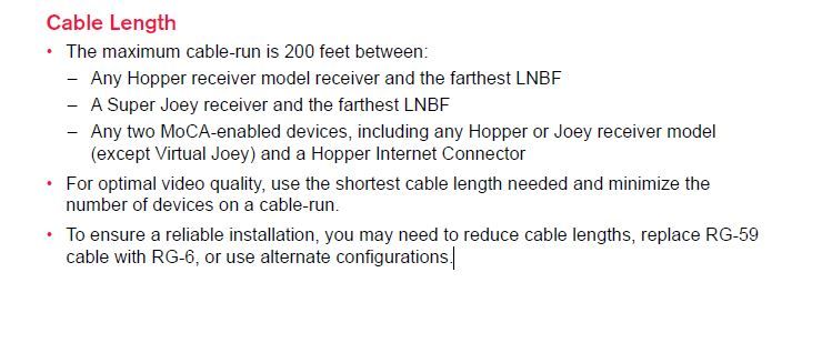

I would try resetting the super joey & the hopper, if that doesn't work distance may be the issue.
I have tried your suggestion and did a reset on the super joey and hopper but nothing changed it still wont link with the hopper. The total length of wire is less then 200 so I don't think it is a length issue. If anyone has any more suggestions I would be grateful.

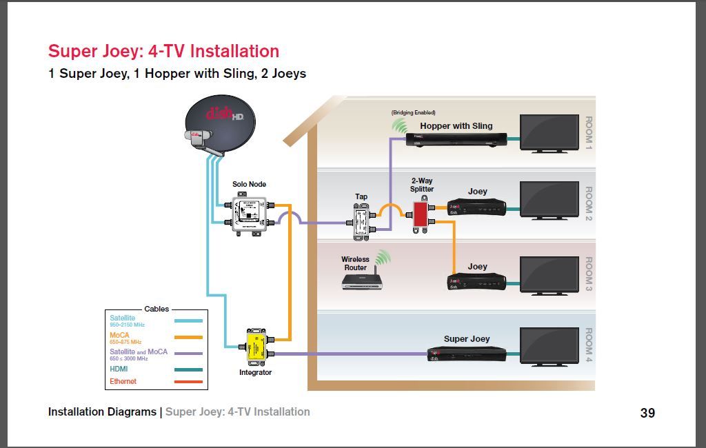

My current setup as installed by the dish guy is similar to that I tried linking to a diagram I made of it but I cant upload it.

I solved my problem I moved the SJ to my bedroom and switched it for the joey that was there. I connected the cable run to my bed room to the integrator and switched my 100ft cable to the 3 way splitter. Everything works like a charm now. Thanks for all the suggestions I appreciate that yall took the time to respond.
