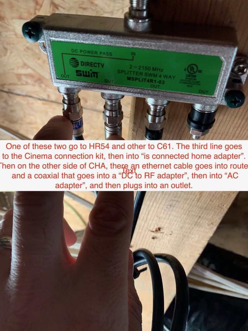

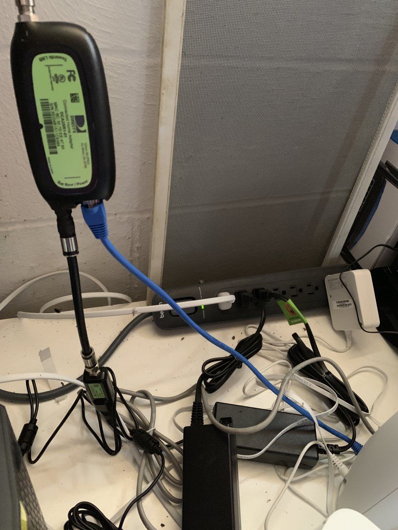

Thanks a lot for responding so quickly. I went into the basement to inspect the SWM and took some pics so maybe it will give you a better visual. I am pretty techy but have never messed with all the DTV stuff, so maybe from the pics you can better guise me.
Thanks again!!

OK, your system is very similar to mine. The leftmost port on the bottom is probably the HR54. The second one is the C61K and port 3 is the network adapter (DECA). Port 4 is open and has terminating resistor connected. What you want to do is disconnect the coax from port 1 and when you move your HR54 move the coax on port 2 over to port 1. Technically you should put a terminating resistor on port 2 that will be open but it will probably work without one. You can probably pick up one of those at a big box home store.
As I said there is probably a two port splitter where your C61K and wireless bridge are located. It should also show the DC bypass on one port. Connect the HR54 to that one.
Edit: You don't have to do anything with the network adapter. Just leave it as is.

You don't need a coax connected where the C61K was connected (second one from the left). You want to put a 75 ohm type F male terminator like the one on the last port of your splitter. You can find them for $0.75 each on line. Any electronics store store should sell them.
