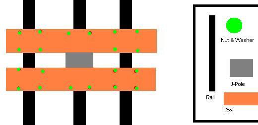

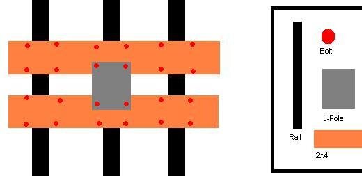

Does anyone know where I can buy a rail-mount? I'm looking into doing without the cinder-block or concrete-bucket and mounting to a deck railing.

You could easily make something similar. You could use 4 equal length pieces of 2x4's. I made the attacked pics real quick to show.
Start off with drilling holes the same size as the bolts on each side of where the rails are for the surrounding two railings on both 2x4's. Also drill holes (above on top, below on bottom) for the middle railing.
Now Place the J-pole mount on the bottom of the top board and the top of bottom board. Make sure both ends of the two boards are the same distance apart. Now drill the bolt holes for the j-pole mount (just on one side).
Bolt the J-pole mount down to the side you drilled the holes in. Now put in the appropriate length bolts that will hold on the other side. Put nuts and washers tight to the first board.
Now take another set of nuts and washers. Put them on the opposite way so they will face the inside board. Leave them just a little bit after where the inside board will sit. Now get the outside board in its desired location.
Place the inside board on the bolts and tighten on another set of nuts and washers. Before its tight grab a level and place it on top of the 2x4, When level tighten down the bolts until the home made rail mounts is securely held in place.
Now tighten down the nuts on the other side of the inside board, just to the edge of the board. Finger tight will be good, Do Not tighten them down snug.
Make sure the inside and outside boards are level. Place the pole back on to its mount. When you get it plumb, tighten it down.
Now if your not moving far the elevation angles should be the same. Check on dish's web site for the azimuth, elevation, and skew. Set the elevation and skew.
Use a compass to find the azimuth and use a near by object as a marker. Place dish on the pole in the direction of your mark.
Move the dish's azimuth until you have the best possible signal. Tighten the dish down securely.
Now adjust elevation until the signal is at its peak. Tighten down elevation bolts.
This shouldn't cost to much, probaly cheaper than a manufactured one.
