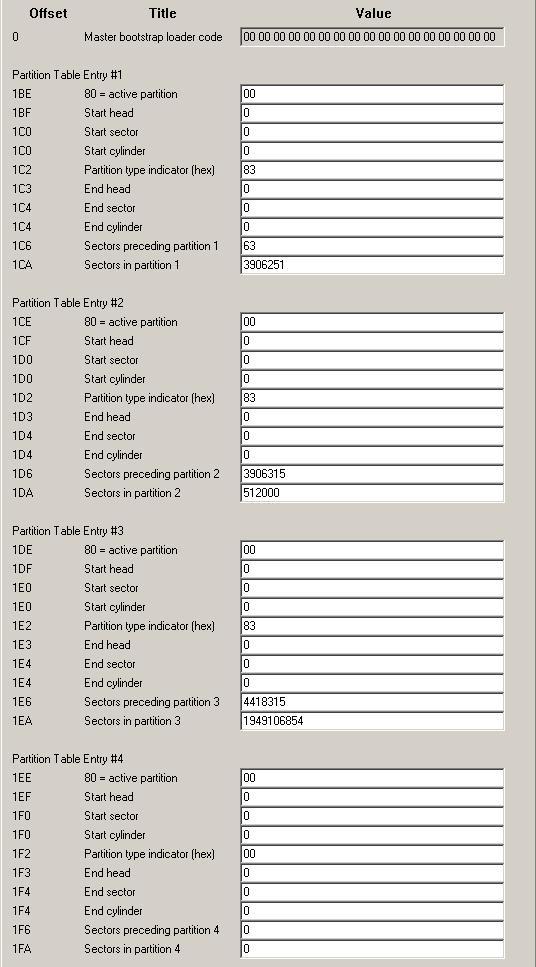

Bought Samsung HD103UJ for $99 - 1TB/7200 RPM/32 MB cache; attached to 211, after press Power button it did reboot then got normal request to format the disk, passed the step OK, then 211 did reboot itself and came with error 955: Wrong size, must be between 50 and 750 GB. :(
Quick analysys of the disk did show normally formatted disk with consistent file system;
as usual all three partitions are ext3 type; first partition have regular size 2 GB, second - 512 MB SWAP, third - rest of the disk ~930 GB.
First/third partitions have typical 'lost+found' folder.

Quick analysis of the disk did show normally formatted disk with consistent file system;
Hmmm, that's interesting. When I looked at my 250 and 500 GB 211-formatted drives, my "swap" partition was 250 MB in size, not 512 MB. I wonder if it's based on the total drive size, or maybe there's a difference in memory needs between our 211s.

Umm, let me re-check. Perhaps you're correct and I mixed up it with second partition of 622 EHD what actually 500 GB or recalling number of sectors (512,000) for 320 GB disk from 211.
Yes, that was my typo. Correct SWAP size is 256 MB.
Below the partition table of 1TB disk in readable format:
