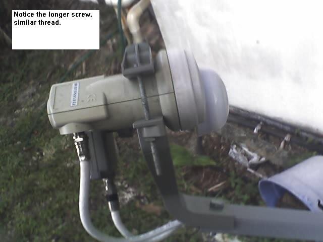

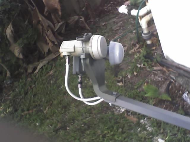

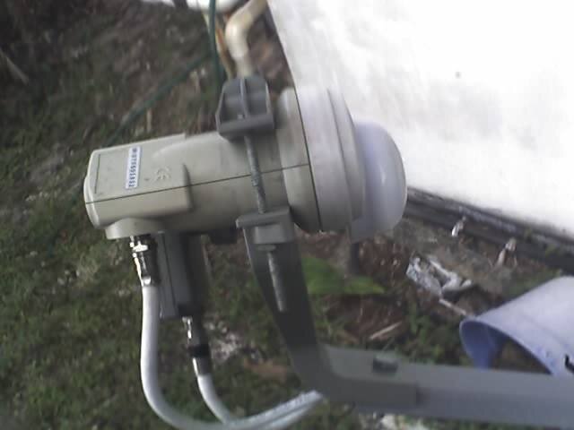

I finally got around to modding the dish for 2 linears that will pick up 123° and 129°. All it takes is getting longer screws to lock the clamp down on the larger (linear) LNB. (129° side) The Eagle Aspen (original linear side) kind of stays locked in with the C120 flange screws nearby.

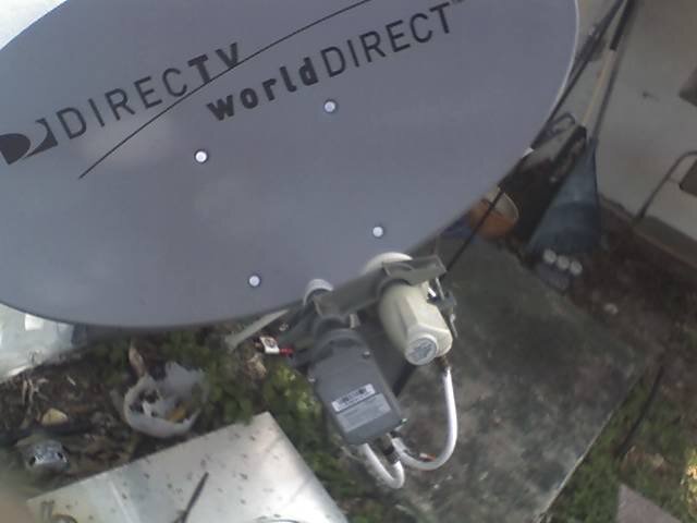

The linear LNB is centered and the circular slot is offside a bit. We know that's not a big deal cause the circular birds have high power. No problems getting Echo 5 or any other DBS slot with that dish since it is 36", more than enough size!

Fresh photos here! (Please excuse my messy South Florida backyard.)
