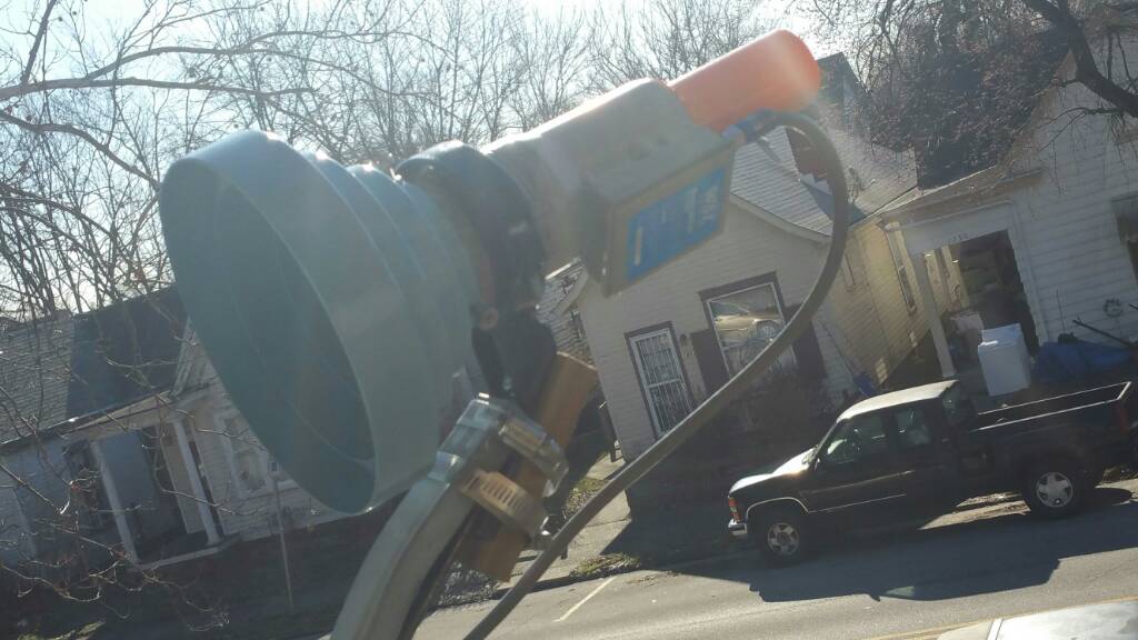

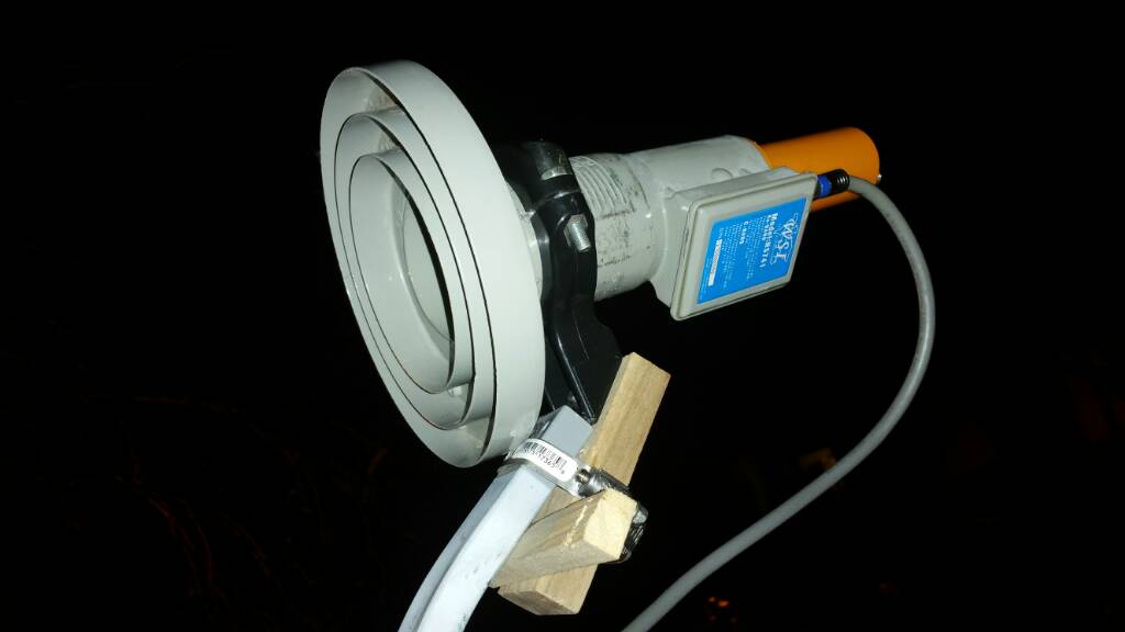

the new 76 cm mini cband...pointed at 97w....amg 51%...latv 50%...walk and Drtv 52%...i had about 30% more signal strength useing this scaler vs the other..theres a drywall screw ran through one of the lnb mount holes to my wood block to help hold it along with the hose clamp..lines up perfect with the origional holder height and angle..il be putting my sg6100 motor on it in next few days for some coffee and surfing..

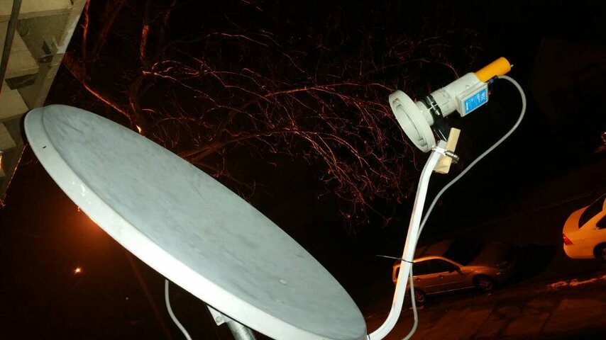

Got the motor on it last nite..but the top bolt for the lnb arm is in way of motors shaft..so i took it out.the bottom still holds the lnb arm and the top is up against motor shaft..im thinkn i can put washers at the bottom lnb arm bolt and none at top lnb arm bolt to give me a lil more tilt and be at the correct angle..its 4 deg off..

The motor and hardware...any better thoughts or ideas? I need it up another 4 or 5 deg.

Thank you...my dish that this one i replaced i ran for bout 10 yrs with the bracket upside down..there was a reason to it but i dont rem why..i just copyd my answers from its install...it was a fortec 80cm..i always installd motors by 1st pickn a sat and manually dish only positioning it..measure the angle of lnb arm..install and set motor..have it turn to that position and set my dish angle lookn at my angle finder..and turn motor assembly till i find it...never payd much attention to dish gauges for setup..just went for proper angles and if it fit....thank you...freash eyes always help
Just went outside....its insane windy..soon as it calms down il take it down and flip it over..i dont want a dish flying off in the wind..lookn at it out here that would fix the problem..im gona surf till then tho.
Reactions: Titanium
Titanium's right, the mount is upside down.
On my DS2076 here, I had the same issue with that bolt getting in the way of the motor shaft, so I just flipped it around, so the round head is faced toward the motor shaft rather than the threaded part of the bolt with the nut.
Reactions: k.r.
Yes it is Spongella. Its alot more chalangeing..im thinking of seein if i can go smaller.and just how small i can go even if its just 1 ch.....i used to love that analog Shepards Channel on 99 c band...that was my test spot..it was almost wave a lnb out the back window and that channel came in..
Mine has a square block that locks to hold it in place from turning...when i tryd reversing it it stuck out the same about because it wouldnt squeeze through the round hole on other side..i flipd the whole bracket mount over and problem was solved....i think thats why i had my fortec 80cm mounted upside down..i think i rember it bein in way of motor so i flipd it and sat angle useing lnb arm and anglefinder...its what i copyd my assembly of this one from...its almost goin great now...love/hate my motor

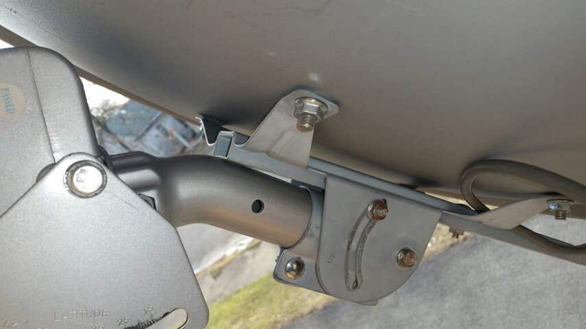

Playing around this morning with the offset scaler i have managed to get it to show more sig now than the flat scaler...moved the lnb farther out and peaked and tweaked for a few hours finding the sweet spot..i dont think I can squeeze one more drop of signal from this baby dish..motor is tracking the arc from 30 west to 121 atleast...couldnt find anything above on the ku..now its coffee time and some mini c band surfing

I seem to remember reading a recommendation for that configuration -- LNBF all the way back, conical scalar all the way forward.

Thats where i found it best for the flat scalar and for the conical scalar lnb about halfway up and scalar back till the lnb is midway of the center most ring..but a immeadiate side by side useing my markings the flat is the best..
