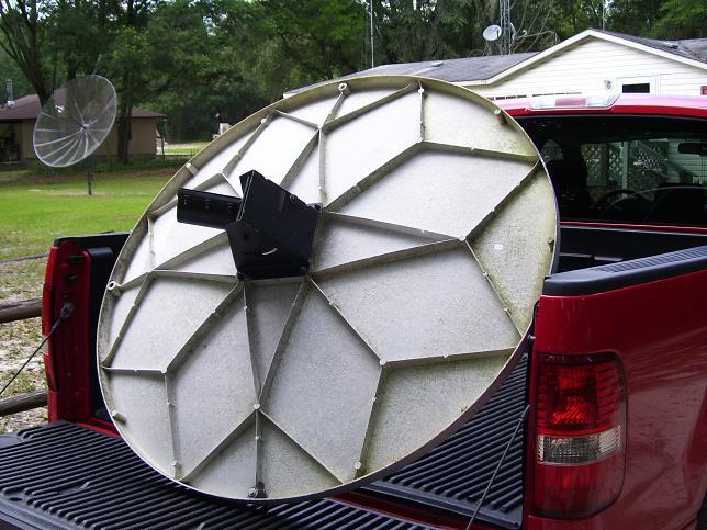

will boys just got a 4ft dish for free off our old radio station in town ,i thinks it a channel master:D
going to replace my fortec 4ft but do you guys thing i will notice any difference in signal and quality over the fortec?

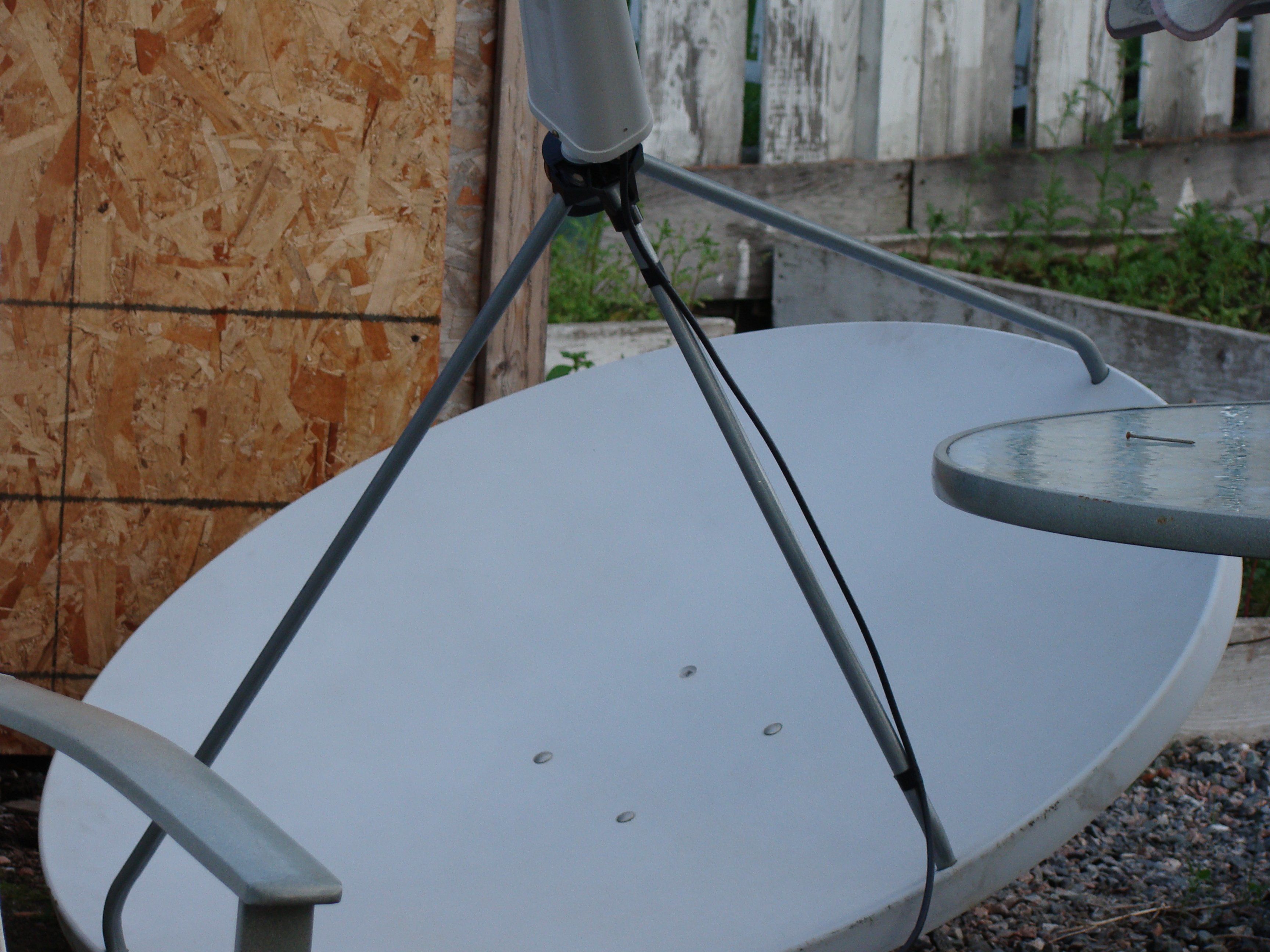

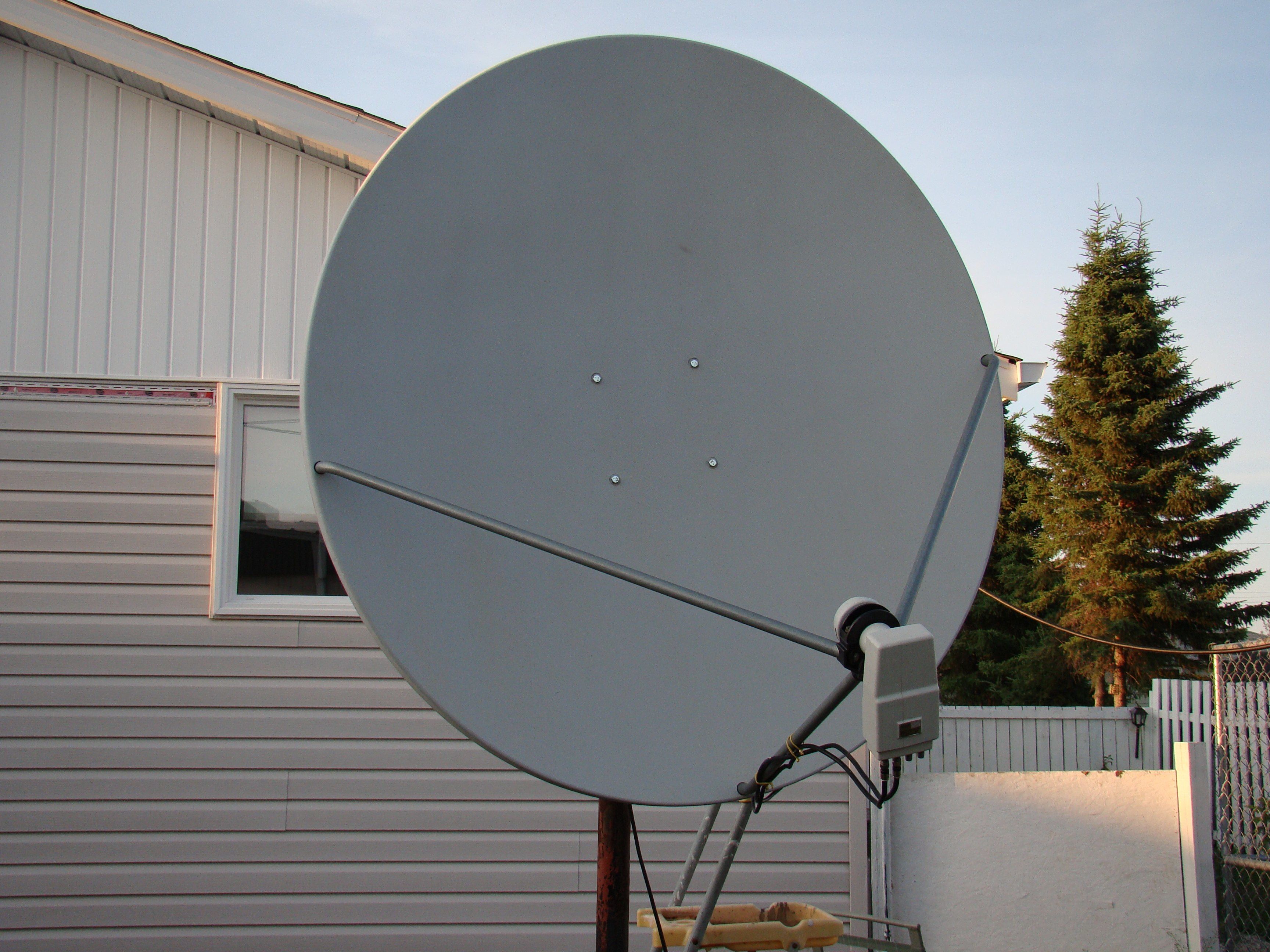

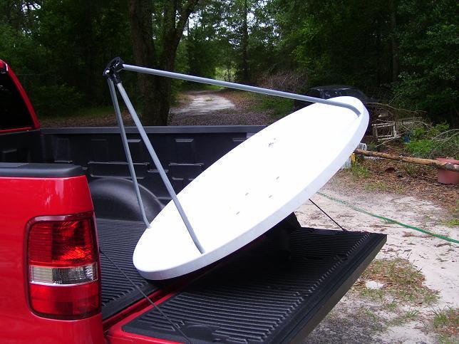

I feel they are the best dishes. I have several. Here's a couple pics of the latest one! :D

the fortec is motorized(Fortec Star HH120 Motor) but going to do some mod to the channelmaster like seen in the forum .also
i had a chose between the channelmaster or a 1.2m primestar so i went with the master.

Nice dish. Check the weight on it if you are going to motorize it.
If much heavier than the Fortec, your HH120 might not be able to move it. I will be getting a few Polar Mounts for the 120 dishes. You could probably fit it on this dish (with a slight modification) and then use an actuator with GBox V3000.

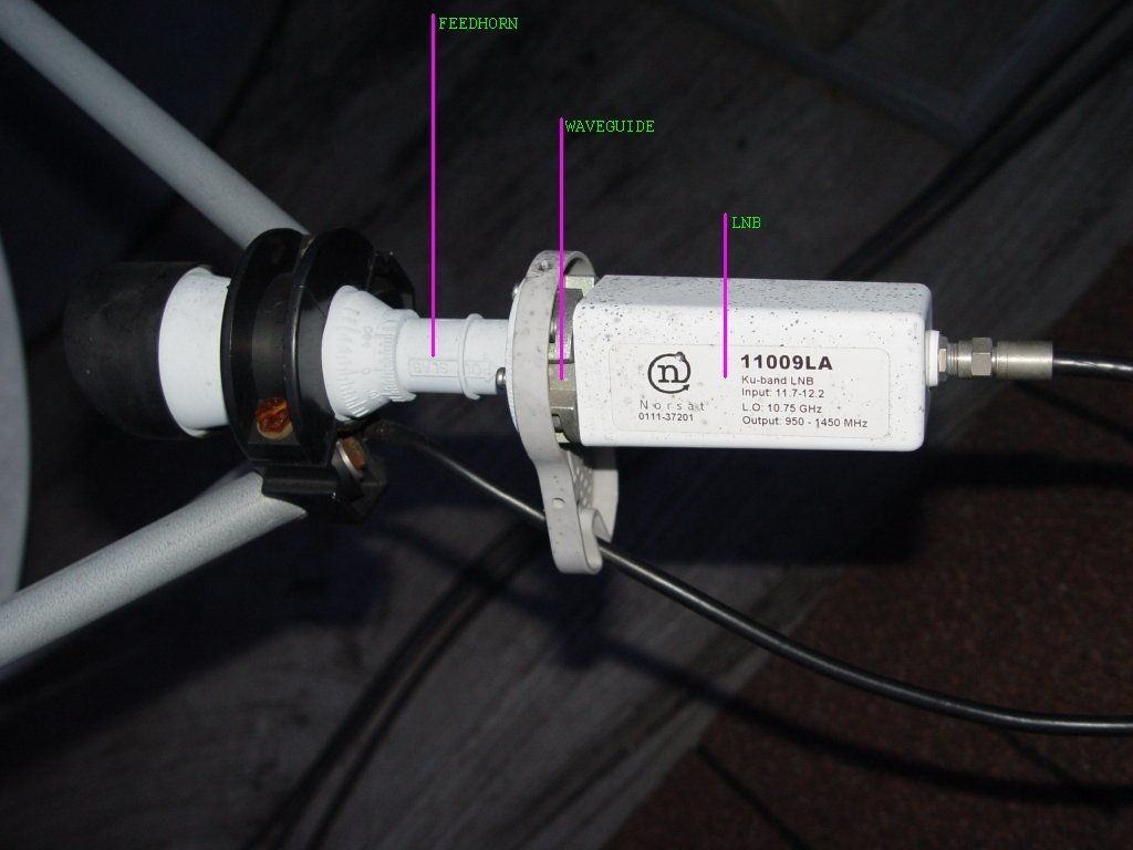

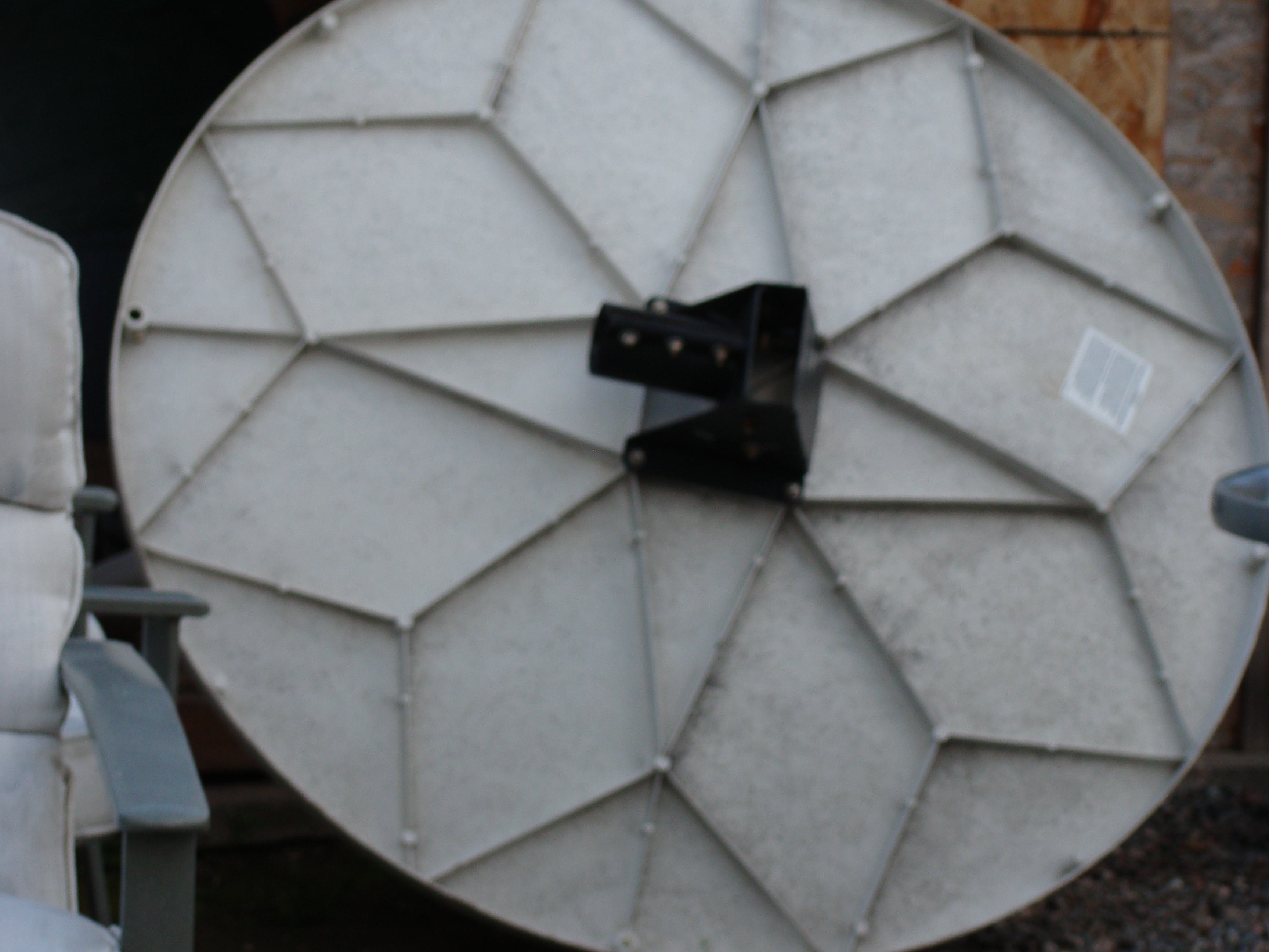

What is the proper name for this channel master dish? I found one in back of a store yesterday and rescued it. It measures 40" wide by 44" tall? Anyone tell me the proper ID of what I found? It has channel master on the back and funny looking commercial lnb on it with a plastic ring that all 3 lnb arms bolt into that hold the lnb. The 3 arms go through the dish and a bolt from the rear holds them in place. thanks for info.
And also one more question. I currently have dishes pointed at 123, 97, 101 and 83. What would be the best of these sats I could use this dish for? Also I assume the lnb is a single polarity v or h so can a aftermarket lnbf be installed on the dish to get both v and h?

There should be a mold # on the back, but it is almost certainly a 1 meter Channel Master like the one I have aimed at G-18 (for the time being, until I can move it to 125w)...
Does the feed assembly look like the one in the attached picture? If so, you can remove the LNB and waveguide. You'll be left with a C-120-flanged feedhorn, which can support a variety of LNBs that will get you dual polarity.
Yes exactly like the one in the picture. Including the rusty bolts. It is still in the van as I am away working so did not have a chance to check it all out. I googled channel master 1 meter and found some pictures of it on line and was glad to find it to be one meter dish. Looks like a keeper. the dish is in real good shape, had to deal with hornets that had taken up home in the lnb cover. I am glad it was later in the day when I put this in the van I took all the arms off and I wanted to take a look in side the lnb cover and I picked it up and could hear this buzzzzing inside. Pulled it out of the van and took the cover off and found a good sized nest inside. If I had not of done that the next day my van would have been full of em.

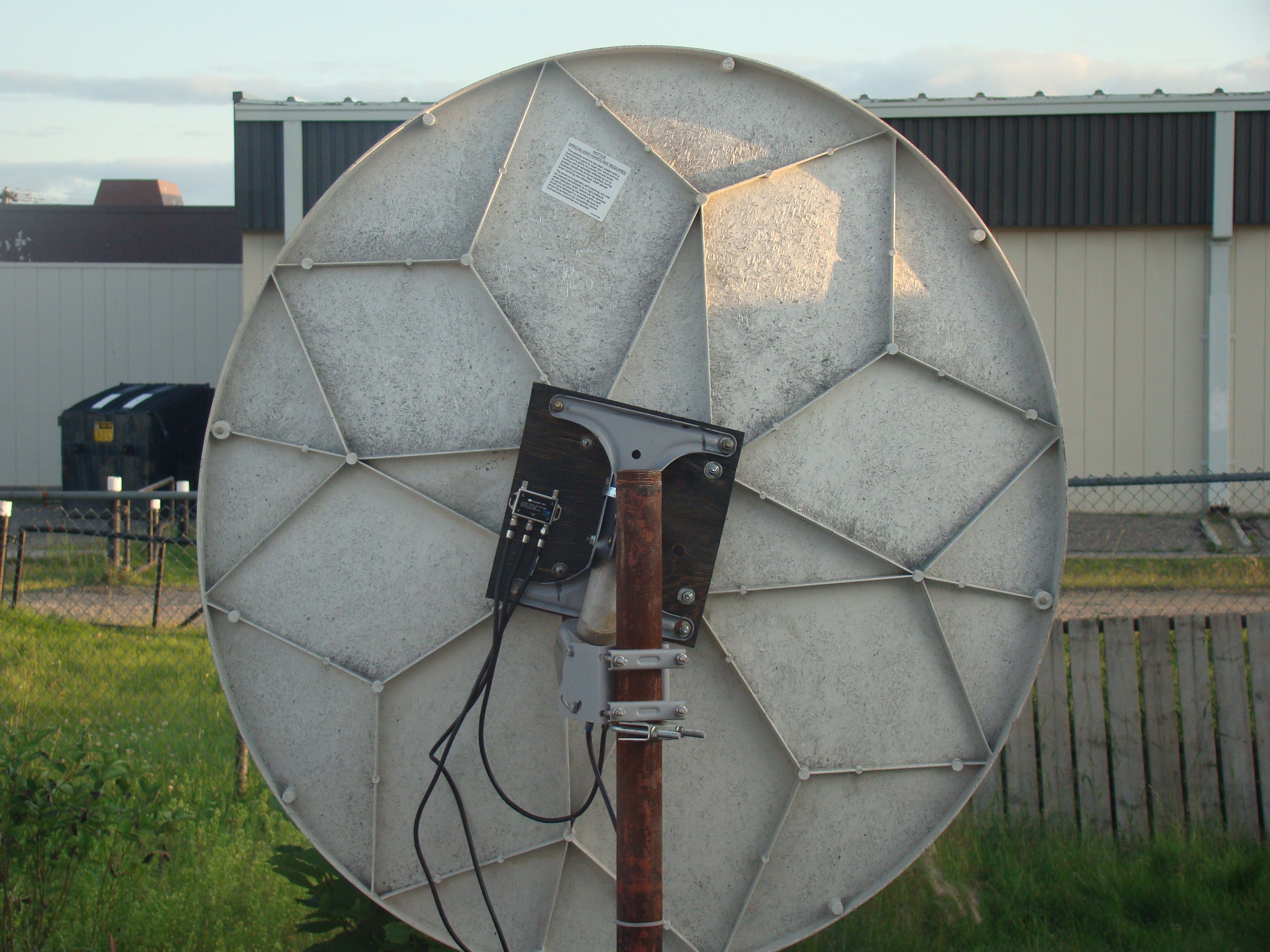

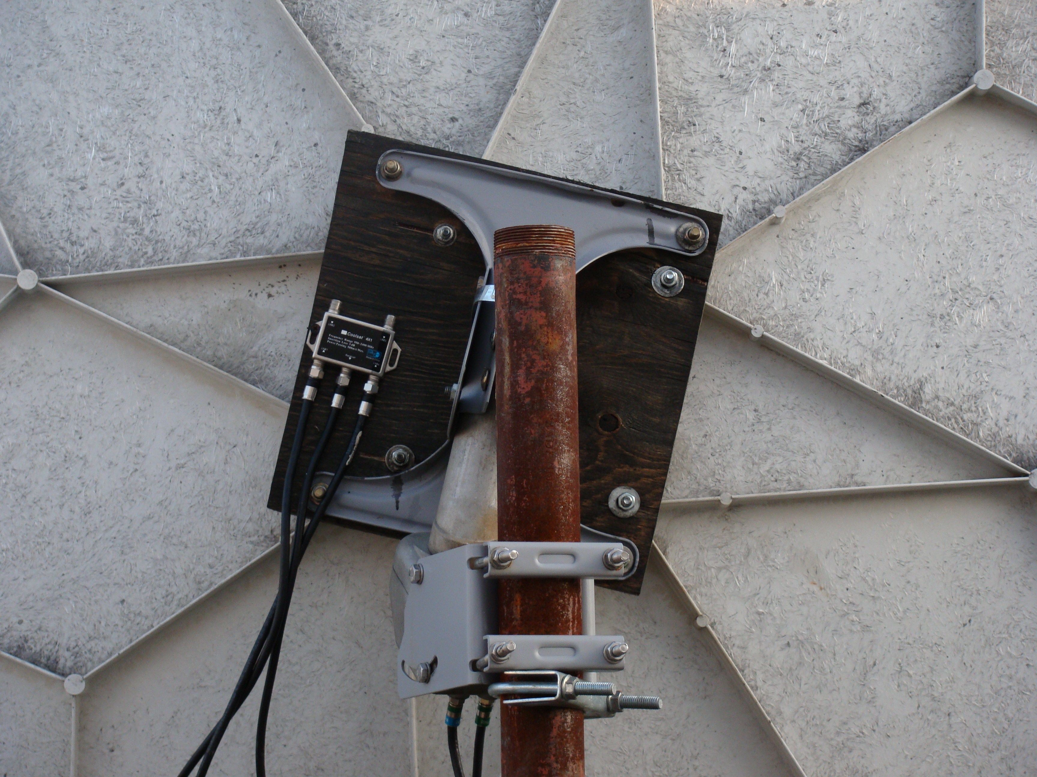

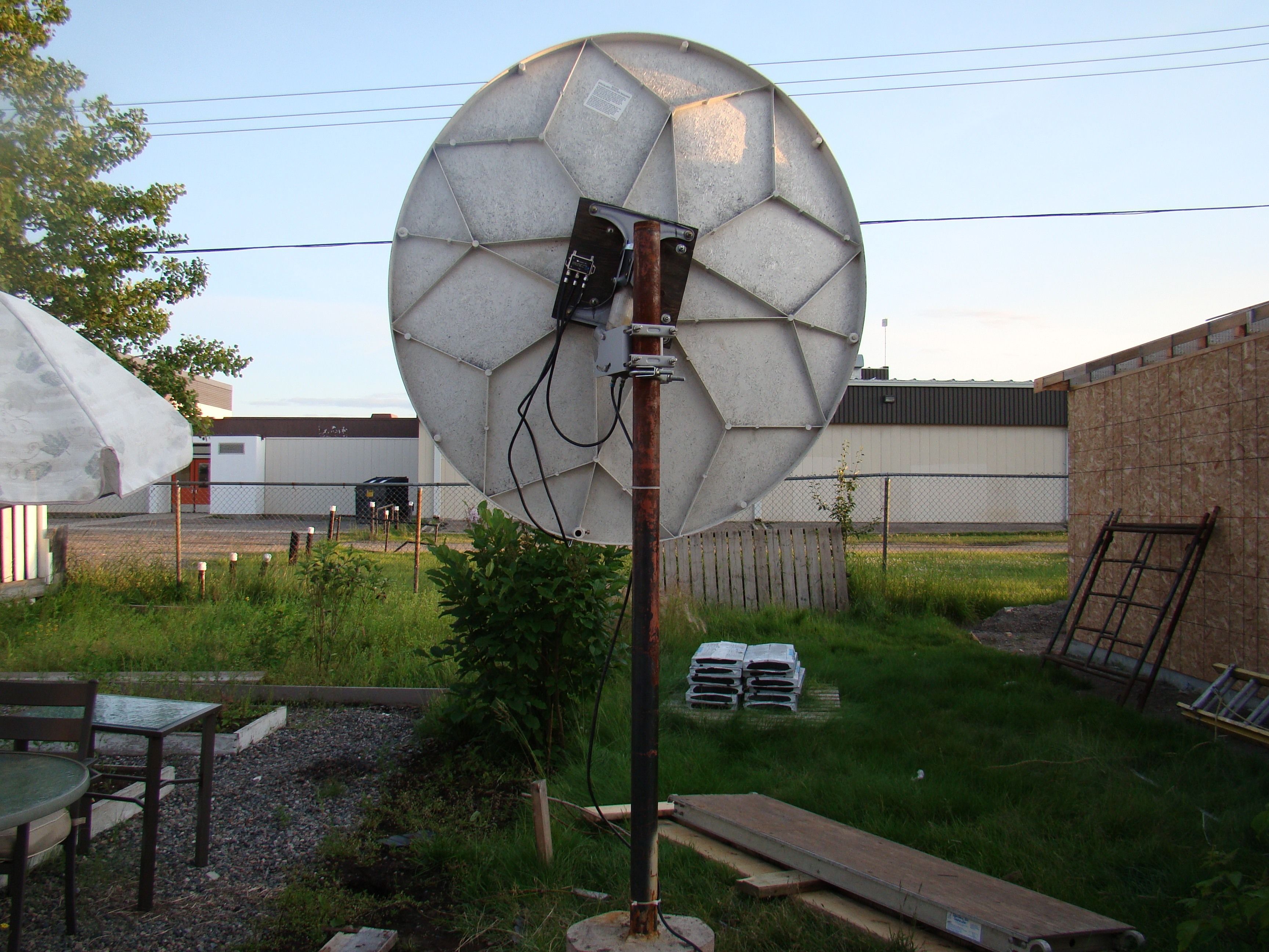

new dish is now motorized:) and working like a charm
thanks guys for the ideas on the dish mod.
also channelmaster made a nice difference in signal quality over the fortec
fortec sat 129ku(white springs) 85% quality now 91%
channelmaster sat 101ku(rtpi) 85% now 94%
