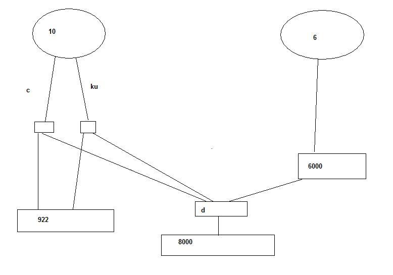

Since you mentioned the CS8000 and possibly an AZBox I'd probably incorporate the 8000 into the 10 foot setup just because those DVB-S2 feeds that the 8000 can get you need as big of a dish as possible to lock those in.
You could probably use the 6 footer with the Coolsat 6000 and have 2 systems. If you run into a HD feed on the 6000 just input it into the 8000. Since the 6000 can't log DVB-S2 (and the 8000 doenst have blind scan) to find DVB-S2 stuff it has to all be inputted. Heck you could incorporate the 8000 into BOTH systems with a diseqc switch.
really bad drawing attached. Just split the C & KU lines from the 10 footer to the 4DTV and a diseqc switch. Use the loop out on the 6000 to the 3rd port of a diseqc switch. This would allow you to watch one program on the 8000 (via the 10 footer) while you scan with the 6 footer
