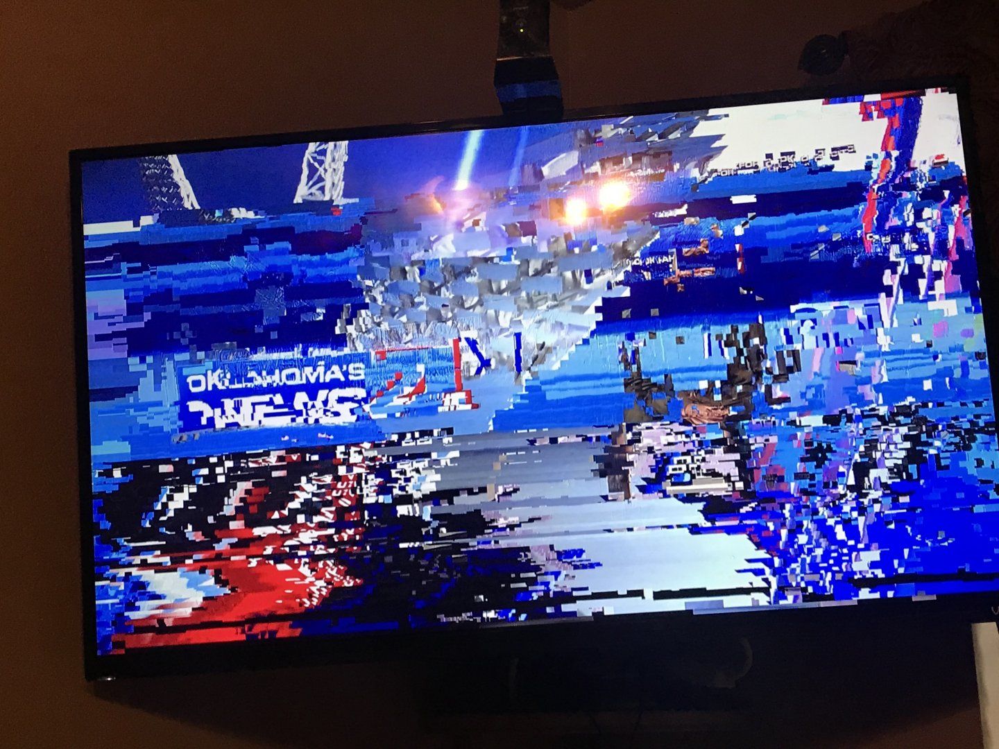

I keep having to reset my Hopper (2 to 4 times a day) because both my Joey's are a scrambled picture, like a bad antenna reception. I've called Dish about 4 times, and they have no solution other than charging me a $95.00 service fee to come out and diagnose the issue. Does anyone have a fix or input what might be causing this issue? Even if I watch a recorded movie it will do the same thing when this starts occurring. I've reset all the Joey's too. Thanks!

I do not see this with my Hopper 3 and 4K Joey with the AirTV USB dual-channel ATSC OTA dongle. However, years ago, this combination was experiencing video break-up was preventing my from recording programs OTA or watching OTA channels on the 4K Joey. Since I'm not seeing this, I'll ask if the artifacting you're seeing resembles what I recorded two years ago:
Reactions: ouch1234
Upon turning off the HWS and moving to a TV with a Joey, I would many times get that ripped/torn picture.
I also used to be forced to do a RBR to my HWS to get the Joey to display properly, very annoying. But I discovered that if I switched my Joey to an OTA channel for a while, this issue would clear itself up. Sometimes just moving through several channels will eventually clear things up as well. An obvious software issue.
