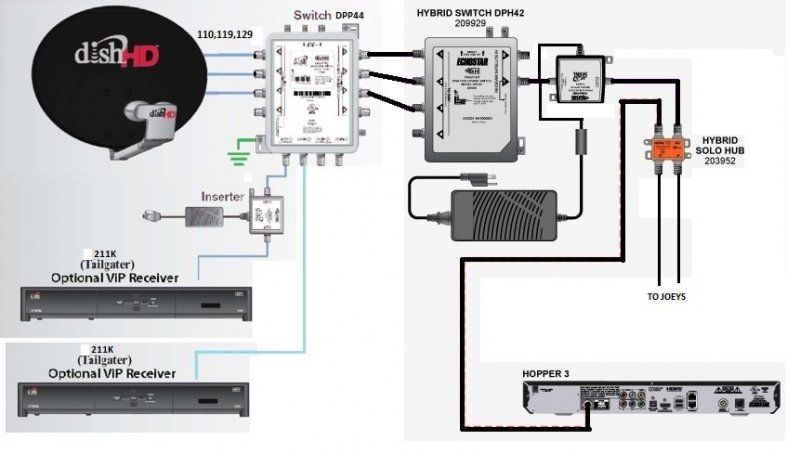

Since you already have the DPP44 switch, I would recommend adding the DPH42 switch to your existing configuration. This would give you the option of adding Wally or ViP receivers later. (211 series only, not your dual tuners which Dish would not allow to be mixed with Hoppers on the same account) HipKat can provide the diagram if you are interested in learning how to connect the two switches together.

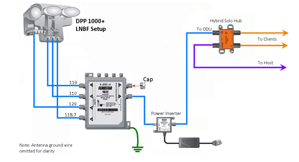

There is some rewiring. You have to run 4 lines form the Int'l dish to the 42 Switch. And they connect to the switch in a specific way
Here
I'd like to see the setup for a 44 and 42 switch combo. and if the cabling from the Dish to 44 switch stays the same and the 44 switch to 42 switch
Thanks charlesrshell. I knew someone around here would have the diagram. The only other thing that performanceisland would need to remember is that for the international dish, all four lines would still be needed for the DPP44, and then four lines connecting the DPP44 to the DPH42.
Welcome. Someone posted it one time and I saved it. Not sure if DISH legal or not.

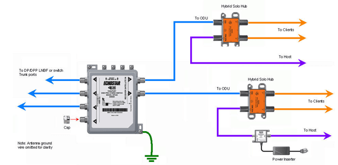

so i need a power inserter with the dph42 switch exactly as shown with this diagram as well?and its ok to connect the power inserter to the hybrid solo hub as shown in pic?
ps i have the older dish 1000 plus with the 118.7 lnb integrated with the 119 having one output for each orbital location and the 110 and 129 being separate on each side, i should not have to rewire anything using the same dish and wiring to my dpp44 switch and then from dpp44 to dph42. or do i also have to replace the LNB on the dish?
You can put the power inserter after the hub also, but it has to be on the host line - the line to the Hopper plus you'll need (i'm sure) to replace your LNBF with a DPP500+ w/DP Dual for the 129
