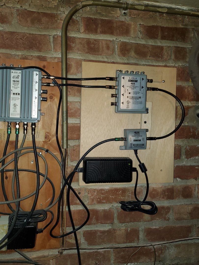

This is how my wally is connected to the garage right now. From the 44 to 42.
Going to connect a Solo hub to the top connector to a Hopper3.
Will that work then?
