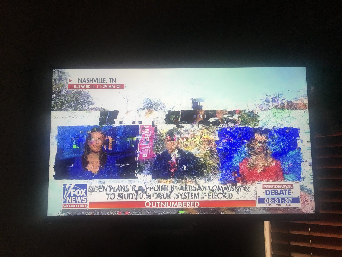

My TV's are like a bad antenna reception.
They said the Hopper Duo is only allowed for up to 2 TV's . They are given us a $15.00 credit to account for the Super Joey for next three months (Contract is up in 3 months) , and if this cures our problem of pixelation they will give us a $20.00 per month credit for 24 months if we sign up again in December. Our bill will be $51.00 per month.

Well they sent the whole team out. Luckily I was getting the pixelation when they all showed up. All signals were perfect after running test, etc. They installed another new Hopper 3 and installed two new wired Joey 3's . They aren't buying that the U935 update is the problem and did a manual software update on the Hopper. We'll see how things work out. I just laughed at them when they told me that the wired Joey 3's would not pixelate (Guaranteed) this time.
My wired Joey 3.0 has pixellated from time to time. Had to reboot the Hopper 3 the last time, changing to an OTA channel would not clear the problem.
Did you tell them that you know of many other folks here at SatGuys that are experiencing the same issue? That some even had all of their hardware replaced and it happened again?
Unfortunately, the proposed downgrade to HWS may have actually been the better option. I went back through a couple of the Joey pixilation threads here, and only found one HWS user who posted about this problem. (The same member posted in a couple of the threads. I also went through a third thread, with no HWS users complaining in that one.) So, while this issue does happen on other Hopper models, it seems to be a lot more rare on those. Hopper 3 is by far the problem child here.
Yes, and I even showed them the posts. I'm assuming this isn't a big problem in Oklahoma, Yet! They said they'll do whatever I want them to do if it starts again. I'm just happy it was pixelating when they showed up. They were running about an hour behind schedule, which worked out perfect, because it literally started pixelating about a minute or two before they showed up.
We made it about 30 hours before it started again. I'm going to go ahead and downgrade my system with the hopper w/sling and try it.
Update: I'm a little reluctant to post this, and I'm knocking on wood as I type this, but after my post from last Thursday and another 3 hours on the phone with Dish on Friday my system has worked perfectly . I haven't had any pixelation in over 5 days now, and haven't had to reset the Hopper3 once. They have done something to fix my issue. I'm planning on calling them today to see if there is any notes from the engineering department of what they may have done so I can share with you guys, The only new issue I seem to have is my bedroom Joey3 won't do the 10 seconds rewind when you tap the rewind button ( Tried two other remotes) You have to press and hold and do a fast rewind, but I can live with that. My other Joey3 works just fine. I'm a happy Dish Customer again!
