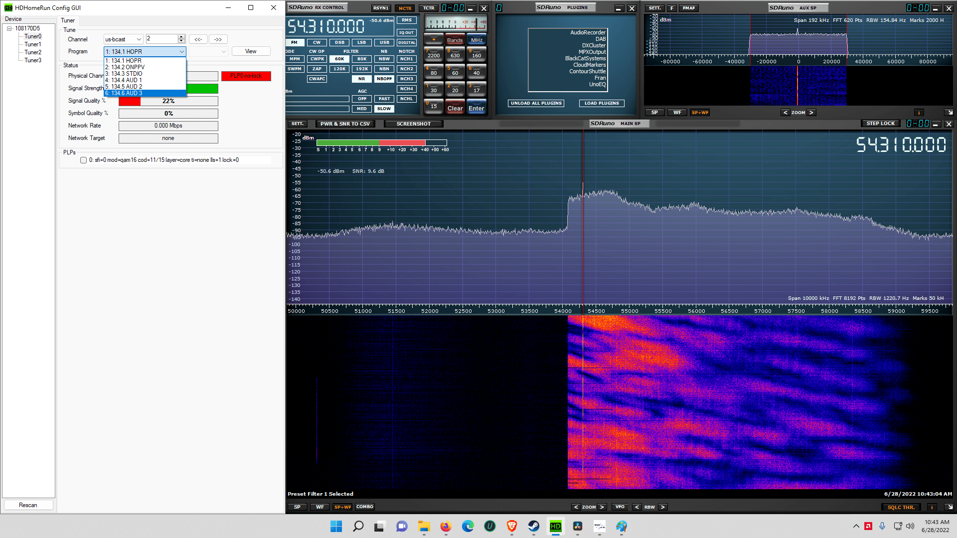

I caught this mysterious ATSC 3.0 Signal, on Ch. 2, using my HDHomerun Connect 4K & SDRPlay RSP1A, both of which use the same ChannelMaster outdoor antenna & amplifiers, in Carrollton, MO. The signal has weird program information. Does anybody here have any clue as to what ATSC 3.0 TV station I was receiving?

Probably a tropo event. It's the right time of the year for it. VHF-LO signals can carry pretty far.

I’m not familiar with the SDR software that you are using, but the pilot carrier on 54.310 suggests to me that it is an ATSC 1.0 station. This is E-skip season and channel 2 is the best channel for sporadic E. Based on the distance for E-skip, I’d guess KJWP in Wilmington, DE.

From what I've since found out, the signal that my HDHomerun Connect 4K was picking up was KBRO-LD, Fort Collins, CO, which broadcasts in ATSC 3.0. I did also briefly pick up KREX-TV, Grand Junction, CO (I forgot to mention that.), which does broadcast in ATSC 1.0, briefly just a few minutes, or so, before making that screen capture. The 2 signals were probably mixing, as both of them are on Ch. 2 (ATSC 1.0 signals have curves on both ends of their spectrum with a pilot signal, ATSC 3.0 signals have cliffs on both ends with no pilot signal. The cliff, on the left, was from KBRO-LD, the pilot signal, & possibly the rest of it, was from KREX-TV).
