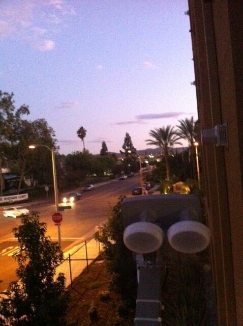

I'm guessing you are in an apartment and can't put the dish anywhere else. Do you have a photo from behind the 118 dish showing your line of site?

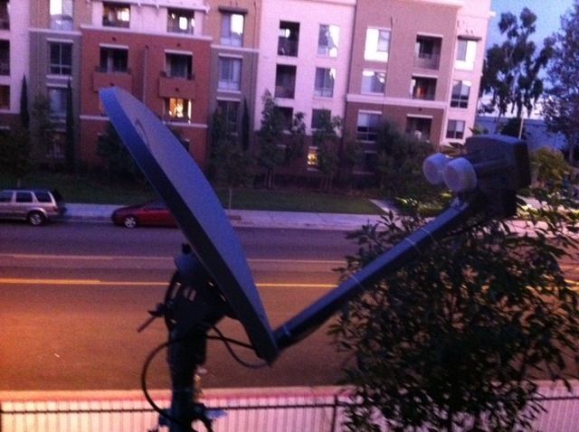

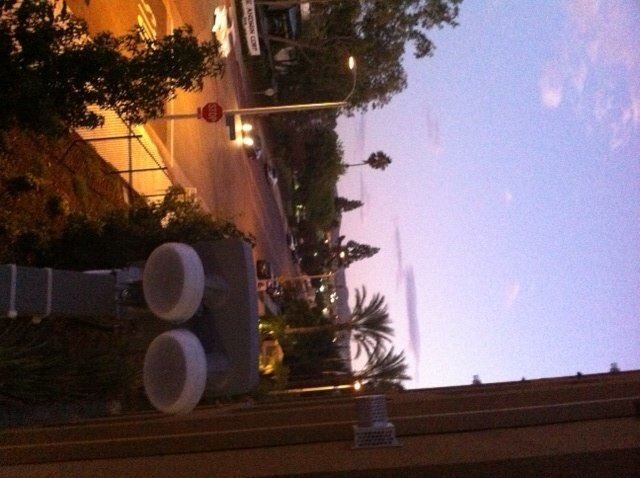

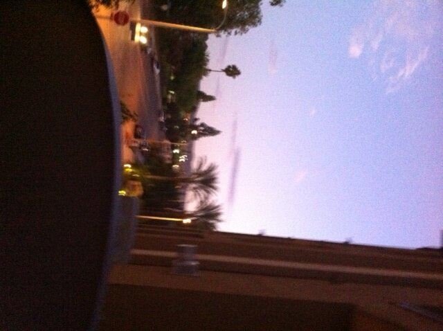

Here are my installation pictures. What do you think. Can I get 129? That would be just perfect.

ok so it looks like your line of site issue is due to the building...oof that may be tough. It looks very close but you might be OK
This is what I have done. I have contracted a dish network installer. This guy is good. he tries very hard with all installations. He is the one who got me my 61.5 satellite. offcourse he will charge me but says he will use a longer mast and test the signal out.
The extended mast might work.
Did the first installer have the 129 bracket and lnb on the dish when he tried to sight it in? Neither are there now.
