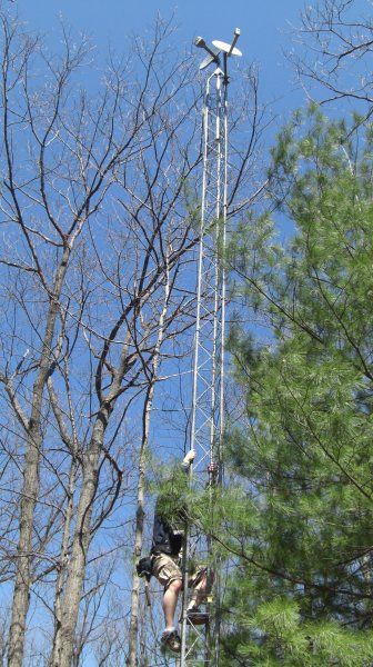

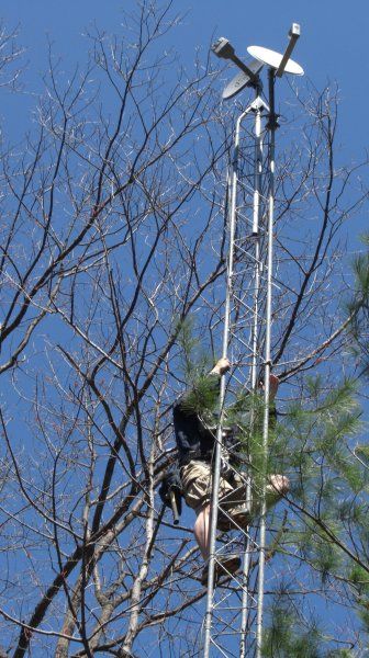

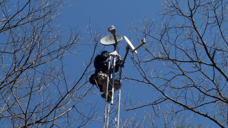

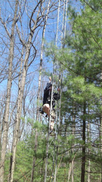

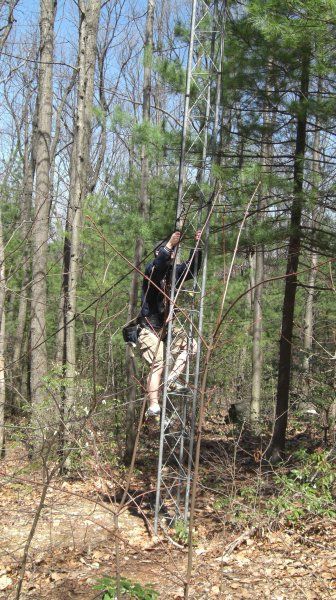

NO!
Do NOT climb that tower! NOT safe and no pointing will work due to bending of tower as the guy climbs. Unless it is guy wired to the Nth degree, which I don't see.
All risk, no reward.
