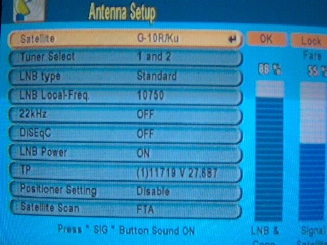

Lets say you have a standard LNB. I still need to know.
LNB type is standard
LNB freq is 10750
22k off
diseqc off
LNB power on
You are going to have to add Satmex6 to your setup. In the menu
Antenna setup
edit satellite/TP
scroll to "new" and enter the info I posted in post 4 and save it

The Invacom quad has a LO of 10750
so where you have "Single SL and 5150/5750 change that to standard and LNB of 10750

The screen should be like this (the satellite name and transponder will be different for yuor true south but the rest is right)
