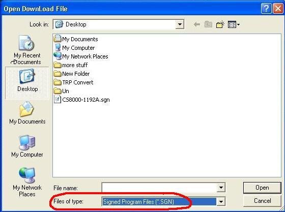

Change file type to ".SNG"
I don't know how to do that, can you tell me how? I tried right clicking on the clean file that is not zipped and scrolled down to the 7-zip and a box to the right opened. I clicked open archive. But from there I could not see how to change the file.
See new Pic above.
I've yet to see a window that looks like the one above. I may have done something wrong but I don't know what. I created the folder on my desktop and opened all the attachments into that folder. I right clicked on them and hit extract here with the 7 zip program. But when I double click on the extracted files I do not see the window that you show in the picture above. Instead I see a windown that says "choose the program you want to open the loader file with " and the options are things like adobe, 7-zip, internet explorer, etc. Where did I go wrong?
