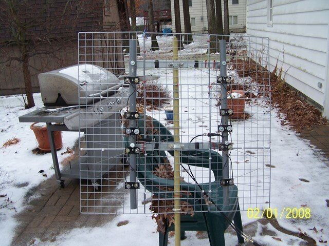

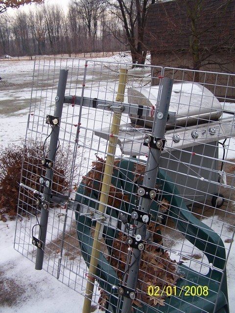

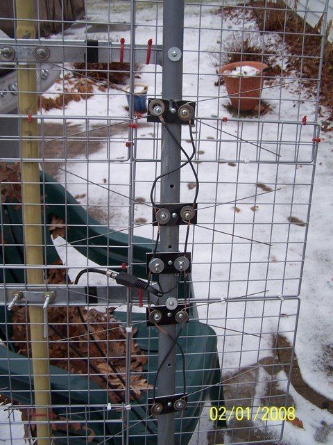

Yesterday I build an antenna very close to a Channel Master 4228. I am picking up stations that my old Radio Shack antenna was getting at 0%. My signal is now over 60% All the stations are UHF though, so I am gonna have to build a VHF antenna. Do anyone have any idea on one that I can build??
So in this case does size matter? the bigger the better for the antenna?
Meh, like everything else, it depends. I have mine in the attic, I built two 8 bays and they performed no better than the four bay so I just use the four bay. I found that leaving the reflector off helped for me.
I am from a family of welders so I was lucky, I got some nice TIG aluminum welding rods to make mine. It works fine for most signals 20-30 miles out.
For a UHF bow-tie type antenna, the number of bow-ties is what gets you stronger signal. Each step doubles your signal from 1 bow to 2, 4, 8 even 16. Size will necessarily increase to make room for bow-tie spacing.
