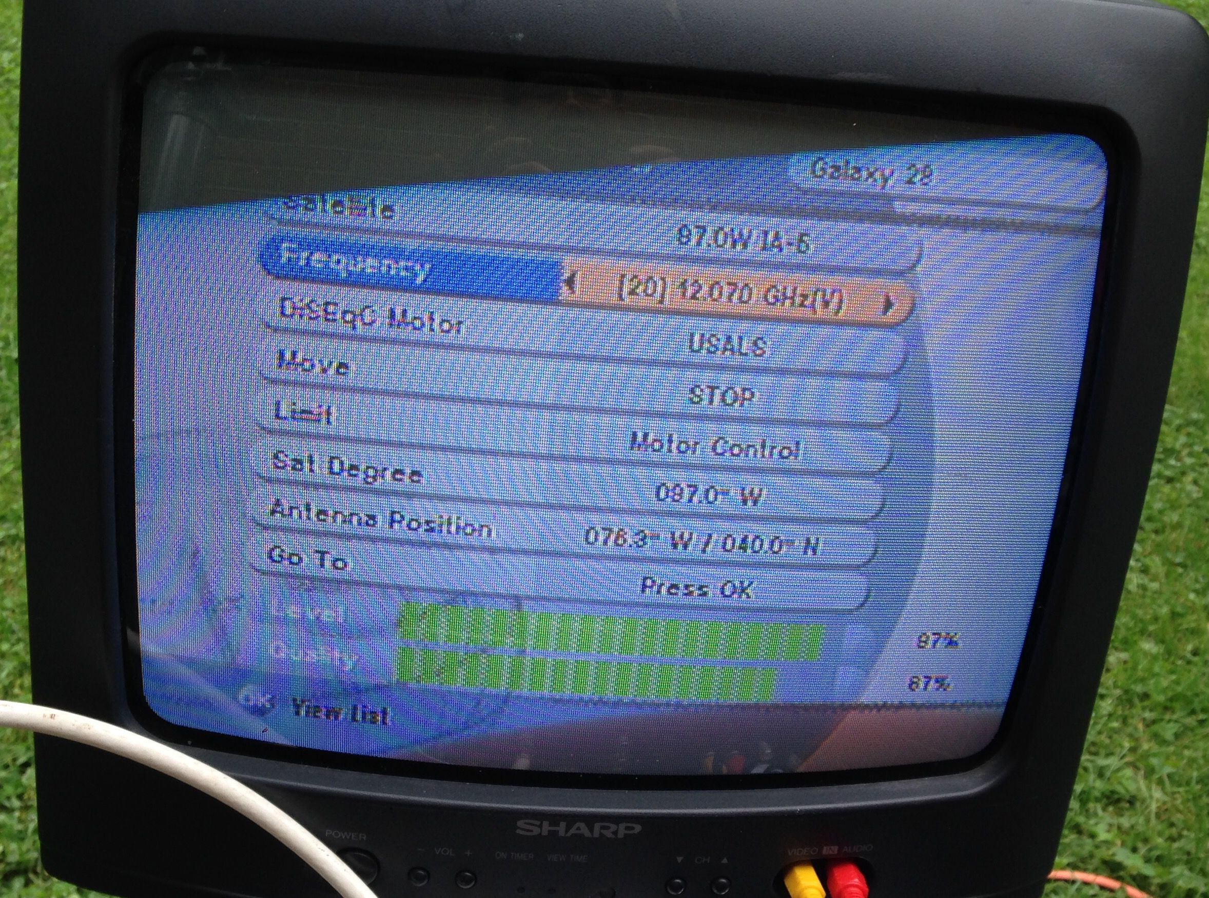

Trying to get 97w and having a hell of a time! Not sure what I'm doing wrong but managed to get this below. Scanned for channels and got one! It said Galaxy 28 on the top right. Is this another satellite? Am I even close?

Trying to get 97w and having a hell of a time! Not sure what I'm doing wrong but managed to get this below. Scanned for channels and got one! It said Galaxy 28 on the top right. Is this another satellite? Am I even close?View attachment 116349
Your Coolsat knows where it is,you are on Gal 28 at 89w.You need to move west 8 degrees.There are Hughsnet transponders on G28 that ID the sat,there's nothing to watch there tho.

Ok! So I got the level bar up to 97 but the quality bar at only 5-6, then it started raining again so I had to stop there! What do I need to do to get the quality level up? Is there a certain settings I need to input in the receiver (frequency, transponder)? Any tips would be greatly appreciated, thanks!

I got it you guys!! After reading all your posts over and over, and the rain finally stopped. I put in the transponder like KE4EST and FaT Air said. Moved the dish, and in less than 10 minutes, I got the green signal bars! Got it to peaked out at 91. Did a blind scan and got 195 tv and 76 radio channels. Most importantly I got 11 Vietnamese channels for my parents to watch. They love it!! The FTA gods smile upon me! Thank you all for your help!
