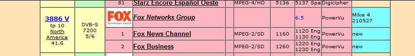

I am attempting to lock 131w. So, i am near that. Can some one identify where this signal is coming from?
3885V 7200 DVBS
Never mind, looking through Lyngsat, i believe i found it.. Im at 133w... I think i will attempt to fine tune off this DVBs signal to get my dish height/angle more accurate. Unfortunely, this is a pain, because it only lets me go up and down about 10 degrees, and the motor on here is dead, so im using it as a lock bar, and sliding that up and down the shaft to get the height, so a real pain in the butt.

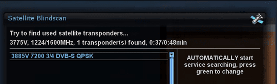

Yea, its usually 30 pulses for every 2 degrees. I use that method on my other dishes... But for this particular dish, there is a DEAD motor holding it in place. I had to remove the motor and manually bring it in. Then i was rotating the dish on the pole and using a digital angle to try and pre-set it. - I wasn't having any luck, and went in side and just for kicks, i did a blind scan, and it saw the fox TP @ 133, but wouldn't scan anything in.
I then put THAT fox TP into my signal finder, and adjusted the height of the dish to tune to that TP. That got me close which then allowed me to rotate the dish to 131w and lock the signal and then i fine tuned it.
