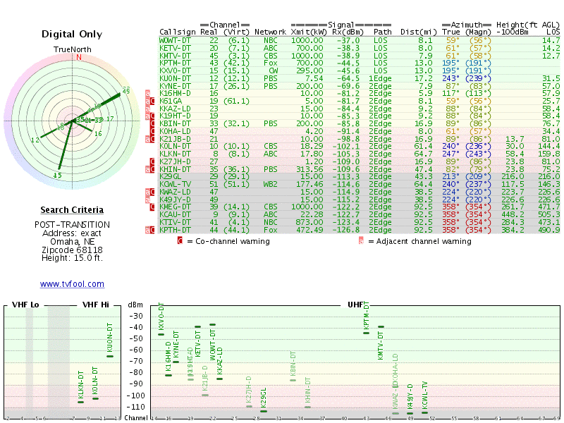

Help,
I live in Omaha and find that the tower locations are a nightmare for an OTA antenna. Some stations are located in one direction and several others are over 100 degrees off. Another important one to me (PBS) is 180 degrees from the majors.
Someone has suggested that I mount an Antennas Direct DB-8 but separate half of the array and aim them in the two major directions. Does this sound like a smart move?
BTW, my main TV is in the basement fully shielded from all towers, so indoor is definately not an option. :rolleyes:
Anyway, any and all help will be greatly appreciated. The attachment is the particulars from TVFool.

KUON is located at 243 degrees from your location and is VHF channel 12. The other PBS station is KYNE (UHF) and is in the same general location (87 degrees) as all your major networks except FOX.
A good antenna for all of the channels EXCEPT FOX could be the Channel Master 4221. It should have enough beamwidth and gain to do the job.
Channel Master 4221
Remember to use an amplifier to overcome the loss in the coax (RG-6 minimum). Because you are close to the transmitters I would consider using a Winegard HDP269 because of it's acceptance of high signal input without overloading.
Your only answer to receiving FOX would be adding a second antenna and an additional DVR. This would give you all the majors and allow recording.
There is an outside chance that the 4221 could be aimed in between all the channels.
The only other possible option is a Winegard MS2000.
Winegard MS 2000 TV Antenna
You must get as much height for your antenna as possible!

You should be able to cover this with two antennas.
AntennaCraft HBU22 Pointed between 238 deg. (PBS) and 189 deg. (Fox/CW), or about 210 degrees.
And
Antennacraft U-4000 Pointed between 70 deg. (NBC, ABC, CBS) and 93 deg. (PBS), or about 81 degrees.
And a Combiner
You could potentially wind up with three PBS channels and all the networks with this configuration. Good luck and let us know how it works out for you.
