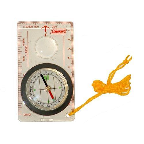

If your mast is 110% plumb/level you should be able to cover the 110 and 119, set the skew and elevation and leave them alone. Manually set your receiver to 3 LNB dish (not auto-select). Then aim the dish's azimuth according to the coordinates shown in the receivers setup menu with the aid of a heading compass (as shown attached) you don't need any fancy or expensive gear. If you are not getting signal immediately, back off a few degrees and mark that with a pencil (make a line that shows your starting point that lines up and you can come back to). Bump ever so slightly, allowing about 10 - 15 seconds for the signal to register. Keep going till you get a good read; about 90 or higher. Bolt it down. Check actual TV channels like the DirecTV free/info channels or CNN; they are on 101.
