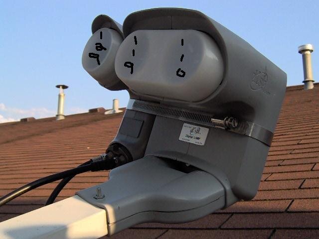

119 will be higher than 110...I know it sounds goofy but when you work with multiple LNB's they go opposite what they are in the sky....so in standing behind the dish the LEFT LNB (119) will be higher than the right one
see attached...here what my D500 looked like a while back....with homemade 129 setup when DIsh didnt even sell a D1000 yet ;)
That's pretty slick
